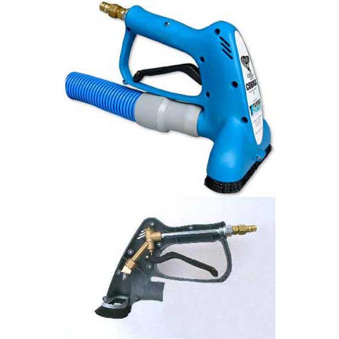

I own the Turbo, hand turbo, cobra, and Gecko with both narrow and wide attachments.....and after 10 years of cleaning tile I use the turbo and literally lift side of it up to get baseboard and edge. If need be in tight areas like the shitter I'll use the cobra. Other than that everything else stays in the truck....for past 6 years or so.

Yes and really all you have to do is scrub with a brush that will get in corners and under the baseboards, and then just tilt the tool and then let the vacuum pull the water back up. For toilets just scrub the area good with grout brush, flood the area with water, and then suck the water up with vac hose. If you want to go all out, wipe the area dry with a towel.

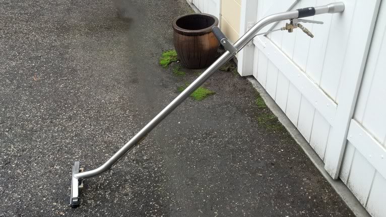

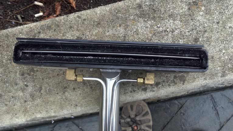

49,351
I got the PMF W159OSB. It is perfect for what I want. It is my magic grinder hand tool, except it is made into a full length wand.
Bought it from Joe.
49,351
They'd have to come down $100 off that price to match the one I got. Seriously! Plus, I was sorta joking about the shipping. UPS is slow this time of year though, but EVERY supplier suffers equally.
alazo1
Oct 8, 2006
2,567
San Jose, Ca.
Albert Lazo
That looks like the same wand I use for edging except for the brush attachment, jet and valve. I called pmf sometime ago to see if they sell the brush so that I can adopt it but they said they couldn't.
Let us know how it works.
