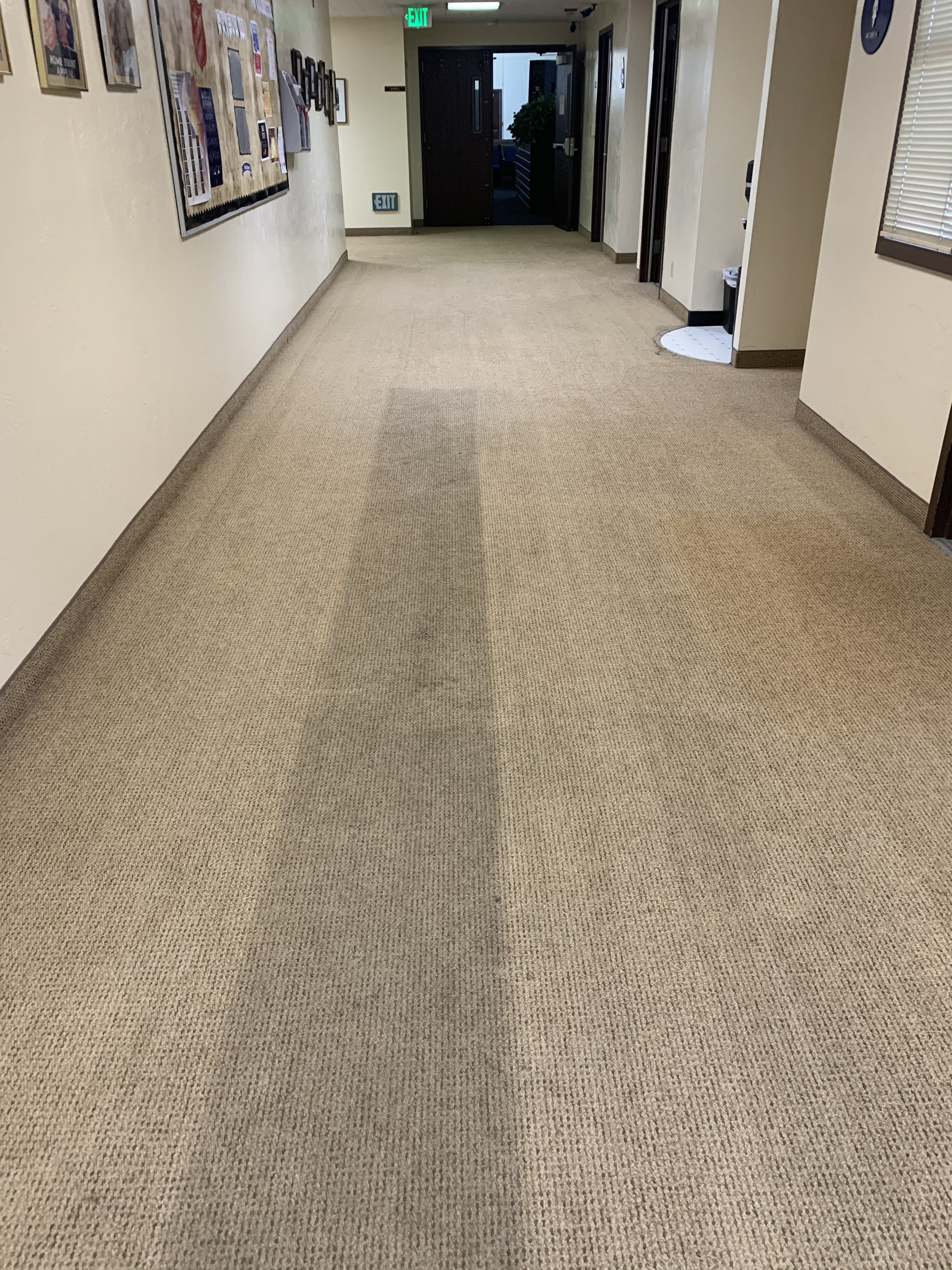

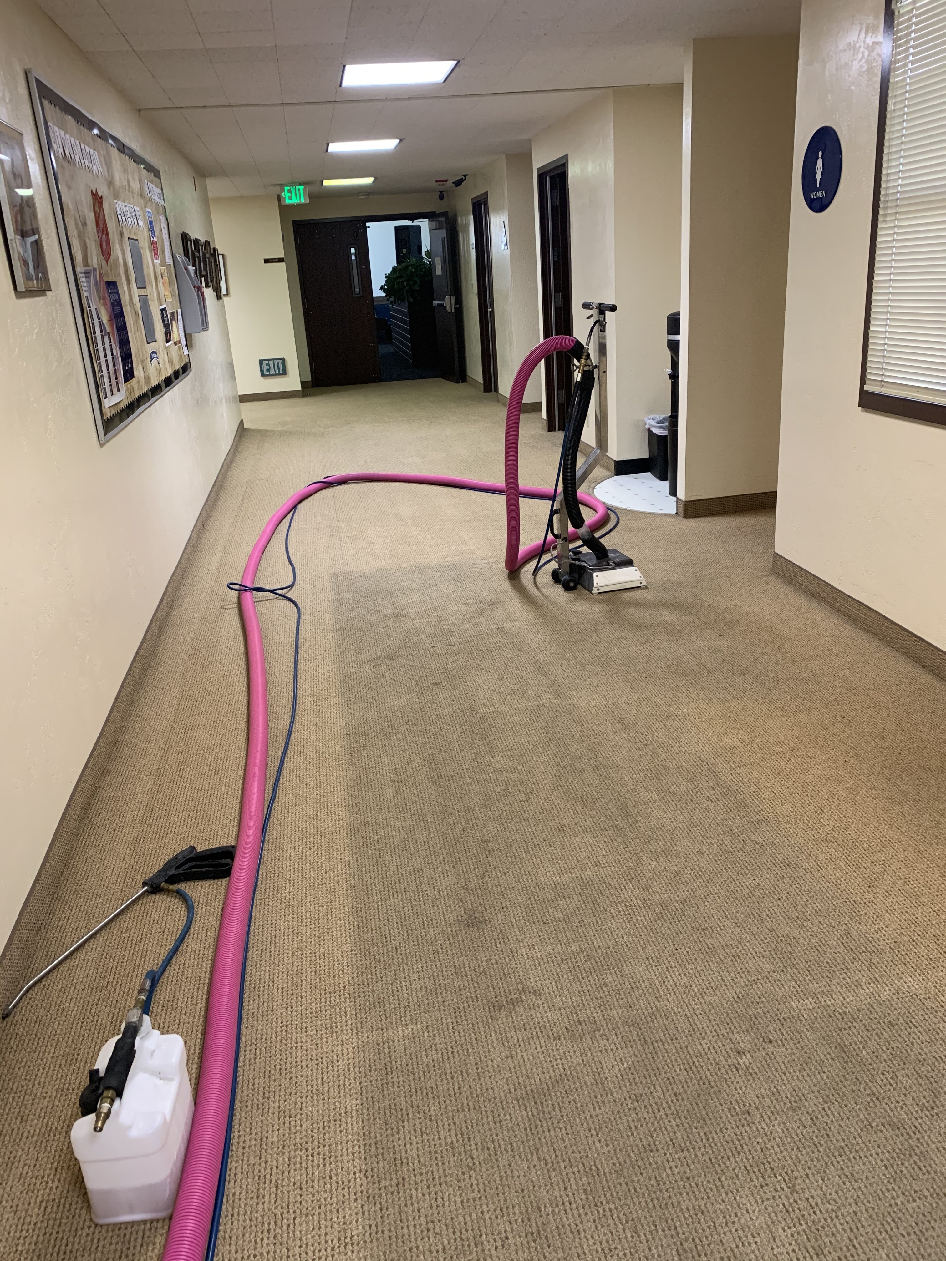

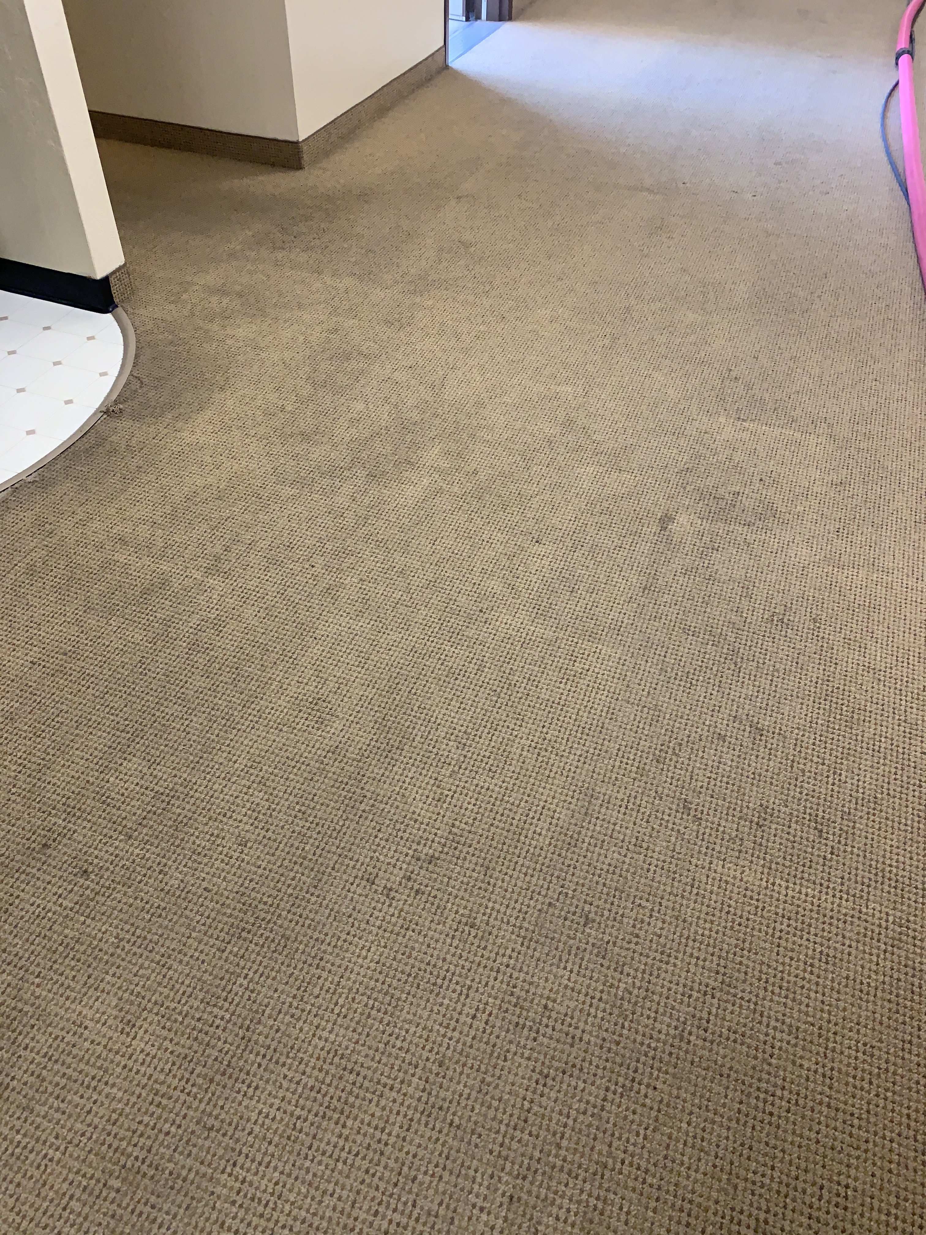

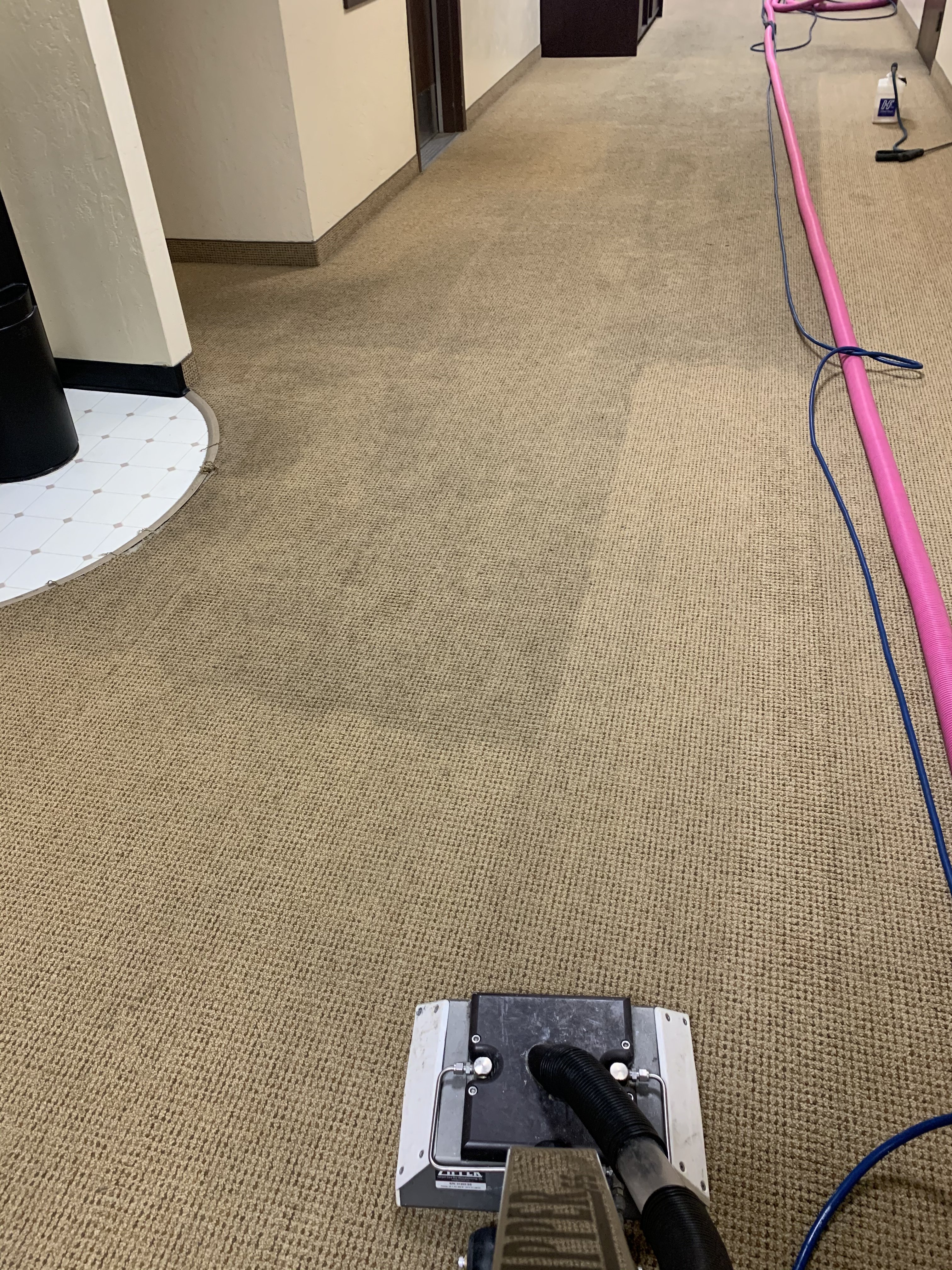

I quoted this account two weeks ago they scheduled at the beginning of the week for us to come out didn’t think much of it
When I arrived I found out that it was just cleaned by the competition and they were unhappy with the work
My price was considerably more and the other guy promised the world
To be fair the carpet was darker and there were some large spots that are gone but obviously there is a lot of room for improvement
This group owns 20 properties in the area
Will update with pictures as we go!
1E9EA260-AE80-42EC-BE89-496CBDC1BA09.jpeg F3C4270B-8269-4358-89E1-CB9D498414B0.jpeg 89E1A3D8-9CE5-4C02-A9C0-029F6B255BBB.jpeg
27,919
View attachment 102505 View attachment 102506 View attachment 102507

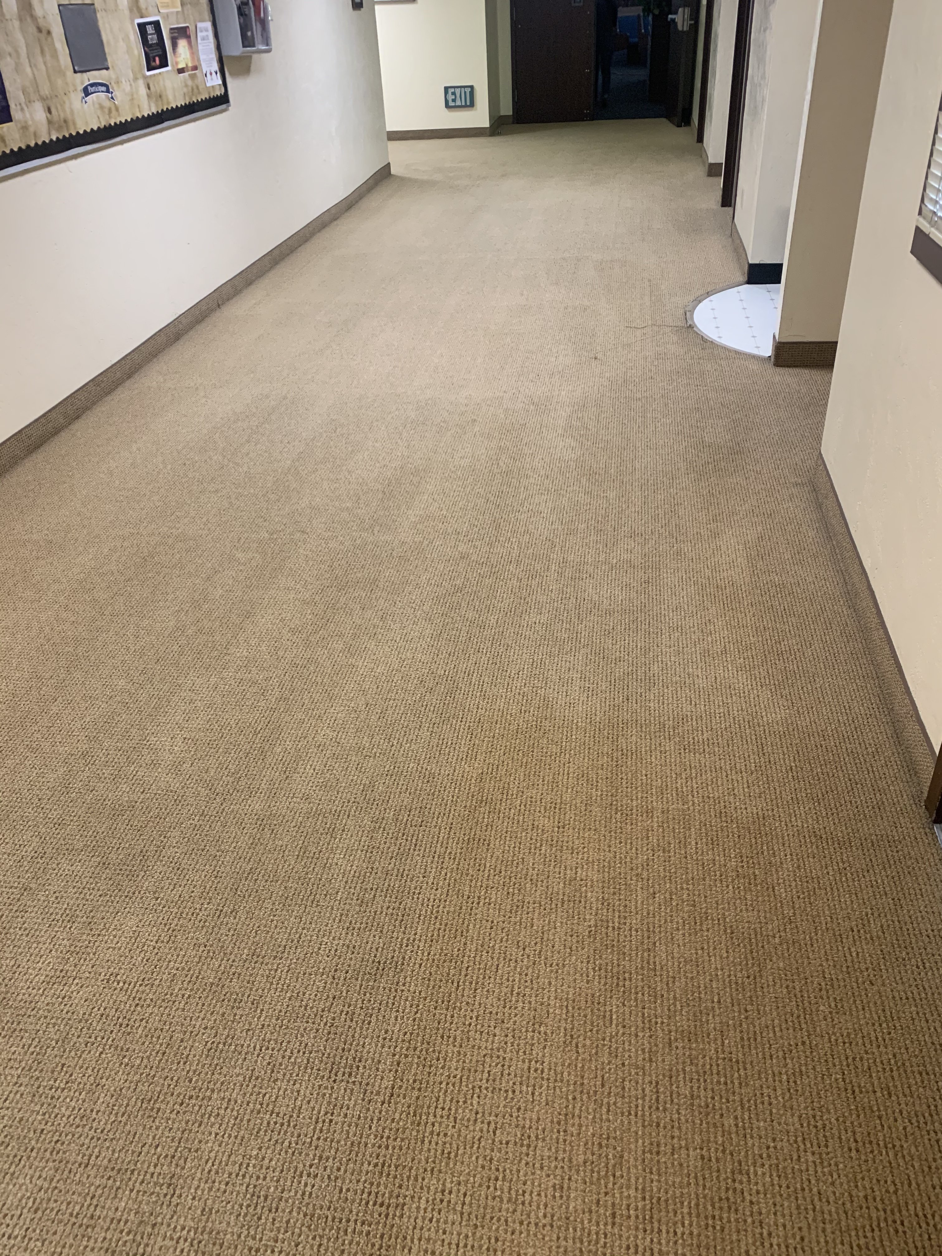

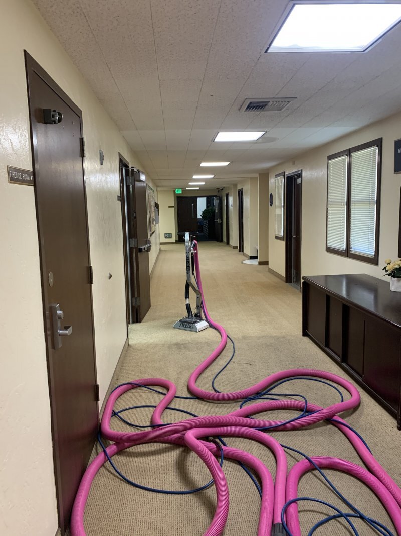

Honestly it’s better not 100
But better
They are blown away

Jay, It brightened up so much it looks like you re-lamped the light fixtures! The owner should name his next legitimate child Jay, out of gratitude.
Haha
No that’s me messing with my camera trying to not pick up all the weird shadows
It looked amazing but for some reason on my I phone it picks up weird stuff
