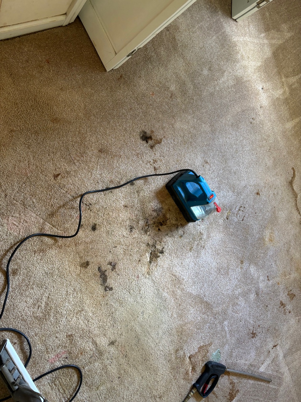

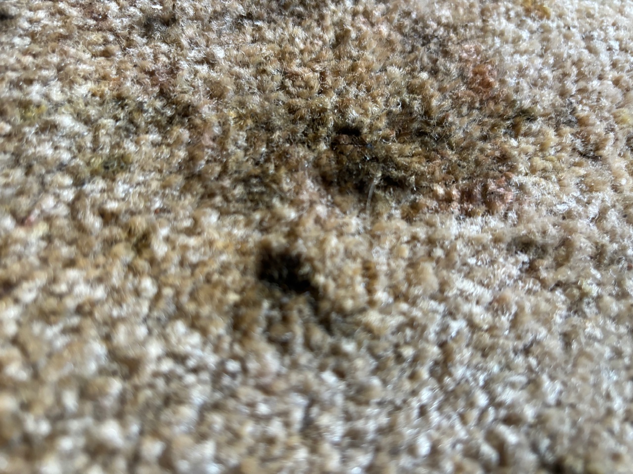

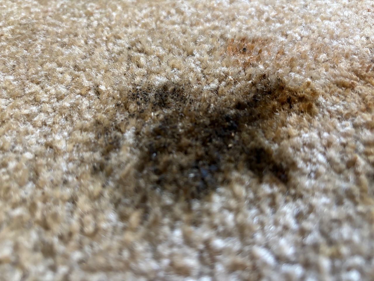

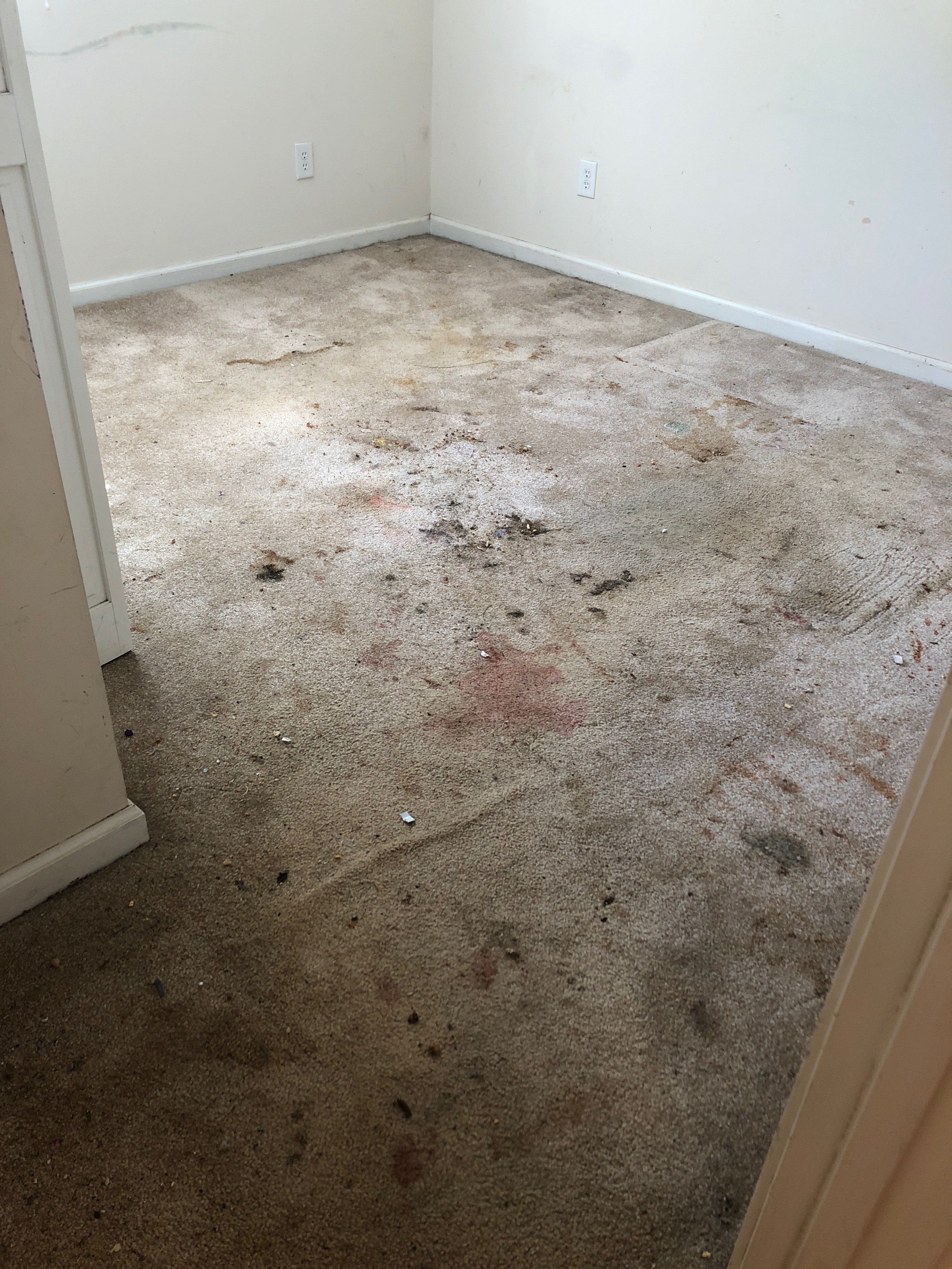

It’s not fecal blotches that the picture makes it look. It’s a combination of grease and chewbaccer. Mostly drink spills as well. I’ll have an after pic in a bit 🖕🏻

You'll never convince me there wasn't a litterbox in that room...

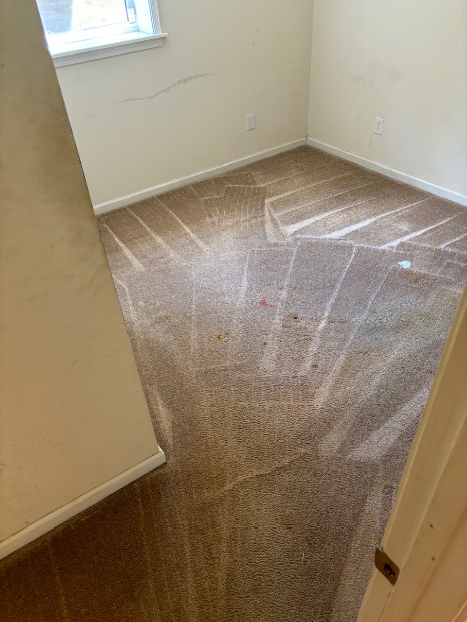

Now you’re calling me a liar which I don’t take lightly. There’s no evidence of a litter box in that room and the dark spot don’t smell like fecal matter
But to make your judgmental ass feel all bubbly inside🖕🏻, I offered to not charge them after I cleaned it because I told them it would come out more presentable than I expected since they’re selling the home
I cleaned a total of 9 areas of carpet and tile in this home and the seller was happy with my cleaning.
So hall-monitor Fred, did I do it better? Should I repent for my wicked evil ways of doing business?

View attachment 127352 View attachment 127353 View attachment 127354 View attachment 127355
Looks good.
Nice work man!!!

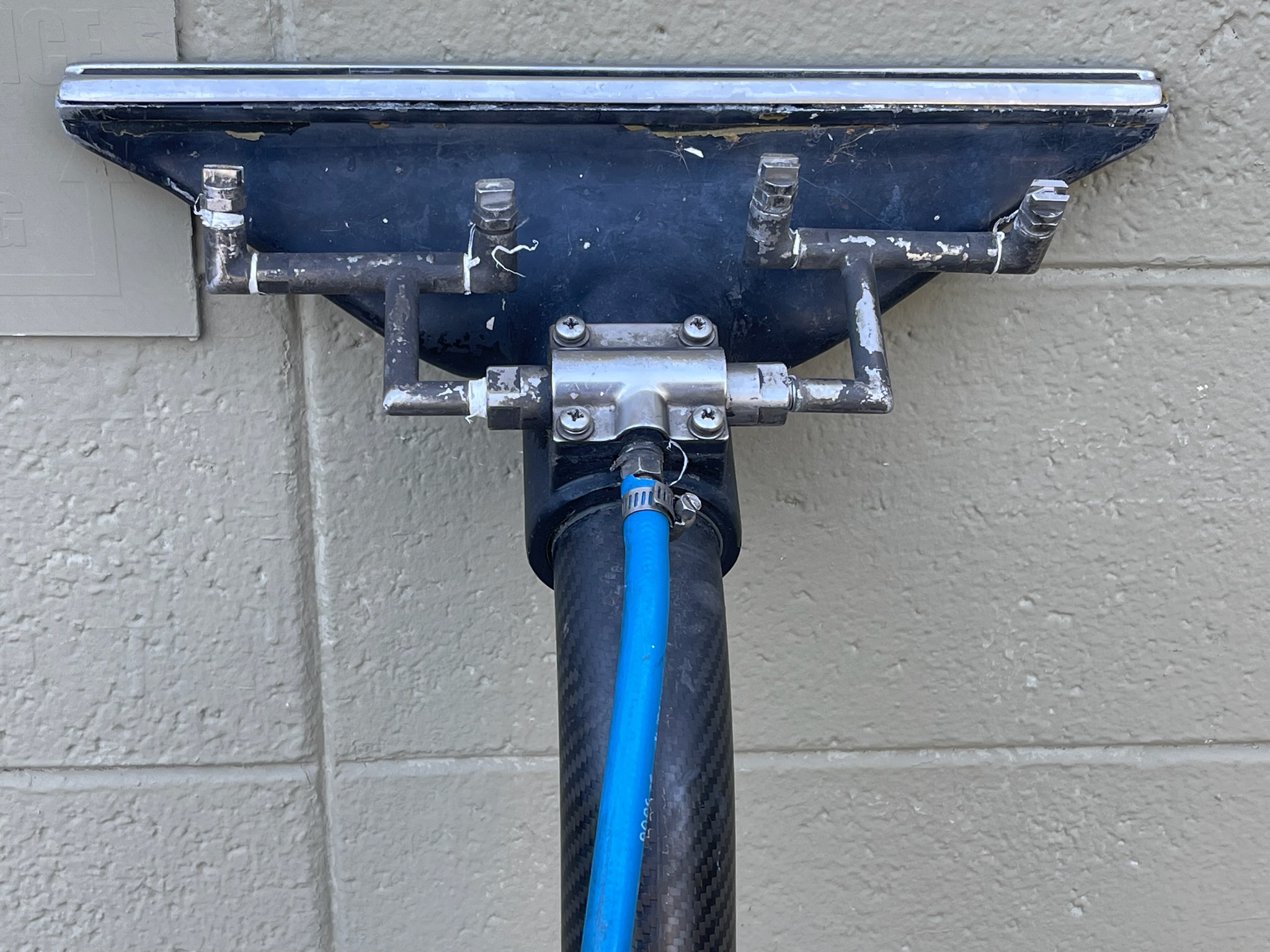

I'll have it on my site as soon as I have the new Glides for it.
29" Westpak S bend.
Flat Face Glide
Rejetted
Extender Benders
InLine strainer
Assist grip choice
$435 delivered.
Nice. Let me know when they are ready, I'll order one. Slowly I'm addressing the most ridiculous part of my operations one thing at a time. I want to relegate my hand tool that I've been cleaning stairs with to spotting asap 🙃
