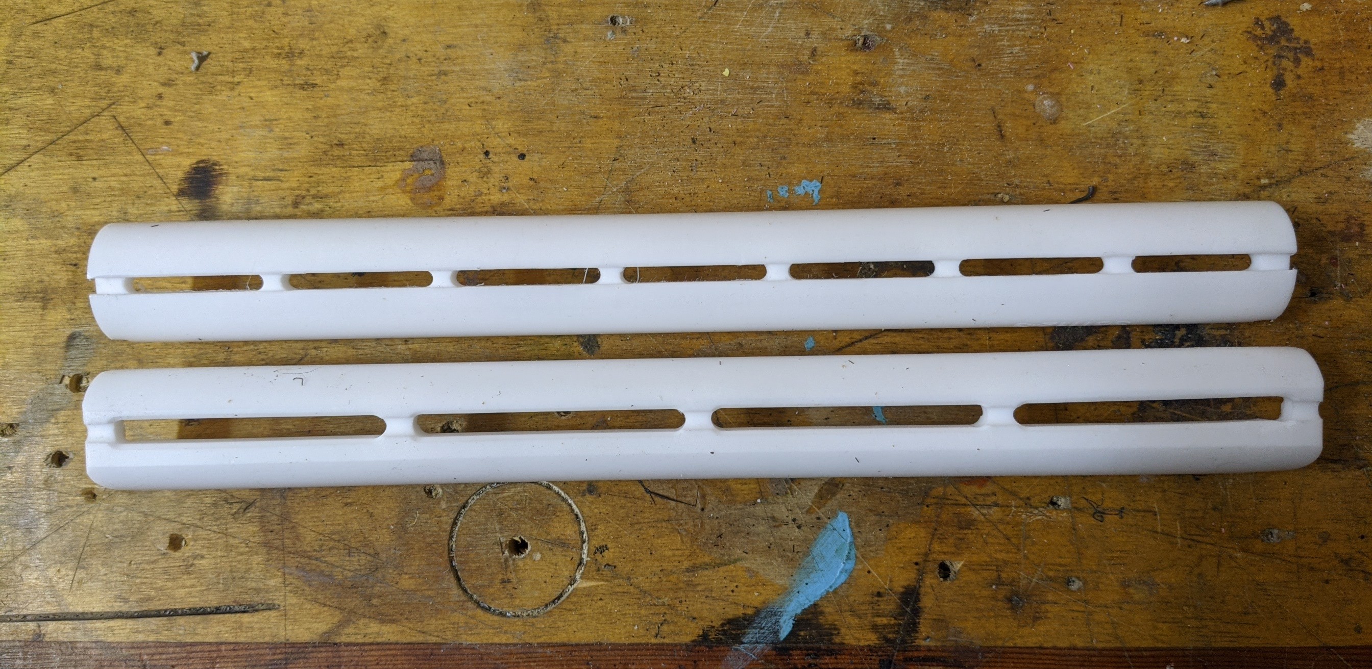

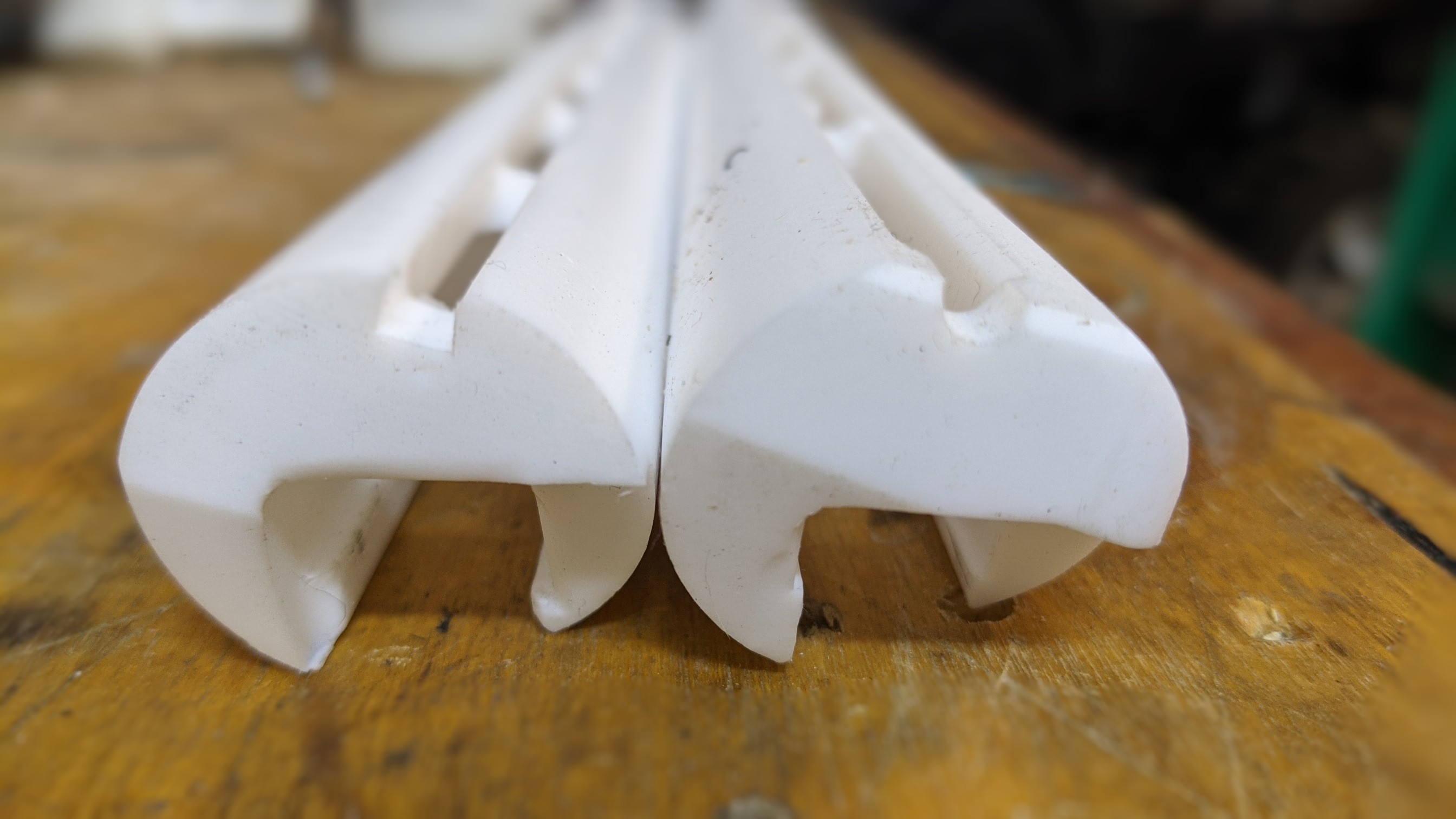

The Scientific Scalpel 12"
116,217
This wand is an experience unlike no other.
It honestly feels like there is no head attached.
Goes where you point, dig and cut like a caulk board pointer or a blind man's cane.
But damn if we aint having a hard to perfecting the glide for it.
We've sold many with only three complaints but you know me, I'm a bit of a perfectionist nut job when it come s to tools and toys.
Being that the heads are stamped and hand welded and use pressed on metal lips, there is more variance than our standard Teflon stock allows for.
3 possibilities, go up a size in the stock, which I'd like to avoid unless we can flatten the face al'a the Evo stairwand, go with an internal fit, which if we removed the pressed on lips COULD allow for some interesting possibilities, or we knock of the PM oem glide with a reduction to its overly wide vac slot are you paying attention damon?
Either outcome this ol'man wand is the cats meow.
