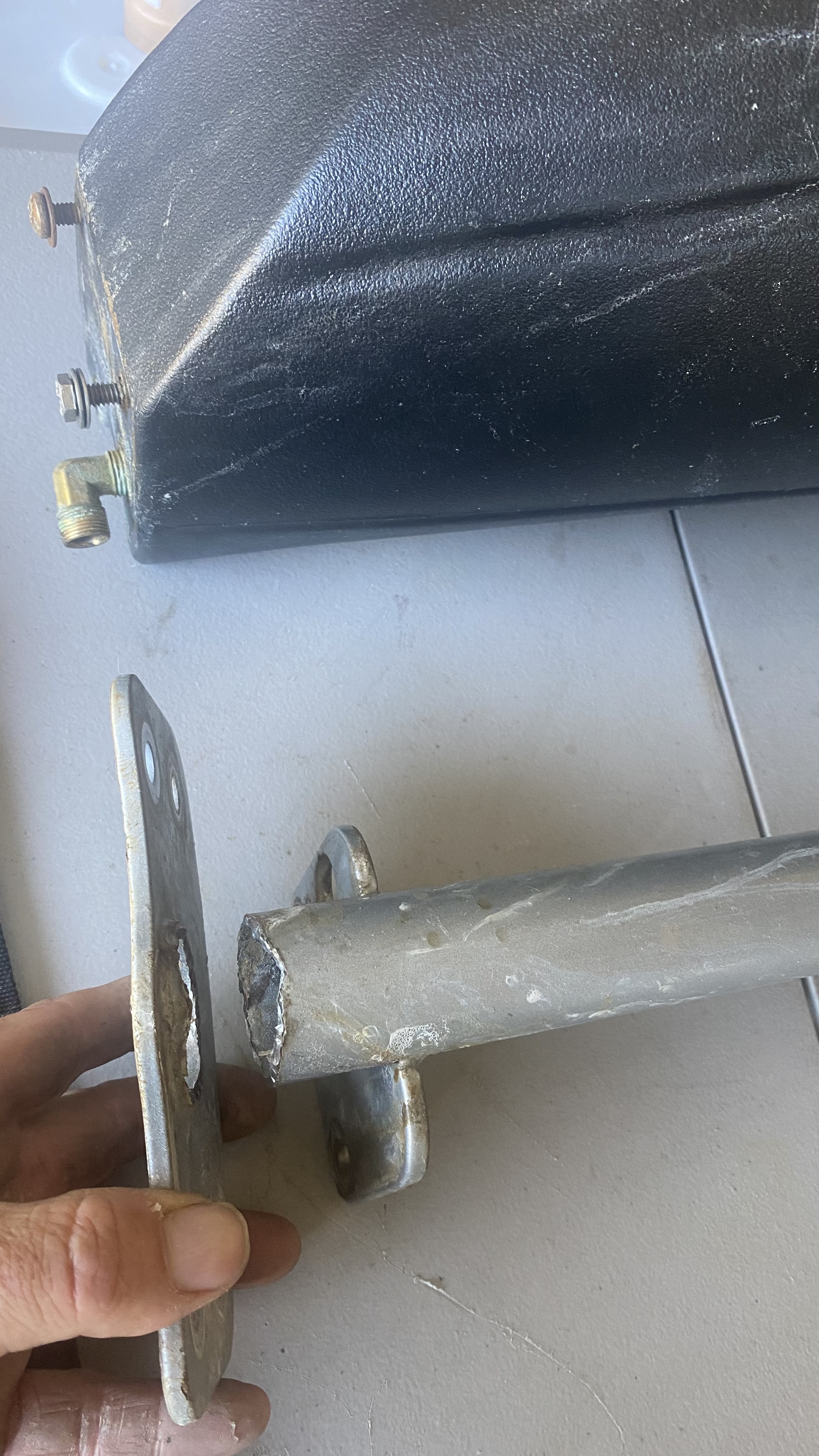

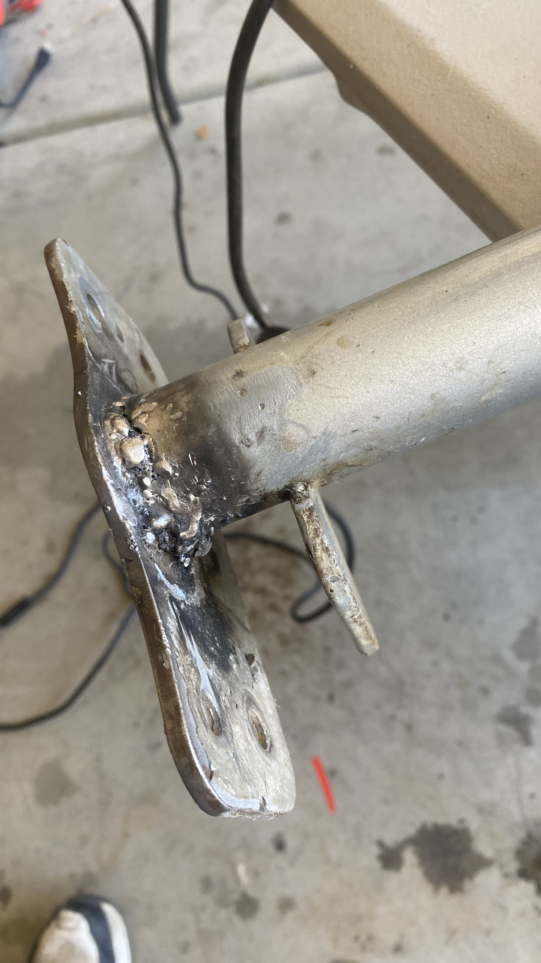

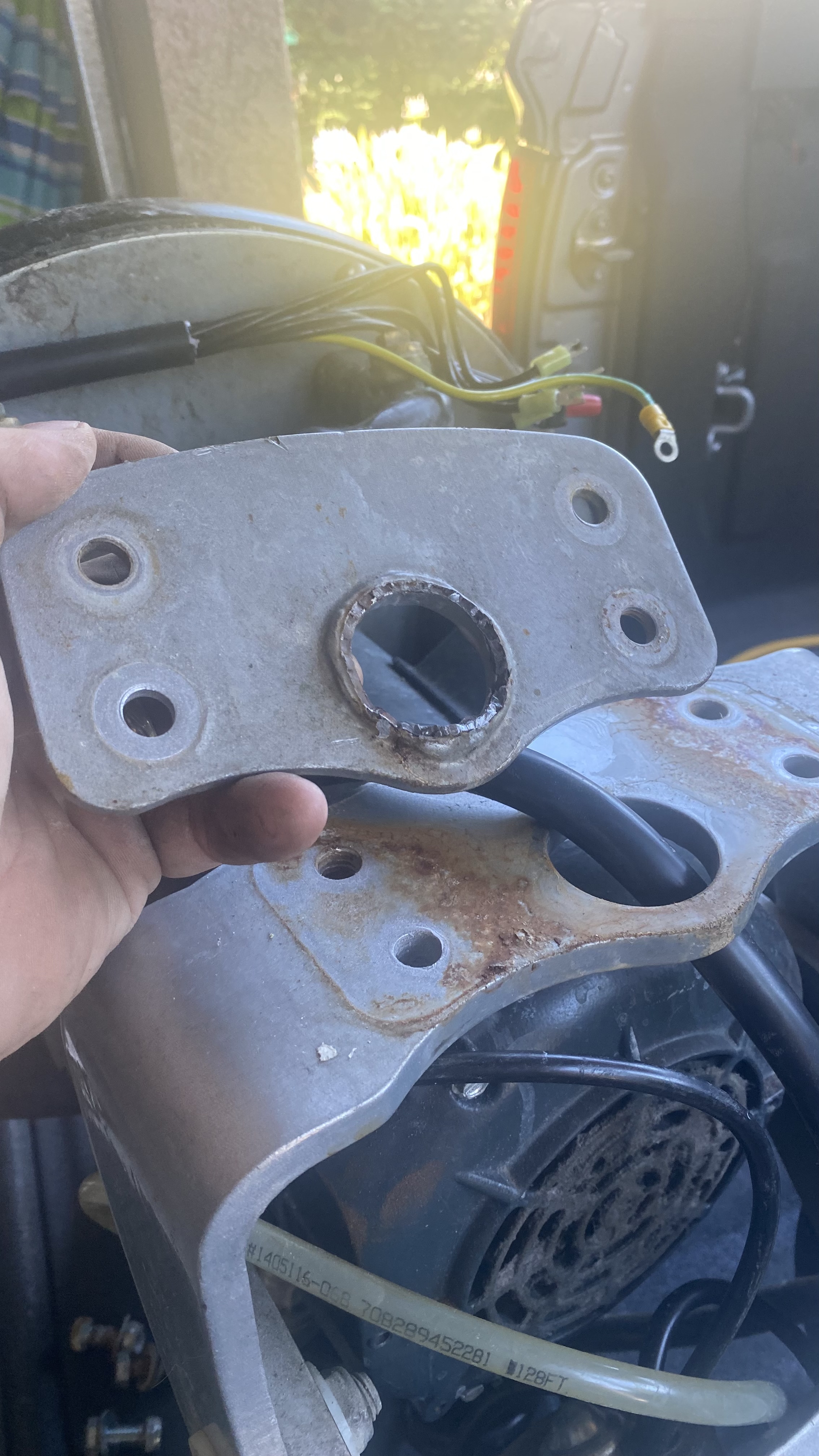

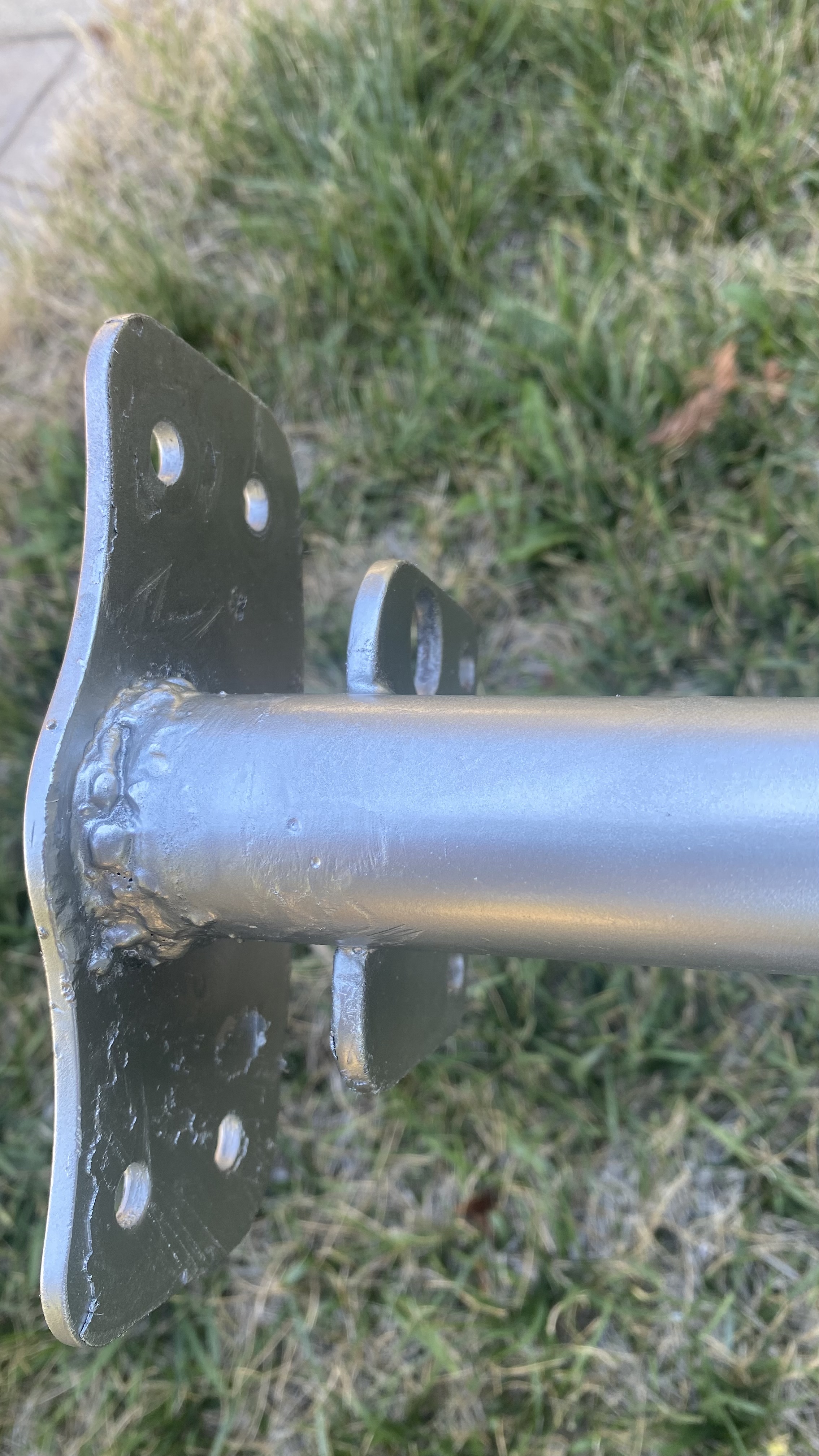

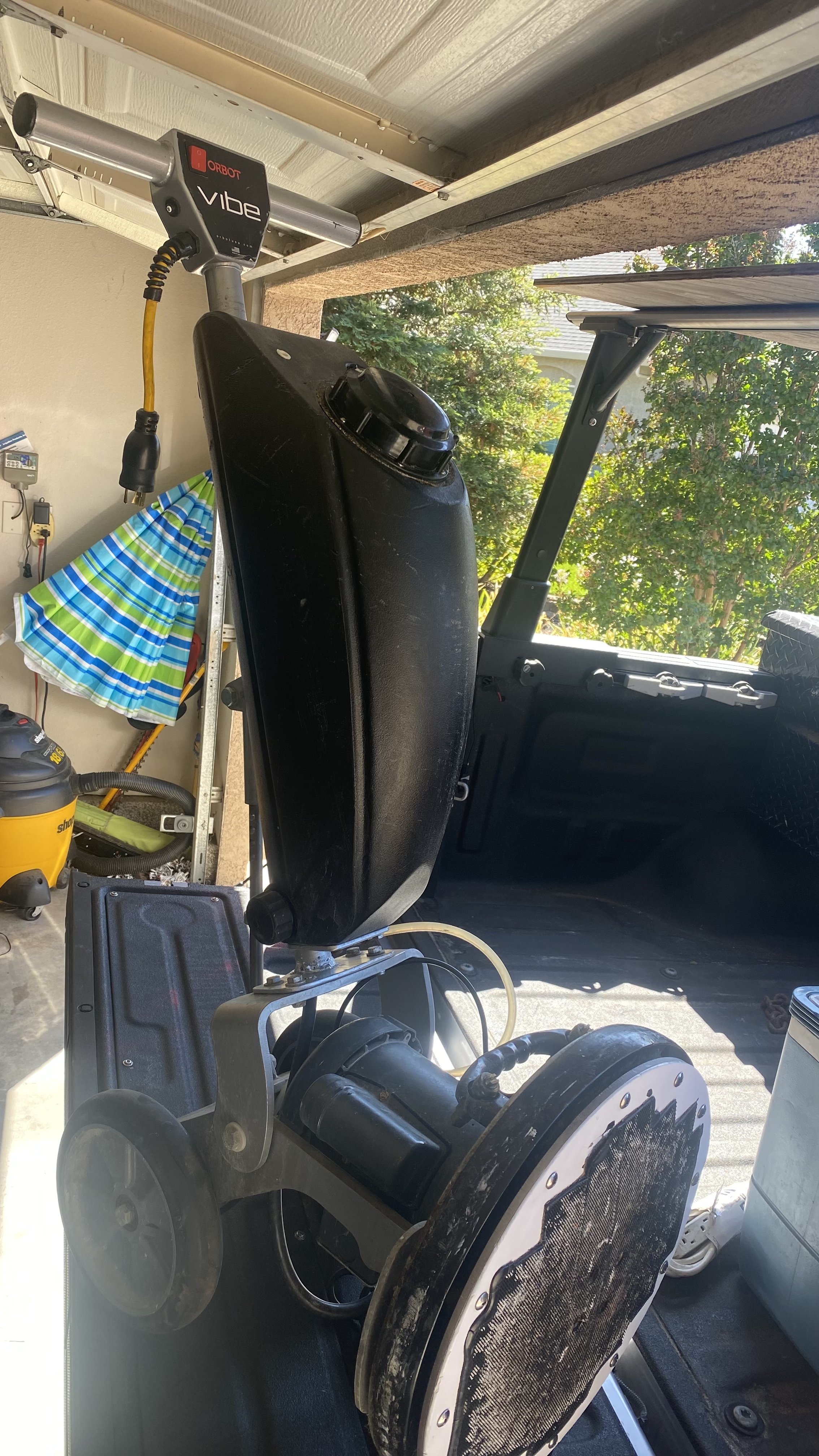

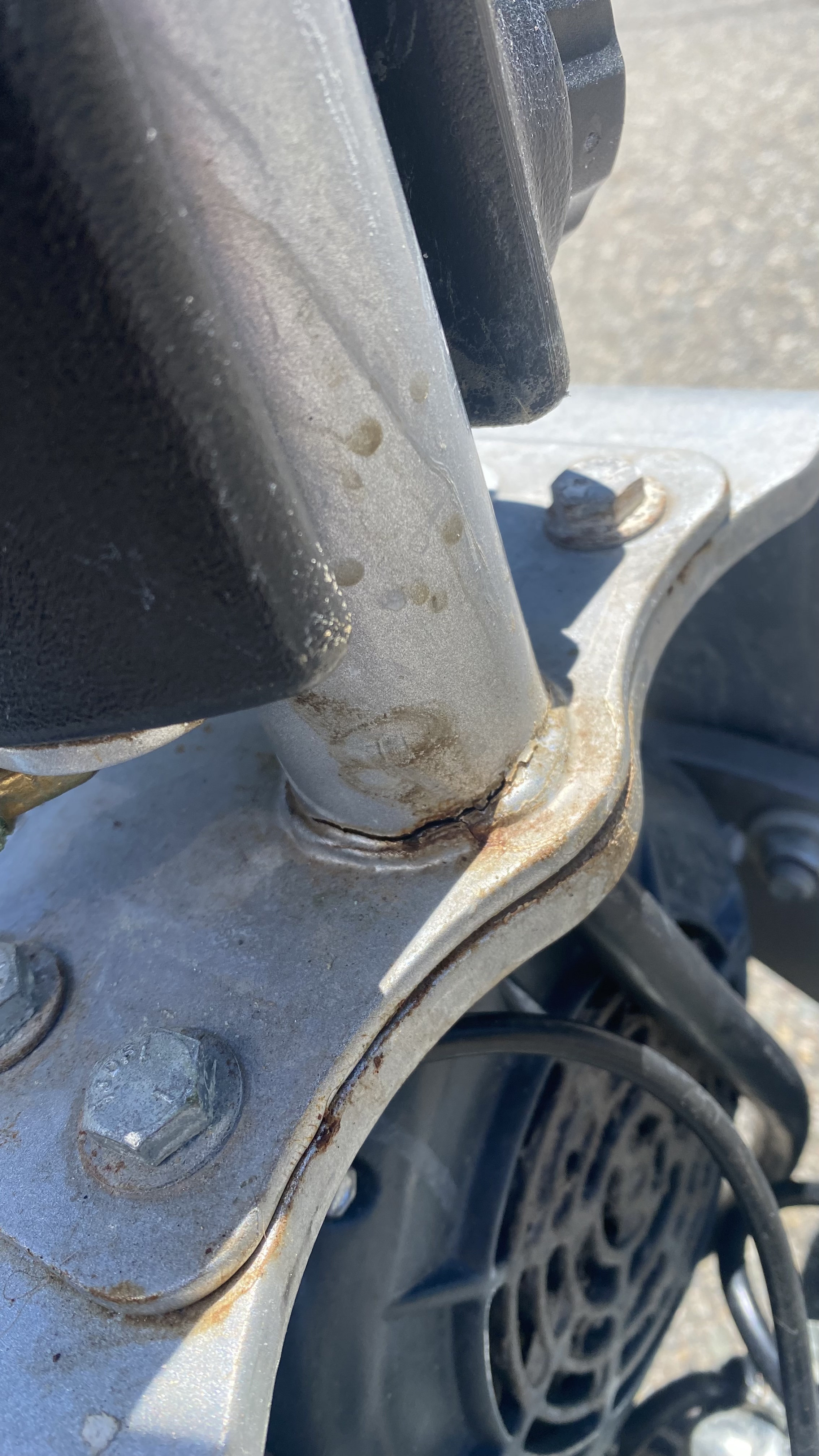

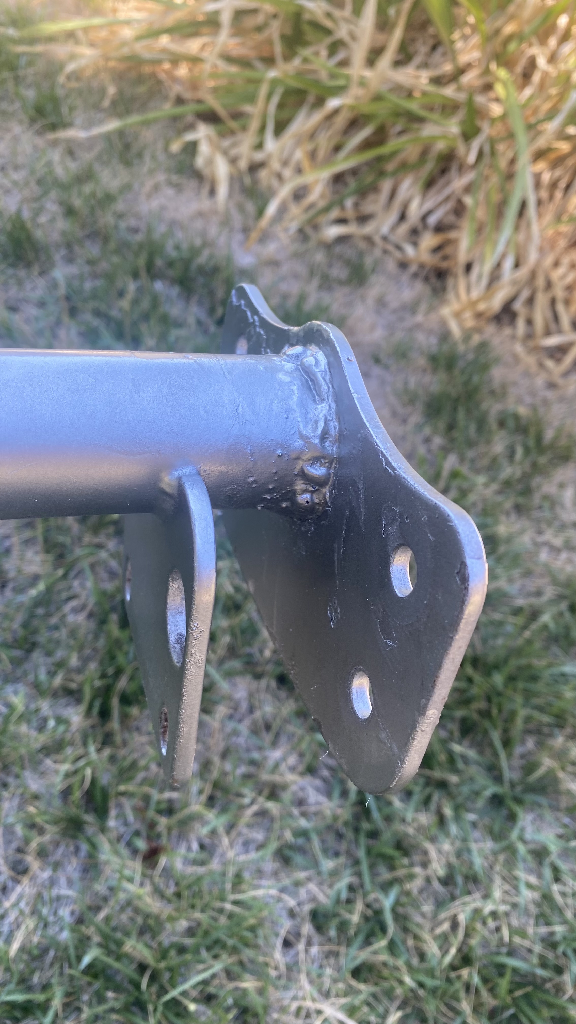

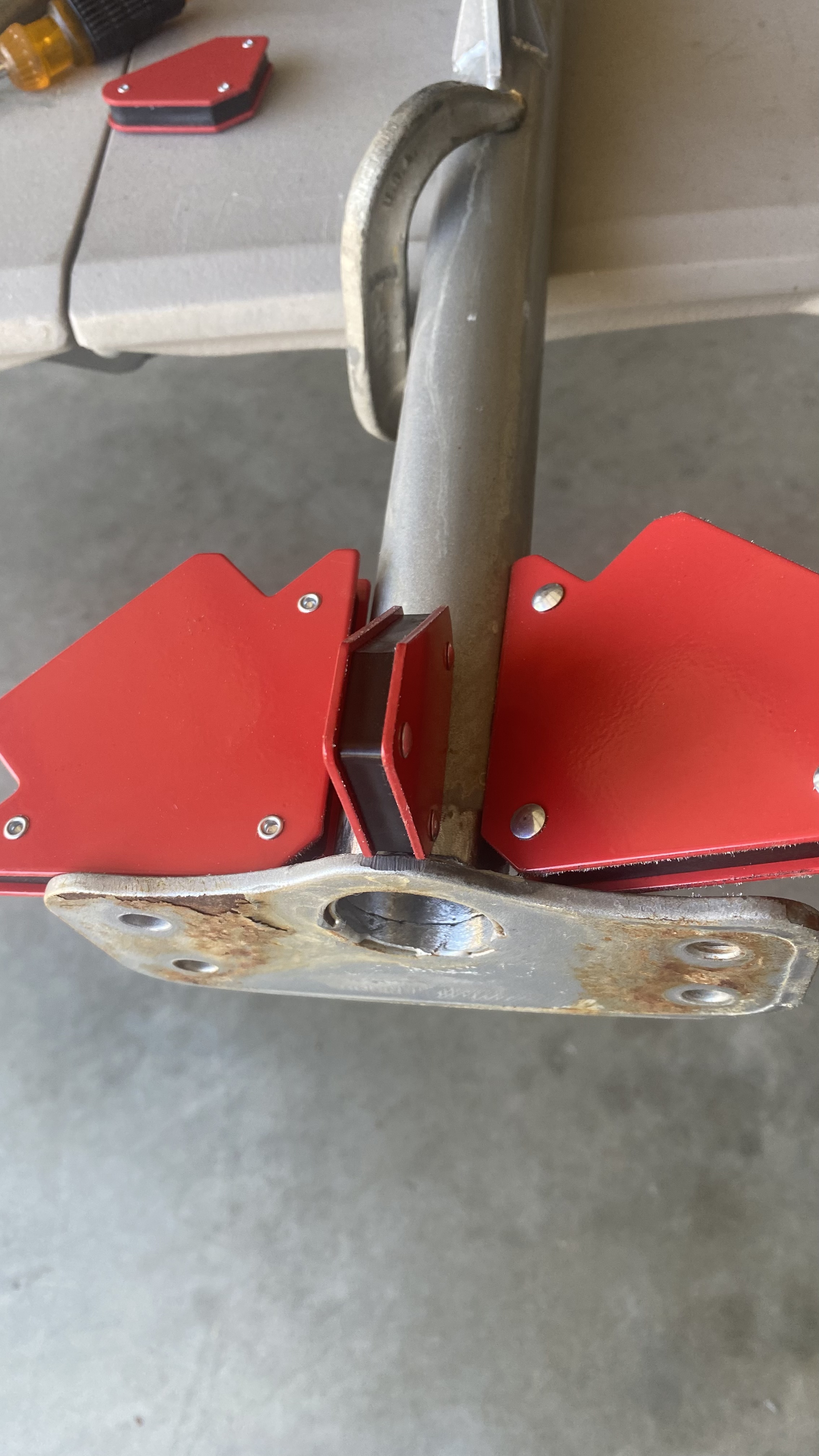

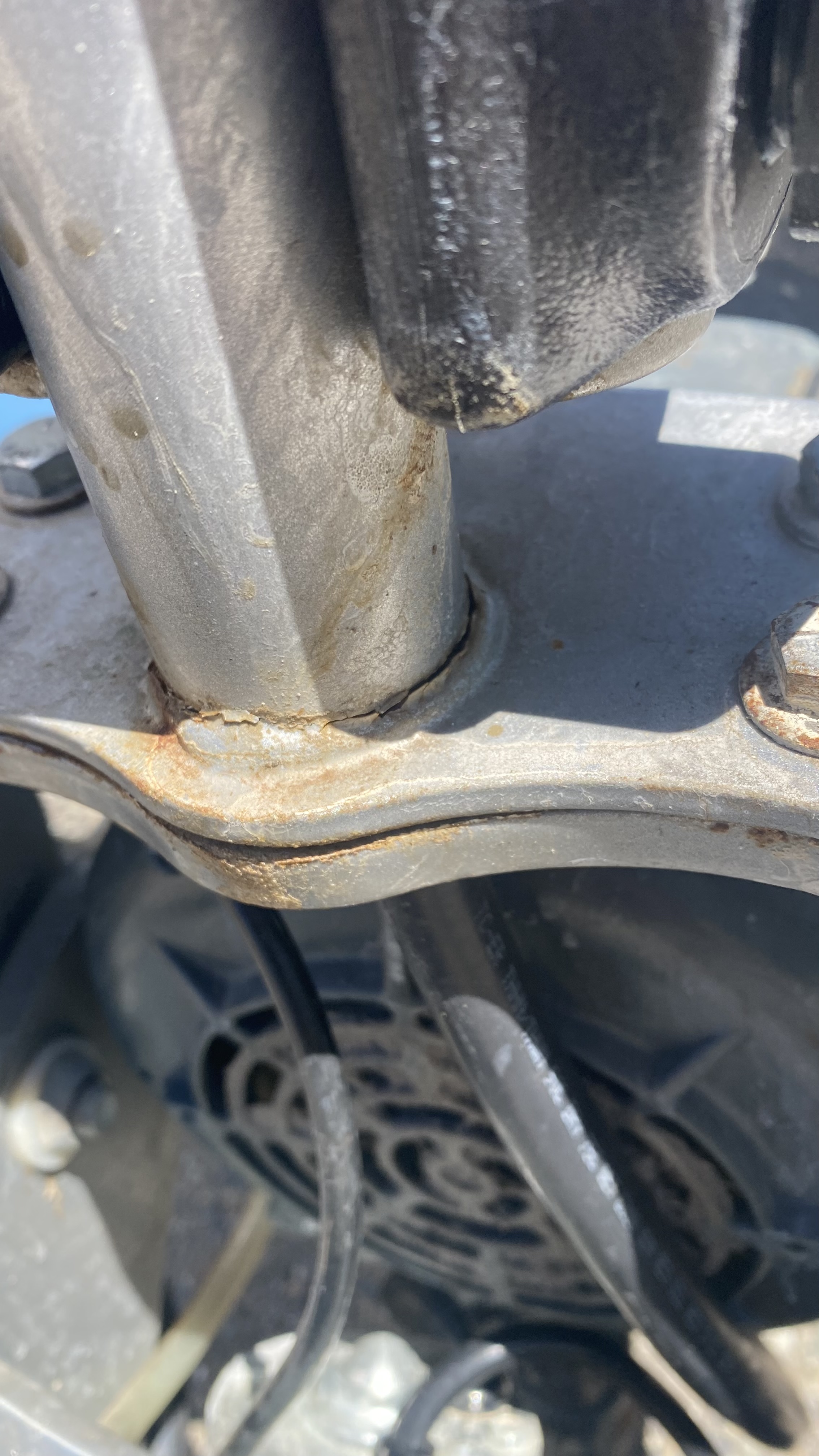

Last week the handle broke on my Vibe. It just snapped off in the middle of a job and was flopping around like a rag doll. I guess the years of riding around in my van jumping speed bumps took its toll.
Today I pulled her apart and welded her back together. It’s not pretty but it will work.

And Holy bird sh!t welds…..You sure you got penetration in the metal?!?
You’re a better man than me, trusting your own welds.. I don’t trust mines, I make my friends weld it.. :lol:
The welds are good. It took me a while to get the arc welder set on the right power setting. Just ugly as sin.
