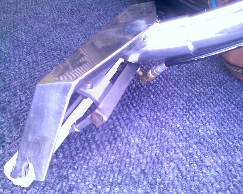

Just got to use the new wand again this afternoon. I just can't get over what a difference this thing makes on one pass only! We've been using a smaller overlap on strokes...Using over twice the flow as my old wand but still blowing steam. One thing I like about it is the jets closer to the carpet and the steam doesn't get a chance blow all over the room....Not quite so hot standing over the wand!
Greenie
6,820
JV since you have a HOT TM, you are now finally putting that heat to use, instead of bottling it up at the mount.
5 jets baby!
pretty comfy too.

Boy oh boy... And all this time, I thought I wuz talking high flow.
Well, it's some consolation that building "overkill" in the heat department, is a philosophy that's "ready" for more flow. I haven't tested my "Unleashed" systems with jet sizes larger than an effective 06. It will be interesting to see what happens when some of the owners of them do...
I do remember Paul Brown running a test on a "Hammer" I built back in 2000 or so, with a Rotovac. It delivered 265 degrees at 600 PSI, if memory serves.

Mikey/Greenie - can you please clarify where exactly the stream of water is striking? Is it hitting the glide or is it hitting the carpet just fractionally behind the glide? I don't understand how you get a shearing action if the stream is striking the glide first.
Cheers
116,232
Its 50/50....
or so.
If you use a multi jetted wand without a Glide, you'll get streaking on dirty carpets.
So..
You tweak the jets/manifolds up just enough to stop the streaking but still get a good rinse.
At 06 it works fine, at 012 it works killer!
