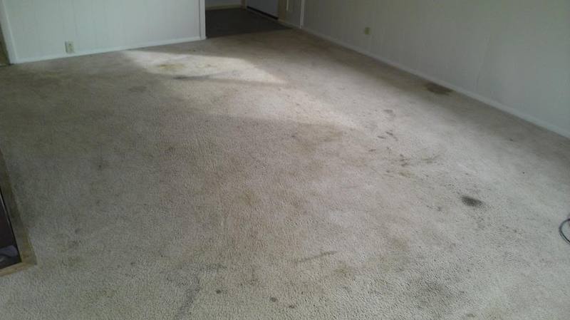

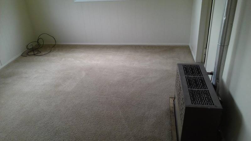

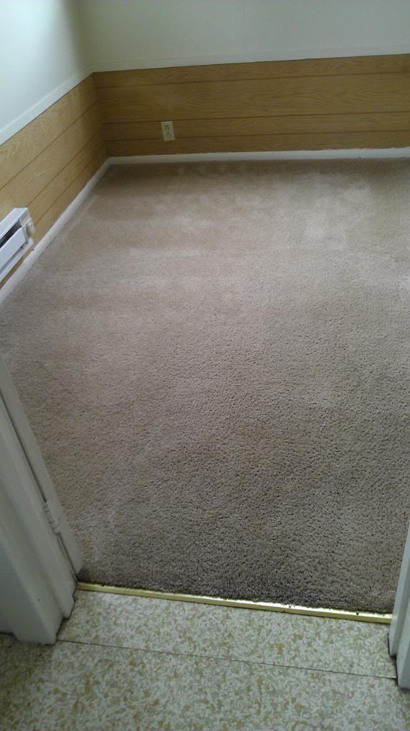

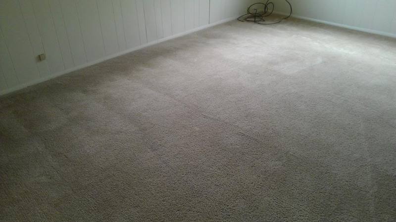

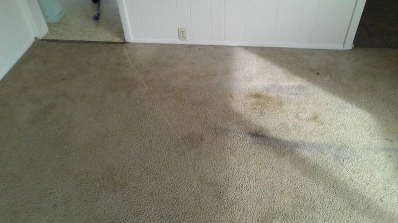

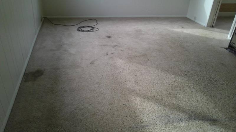

just used the S&G,,, edged w/ the wand then cleaned/dry passes with the Rx,,, then raked out right away,,, if not raked out right away,,then the swirls can be a problem,,,right before i get done with a room,,i go and prespray the next room,,finish the room im in,,then move the hoses/equipment,,then i rake,,during that time thats plenty of dwell time for the product to do its work.
thanks!
J
Jay_wat
btw,,i didnt use the teflon glides on the Rx,,,i wanted it go get the nasties,,and was willing to let the carpet be damp just a lil longer for a better cleaning in the end.
thanks!
I have done it several ways. It's a lot faster to just grab a wand and dry the carpet out versus drying with the rotary which doesn't dry as good and then raking. You will leave the carpet cleaner and drier. Try it and see because the rotary will still leave some lint and stuff behind that the wand will pick up and get the swirl marks out.
