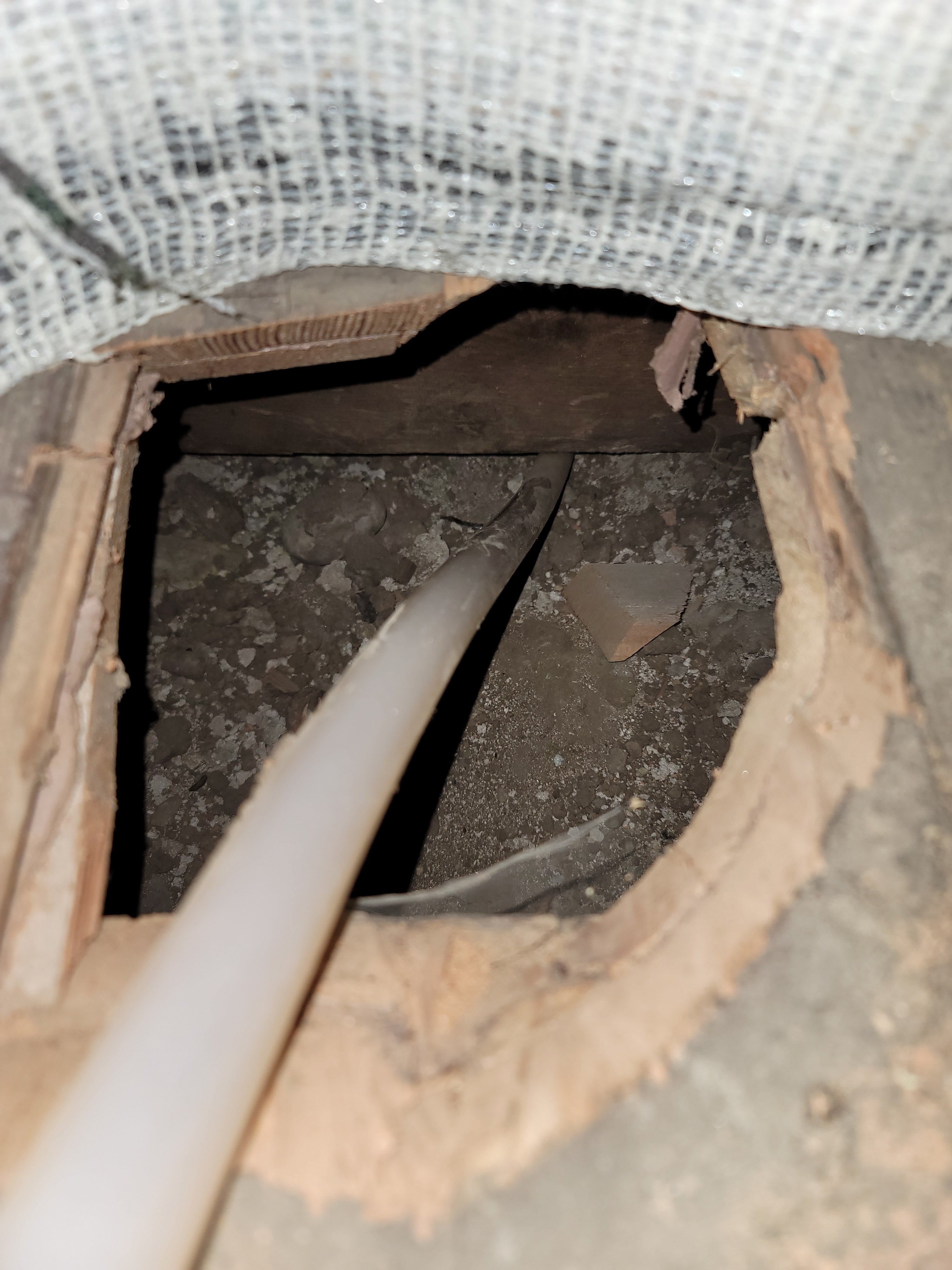

I think our main water line is frozen at our office where it comes in from outside. Has anyone used their TM to thaw out a water line by shoving a smaller line into the water line and blasting it with hot water?
if there's a casing around the incoming water line you can get hot water into, yeppers hot water will work
if no casing, use a heat gun.
edit to ask.
city water w/meter or well and pump?
City water. The incoming water line appears to be pex.
if it's coming straight up out of a casing you can see, pour scalding hot water down the casing.
is the shut off valve before meter operable?
if so, you can disconnect the meter to verify if freeze is upstream or downstream of meter

It's just coming straight out of the ground with no casing from what I can tell. Looks like whoever plumbed it did a shitty job. I'll try and take a picture and show you how it looks.

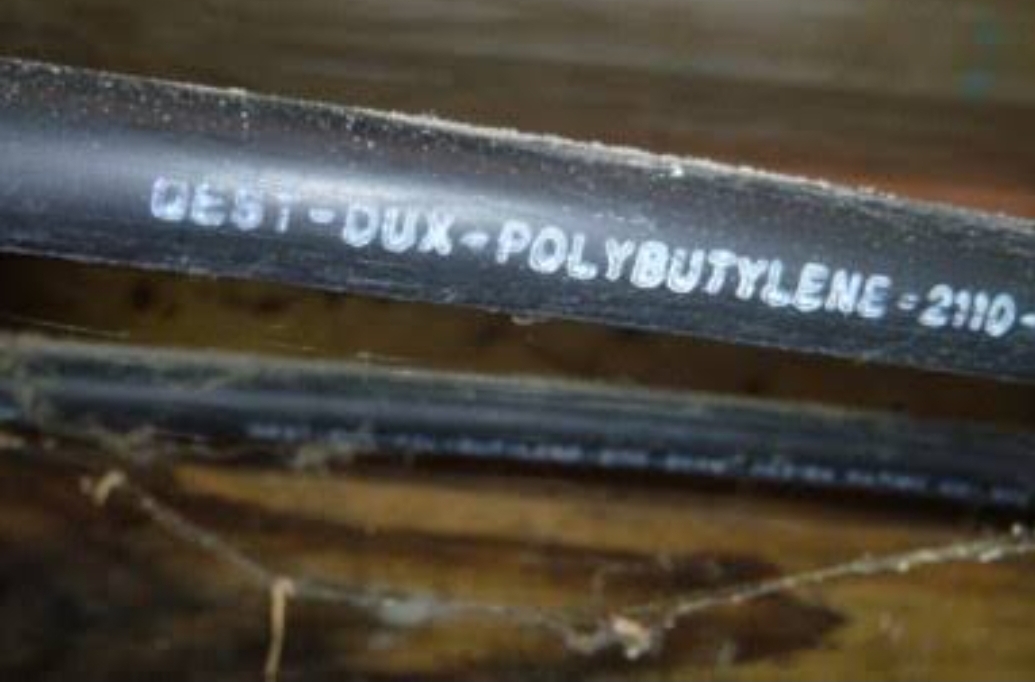

old gray polybutylene
there was a YUGE class action settlement over that crap in the early 90's(?)
One of our accounts owned a dozen new condos plumbed with it.
Right from the get-go they had pipe bursts.
Everyone on the street of the first phase (40 units) were popping pipes
The second and third phase 40+40 units got copper
we were out there a couple times a month to fix broken pipes and dry carpets til they replaced all the plumbing
Oct 25, 2016
3,150
Montana
Swani
@sOOper hero
  • Sad
Reactions: FB19087

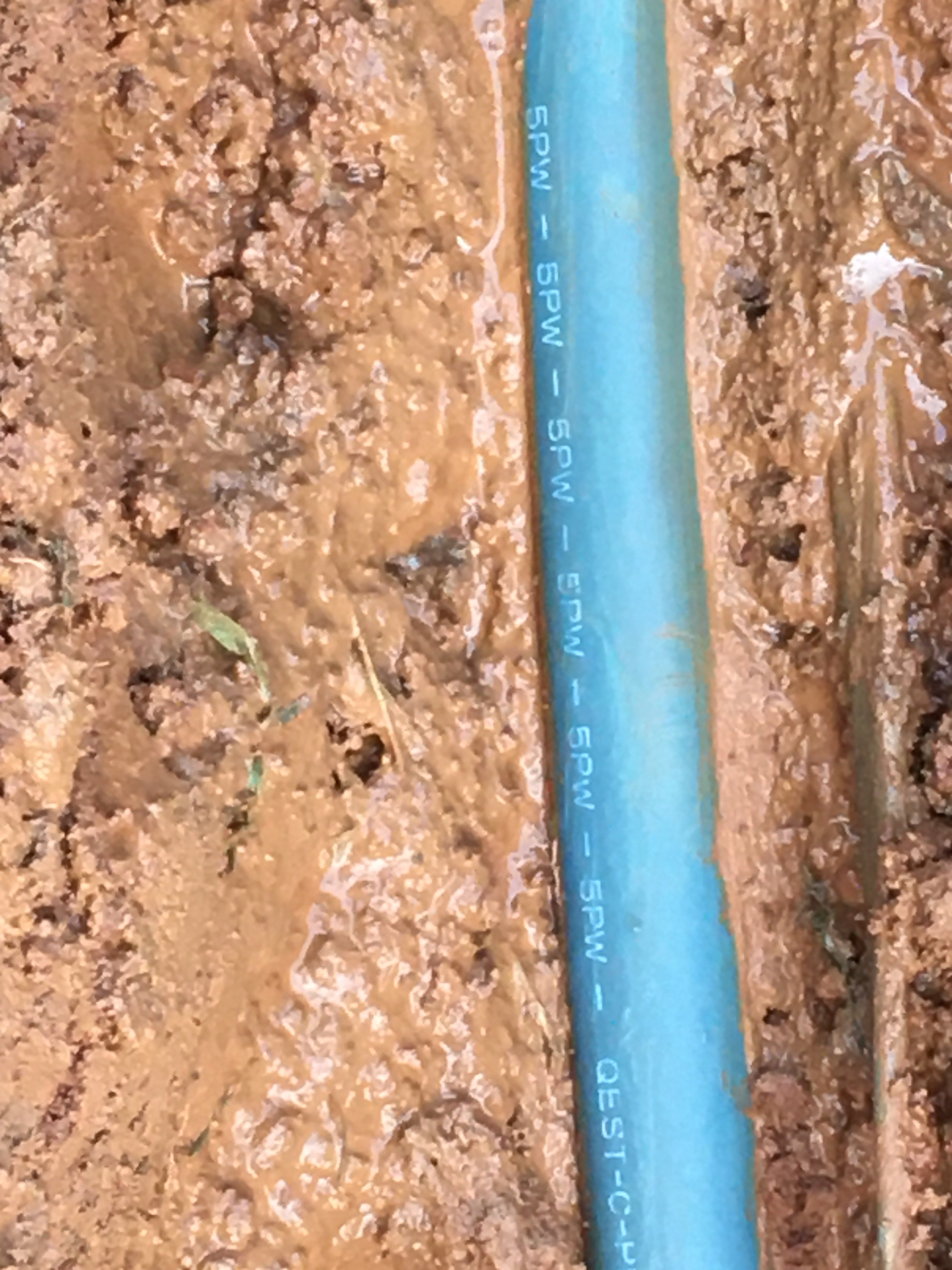

What is Qest pipe?
Polybutylene (PB) was a plastic manufactured between 1978 and mid-1995 for use as piping in home plumbing systems. ... Pipes made from polybutylene were installed in up to 10 million homes in the Unites States during that period.
lta
14,102
What is Qest pipe?
lta
I was told that was pex. Maybe I was wrong
