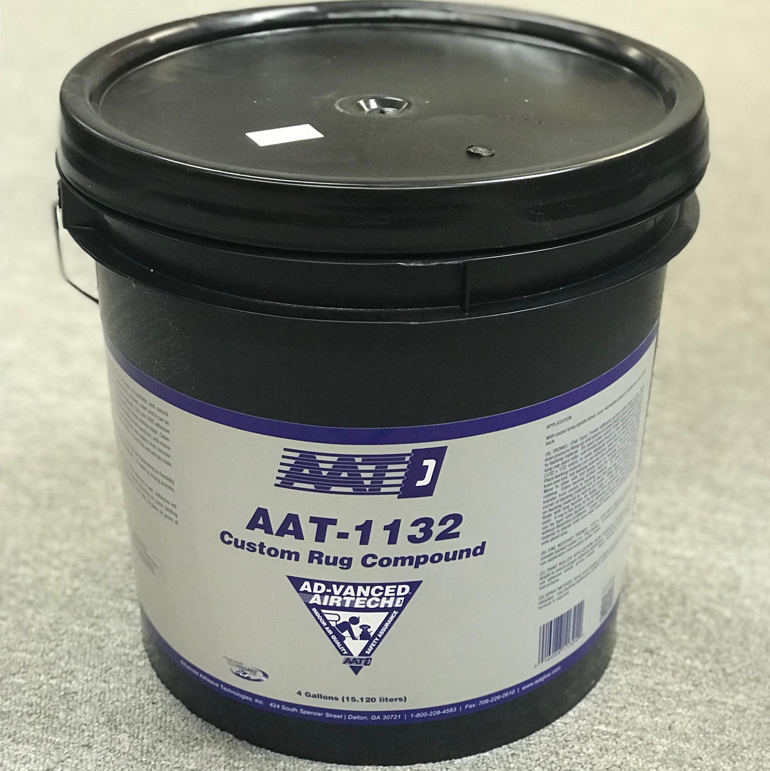

Hello there again,
I've been doing some deeper research for the liquid latex I'm going to use. From what I can conclude, Bond Products' AAT -1132 is the best in the industry. Here's a link
The only downside is the shipping cost is over half the product cost.
An alternative I see gaining popularity is Tufting Nation's TN-100 rug adhesive. It's made out of natural latex, as opposed to the synthetic latex that the AAT-1132 is composed of. Again, my main concern is the longevity of my rugs. In your experience, which type of latex performs better, natural or synthetic? Is there a high-quality latex brand you tend to favor over others?

The Bond product sounds pretty good with a 6 our cure time and drying white. You might try searching for carpet installation suppliers close to you, or search for latex edge sealer to find more choices.
We're currently using Taylor 710, partly because we can get it from a local supplier. Our purpose is primarily for edge sealing prep before other treatments, so cost isn't much of a factor. It dries amber and slightly tacky, so might not be what you want.

9,765
AAT1132 is a premium product.. I can’t get it locally and finding someone to ship it isn’t fun..
We do use seam-sealer to re-secure tufted binding bands on the back edges.. We use Parabond 267 I believe for re-latexing rugs..

I took the plunge and purchased the AAT1132. Should get to me by next week. But I also want to test other options so I will be looking into the edge/seam sealer products also. I consider these next few months my trial and error testing phase. Thank you both very much for your insight 🙏

AAT-1132 works well; it's kind of like Elmer's glue when dry stiff and cracks if folded; Roberts 6700 is another option some use. Latex-based adhesives like Parabond 267 provide more flexibility but dry out and break down quicker....IMO
In terms of longevity, consider the quality of the carpet fiber and the Denier (density of the tufting ). The denser the tufting to an extent, the more resilient a rug is to food traffic. Most of the craft wool yarn available in the USA isn't "carpet grade" it's a craft grade in the 20- 25-micrometer range; a suitable carpet fiber thickness above the 30+micrometer range and provides more resiliency, and there are not a lot of commercial options in that range Navajo Churro is around 35. I can put you in contact with a wool broker that specializes in Churro yarn if you like.
