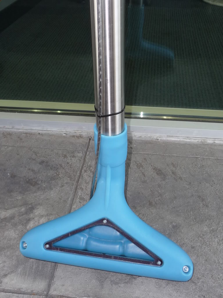

The ball valve looks "ok", but to be honest, it's just not that much work to squeeze a FeatherTouch, and I could get rid of that ridiculous armadilo housing and make it look like a "wand" again.
I'm just not a fan of that much plastic on a wand, Stainless last.
Mikey mentioned it, I will EMPHASIZE it: The Delrin will snag carpet fibers and require regular resurfacing (read as sandpaper)...ask me how I know?

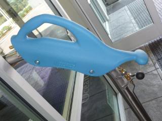

1. The handle - For years people have known that carpel tunnel/repetitive motion injuries are a problem in the industry. This handle is designed specifically to improve the angle of your wrist and focus the forward and back motion to the larger joints in your shoulder and elbow. The option most commonly offered to the industry has been mounting a spray gun on the wand as a solution to this real problem. Our goal was to actually build a handle system specific for the application rather than attempt to adapt something and make it work. The forward handle both protects the ball valve as welll as allows you to use this a scrub wand. Finally while its tempting I'm sure to think that this was designed by engineers who have never used a wand in their lives. I suspect Roy Studebaker has more years on a cleaning wand than damn near anyone on this board and he and Keith both have had a tremendous amount of say in the features we offer in the Stryker. All that being said if you want a conventional version we will offer one.
2. Plastic and durability I hate to rain on anyones pararde here but the durability of Polyethylene is pretty hard to dispute. while stainless obviously will last it still dents like any other metal and of course the cost to cast or mold it is quite expensive from a per parts price. The reason I bring this up was important as well in our decision to use one of our molding processes. Our original prototypes were welded stainless as many know from the video's posted on this forum. During the development phase we all noticed how water cavitated in the corners of the wand head. All of us found this to be interesting at a minimum since it seemed to indicate that the water wasn't moving equaly up the wand into the tube hose etc. Well at Dri-Eaz we knew form years of extraction testing that the water that is extracted into any wand device actually travels along the surfaces not into the air stream (hint the air moves to 100% humidity immediately giving it no ability to hold water) so the smoothness of the surfaces and rounding the joints rather than blunt welds is very important to effective water extraction. (could this be why 2.5 inch hose works better or multiple aperatures make a difference? thats a whole nother class folks)
3. Delrin versus Teflon, Come on Greenie we don't have to argue this one do we? Who made the glides for our Rover? Of course teflon is the best material but only if the manufacturing process utilizes machining to create the glide. In an effort to keep costs down and add features that could only coming from injection molding we choose Delrin which is a damn good alternative.

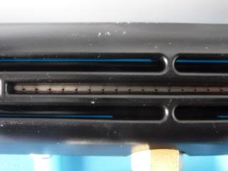

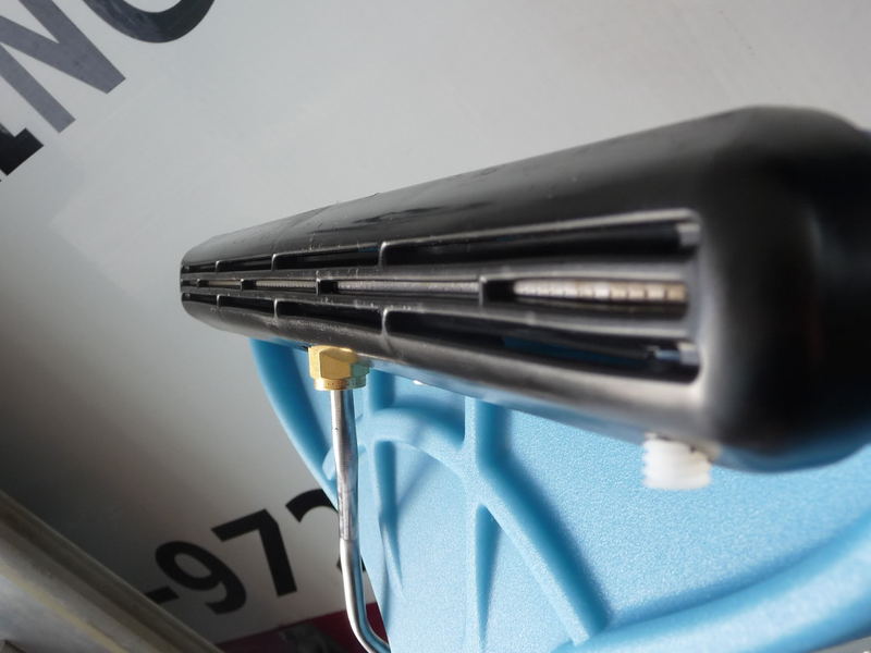

Dosn't need to be Rich.
The spray bar manifold is filling a cavity with hot pressurized water. You could plug up 1/3rd of the whole and it would still work.
