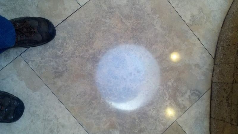

Here is before an after. The floor was diamond refinished, then polished with 5x. No grout scrubbing, no cleaner, just 5x with a white pad. Notice the grout looks new. The couple dark lines were just still wet, they dried out like the others.

Cameron I can assure you that after stripping I cleaned with Judson's o2 there was no change in the tile or grout, the floor was almost perfect, you have to remember our floors have lippage. We don't have any stone fags out here.
