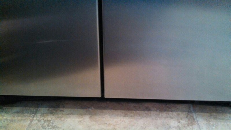

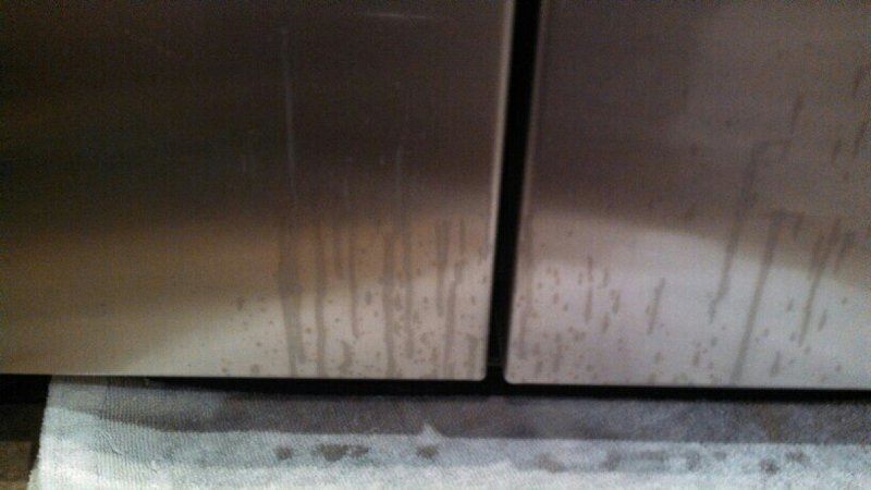

Here are the pics. Still have it, thank goodness.
Word of advice. We used to only keep acid to touch up in flip top caps, no sprayers. Somehow we got away from that rule. This is what happens. Back to the old rule.

Nice catch!
I don't like to spray anything when it comes to floors, always pour.
