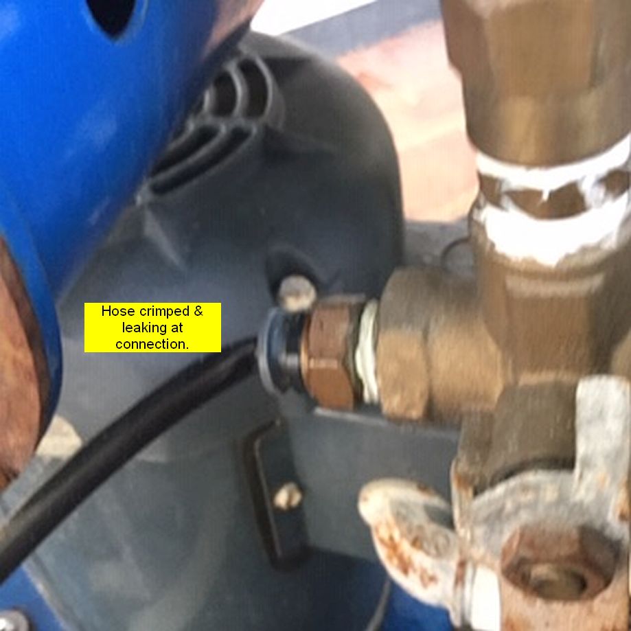

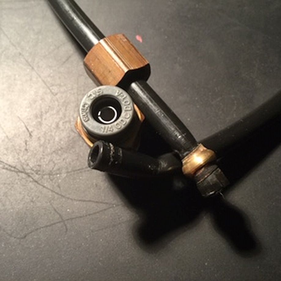

I have an ancient HOS Sprayborg that's probably about 12 years old.
I don't use it very often.
Yesterday, I needed it for a job and found that the tiny black solution hose that comes from the on/off tap down to the jets was crimped and had fractured, causing solution to drip.
Can someone point me to a supplier that can supply this part for me.
Overall length is app; 22.5"
Thank you.
Shorty Down Under. :yoda: :very_drunk:
24,126
You should be able to get the compression fittings at any hardware store as well as the line. But, you should have enough line to cut the end off and just install a new crush ring.
15,250
Ne
Just do away with that and install some plastic solution hose
