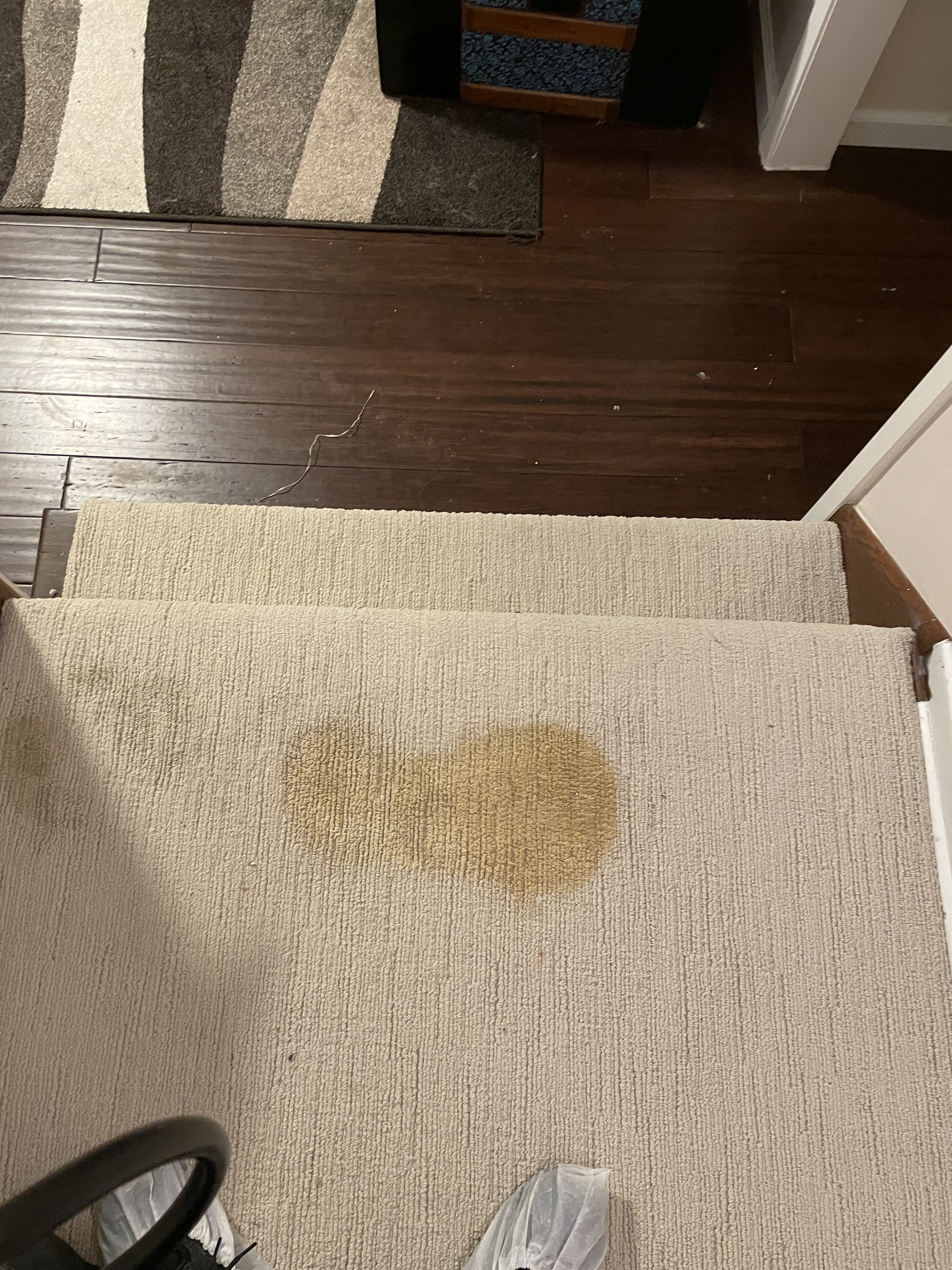

couple comments
1 what made you think to take a picture of the spot prior to cleaning it? ( nice that you did but I would find it time consuming to take a picture of every bad spot I clean before I clean it)
2 suggestion. usually when I see spots like that, I just rinse with water FIRST before using any cleaning agent for two reasons. it gives me a good idea of how easy it will be to remove (as most spots just rinse out with water) also, it makes the cleaning agent or whatever I decide to use that much more effective as it only needs to work on a fraction of the initial spot.
I don't take pictures of every spot or stain I come by. The ones that look the worst I do take photos of so if it comes all the way out then I'll have a great before and after photo for marketing. Sometimes customers aren't around when I clean so I can also show them some photos of the cleaning. All I used on that spot was my fast break pre-spray, had my spotting kit right by me if needed but I always clean over the spots or stains before I go ahead with any spotting treatments.

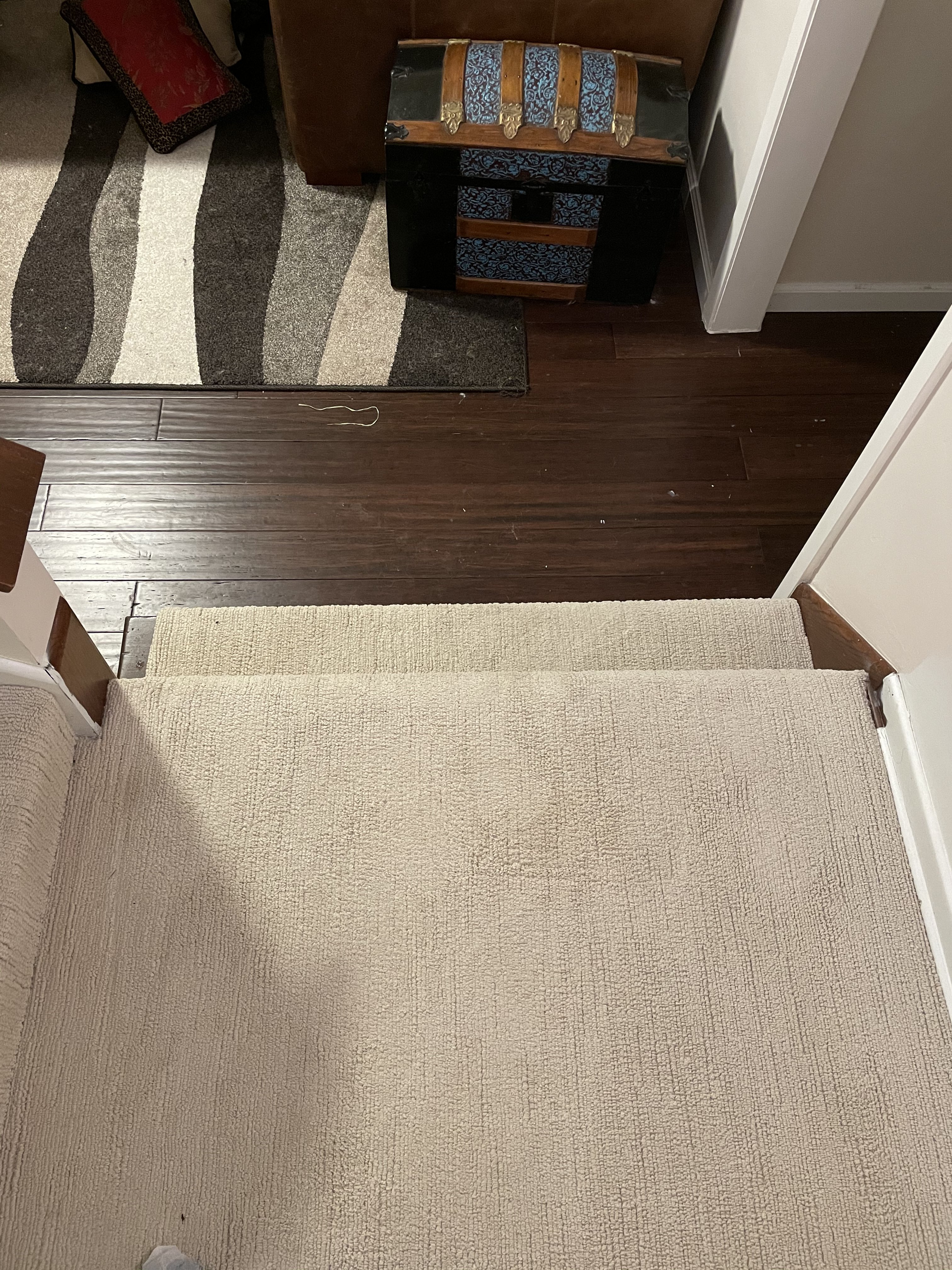

Went back out there today and it was definitely just some residual vomit that came back up. The spot was 50% lighter and was a simple spot clean of the landing. took 5 minutes to set up and get after it. Noticed a few spots on two steps so I recleaned those while I was at it. No charge for the customer, he was happy I was able to make it out before having some family members over for the holidays and reclean the area. Left some blotting powder over the area to hopefully soak up any vomit that may be in the backing that might come through as it dry's. Now time to drive home in a blizzard and enjoy the next 4 days off! Happy Holidays to you all! and Bah Humbug to hogjowl 😂
