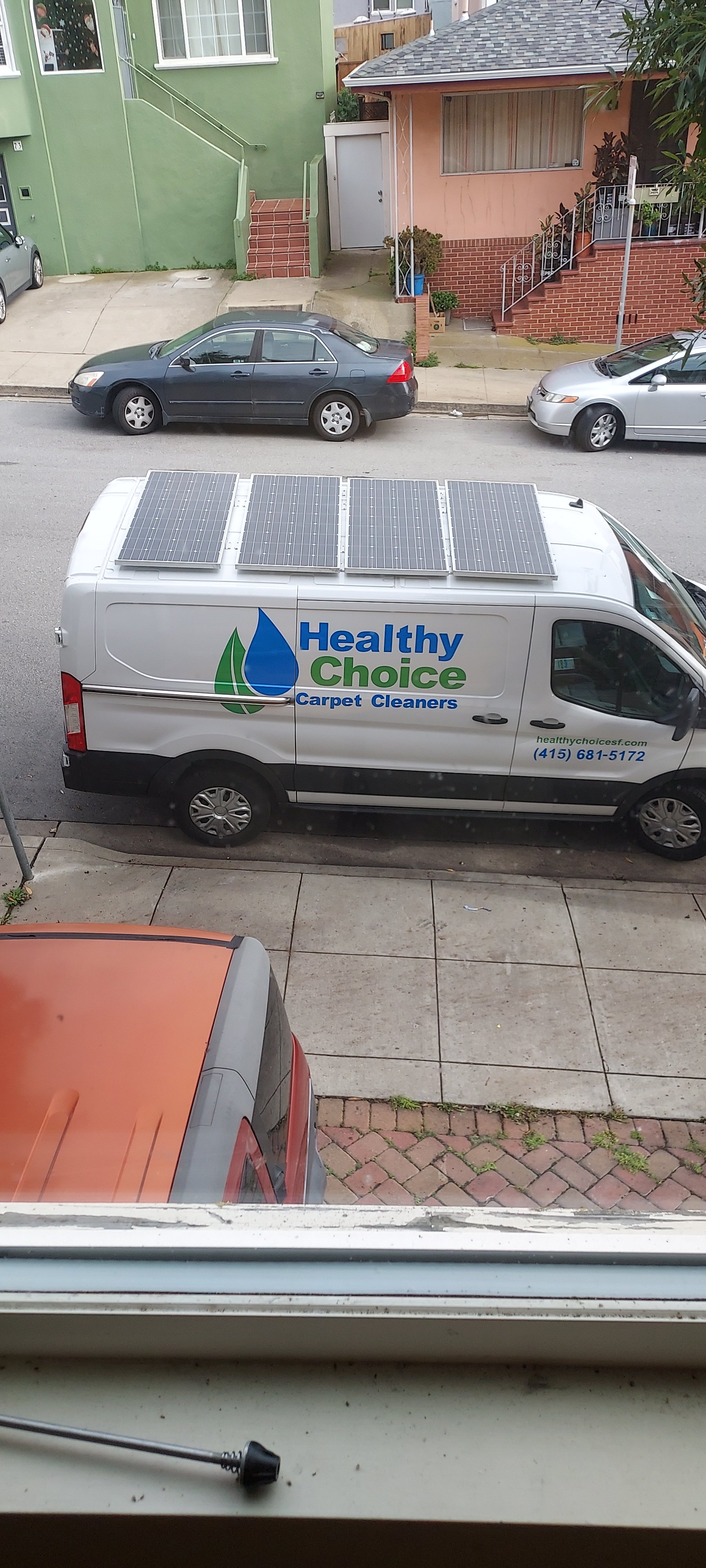

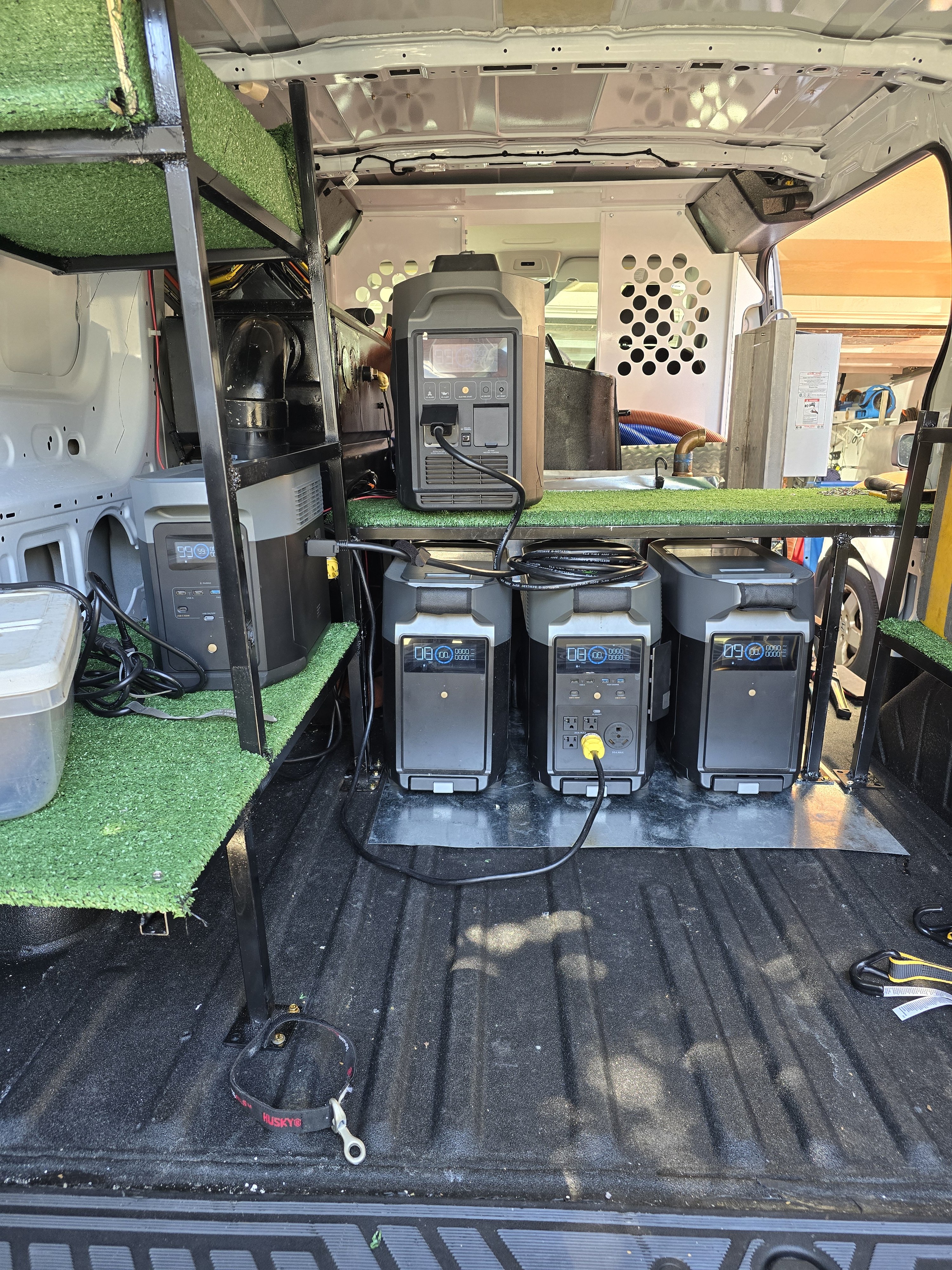

Ok, Thought I built the 1st hybrid solar cleaning machine.

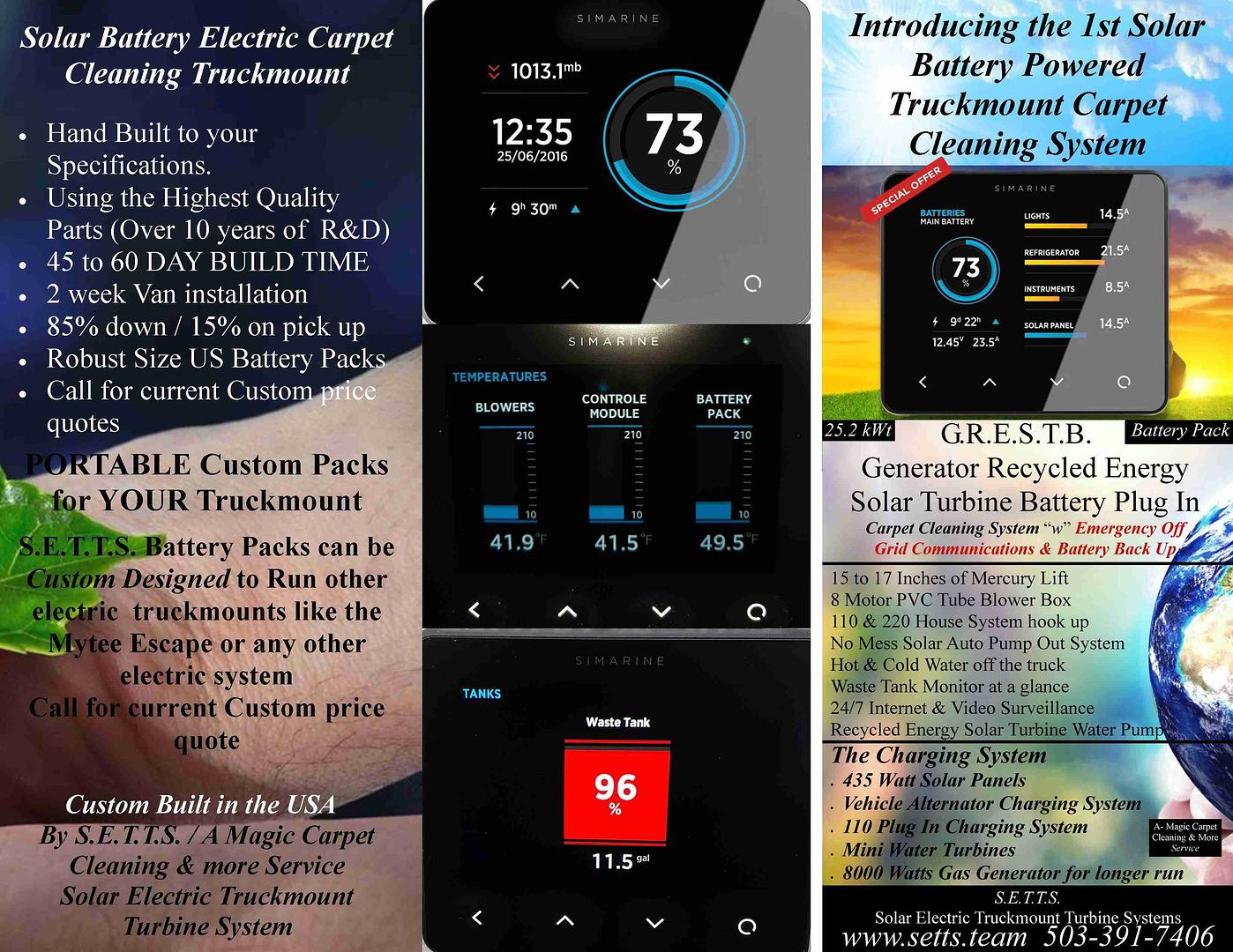

Still doesn't show what the temp of the water is, but it does show how much water is in the recovery tank. That feature should be applied to all machines, not just truck mounts for it would prevent many problems when the float switch fails

Solar is a very dilute energy source. I can't imagine that those 4 panels on the roof of the van even make up for 10% of the systems energy during use. And one would need a seriously epic/heavy/very expensive battery bank to get through a small job. I know its a hybrid. I just wonder how much the off grid aspect really supplements operating costs vs the initial investment..
what's an "8 motor pvc tube blower box" ?

Which becomes a gas powered truck mount. Still don't know what they are using for heat.
I do have expensive battery packs which are charged by my solar panel on the roof of my shop and can also be charge at ev charging stations.
But you are correct, solar not as good as gas. This was a vanity Green wash project. But haven't had to pay for fuel yet on my EV van.

I'd like to see the floor space it takes up with batteries, lectro mount, waste tank. 8k wt generator (for "long run" time*)
you can see the setup in my photos. I could have redesigned to save more space. but this is 1st version.
