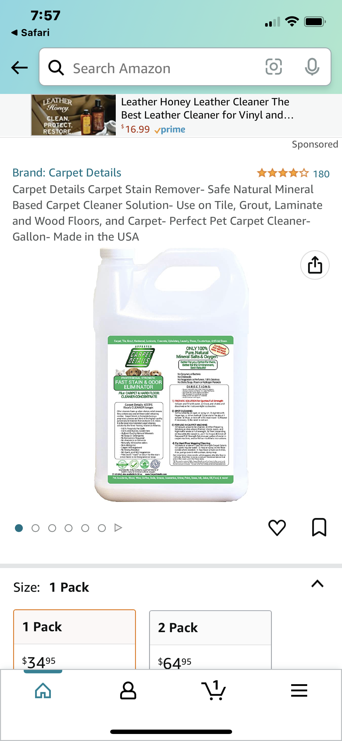

I love carpet details nothing better for large amount of blood removal. Never have to return a second time . I also use it on a first time job not knowing who did what prior. Makes my job easier. Today is my 42 year in cpt cleaning also just past 81 last week slowing down but still enjoying cleaning. jz
