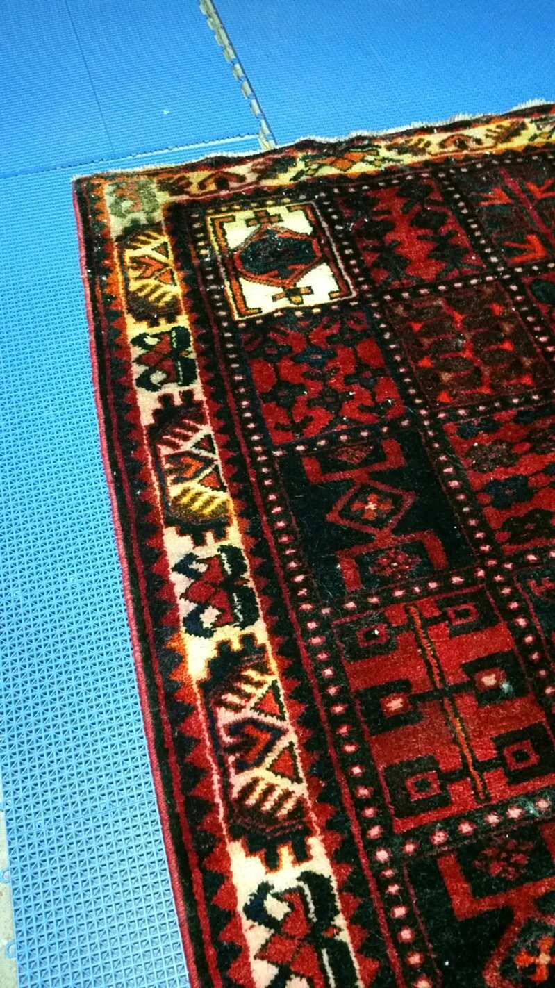

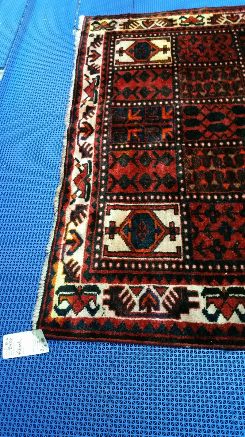

I have 3 rugs in my plant that had severe urine stains on them.. the urine was so old the rugs smelled like ammonia. We cleaned on the acid side and w cold water but the colors still bleed ALOT and over the entire rug.
Use Red 1 and Magic but still not good enough.

There might not be anything more you can reasonably do. The carpets were damaged before you got them. Before I use an acid cleaner, I usually treat a bleeder with a non detergent acid product, like a browning treatment (acetic acid). I find this helps to fix the dyes somewhat and then I clean with the detergent. Works for me

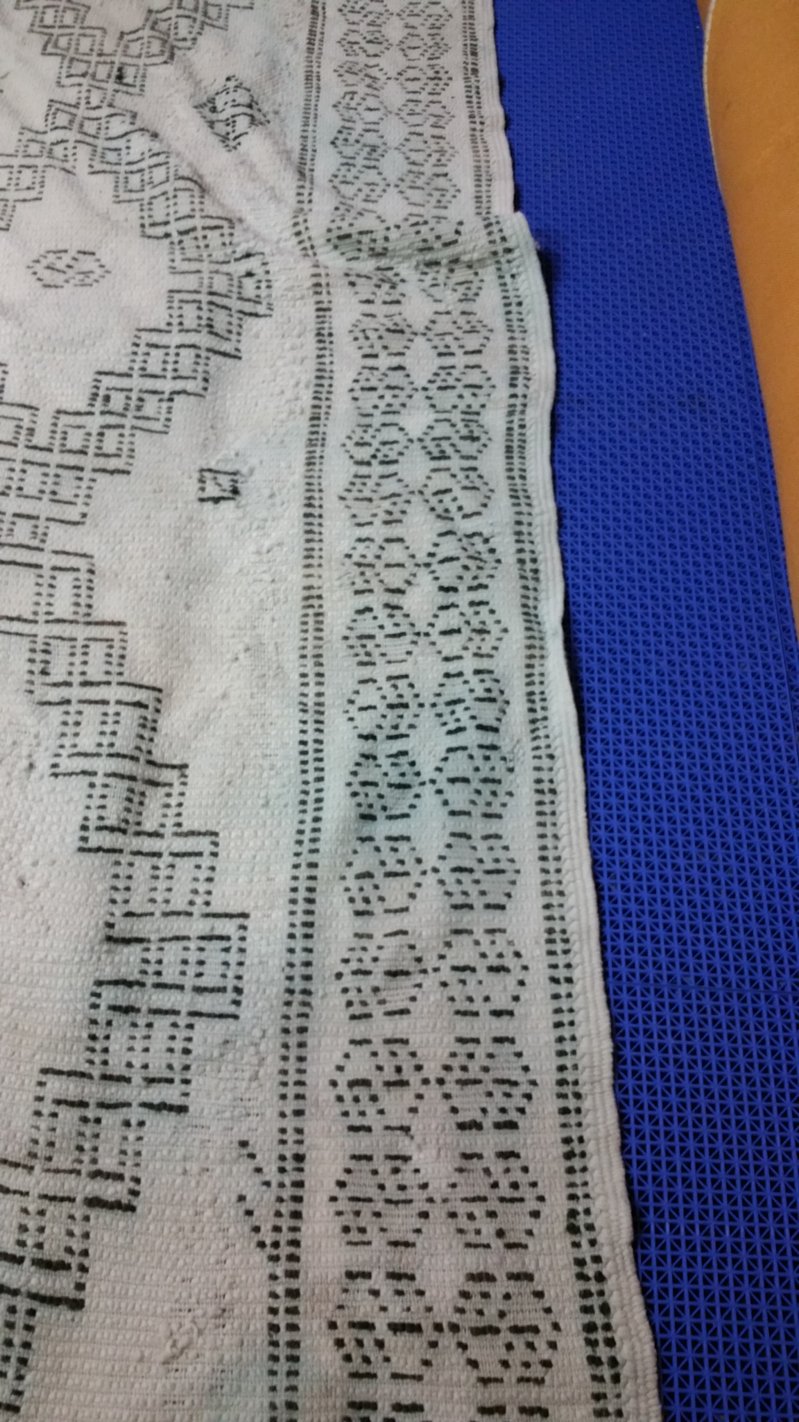

The red dye run is worst in person. the yellow of the white areas is where I used Magic. The white rug is the back of the rug cuz the dye run shows up better.1470348807902.jpg

I might have to send my tech to the rug summit with the rugs for retraining and trying to solve this problem.. On the white rug-- since stain 1 and red 1 wasn't removing the dye-- he used a mixture of vinegar and dish soap-- because that's what the internet said to do :hopeless::oldrolleyes:
