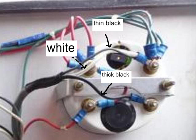

116,395
You can see here that the gray harness has a white and two different gauge blacks hooking up to the rpm gauge.
Is there any way to over ride the high rpm shut off by connecting these in some fashion?
Jim Martin
Arizona
Jim Martin
you should be able to take the white one and the thick black one off and put a jumper wire from post to post and emanate the switch.........the thin black one should be just a ground...........

I am curious if the gauge is the actual switch turning off the machine...or does it control a relay?
The way most of the wires are in multiples it looks like voltage being fed to lights...I agree with Mr Martin...I think I would put a volt/ohm meter on the terminals on the right to see what is going on there...after doing that I think I might jumper across those terminals...but of course I defer to Mr Martin.

From what I can see......the switch that is giving you the problem is a micro switch.....it gets its power from one of the red wires..then carries it back to the switch..the switch makes contact and sends the power back threw the other wire completing the circuit.....more then likely it is normally open until the RPM's are ran up and the washer moves away from the switch and closes the circuit...(hard to tell)..if you leave the switch connected and you are already having a short in the cable you could cause a lot more problems..by removing the switch wires and adding a jumper you are passing the entire switch......
Jim Martin
Arizona
Jim Martin
the switch does not allow the machine to start at high RPM's....it is more of a safety switch...like if the high level float shuts the machine down and you drain it and forget to unload the rpm's ....the machine torque could twist a shaft or snap a u-joint.....
