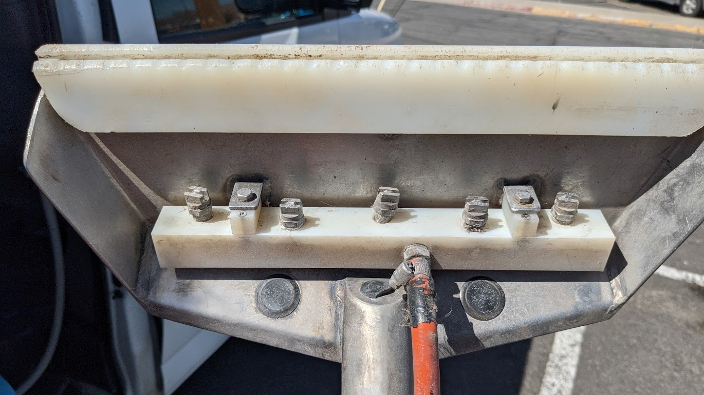

well howdie-doo
plastic manifold, center jet cross threaded and a band clamp on the manifold supply line.
nice....

the three attic access ports tells me there's some weld spittle going on in thar.

plastic threads and Marty's dont jive...
Your age is really showing. I’m surprised you couldn’t see it.
The jets are offset
But you’re right on the plastic threads.

One of the worst versions of a wand ever..3 jet was by far the best of there versions...

The nylon blocks were a vast improvement over the original aluminum ones that would blow a hole out directly opposite where the supply line entered.
You did have to be careful to not cross thread a jet though.
