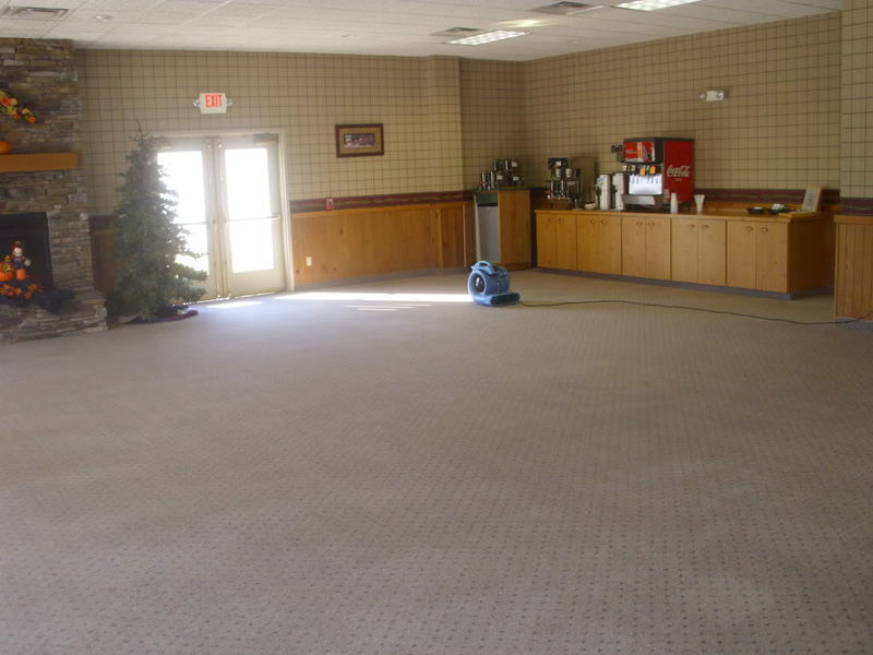

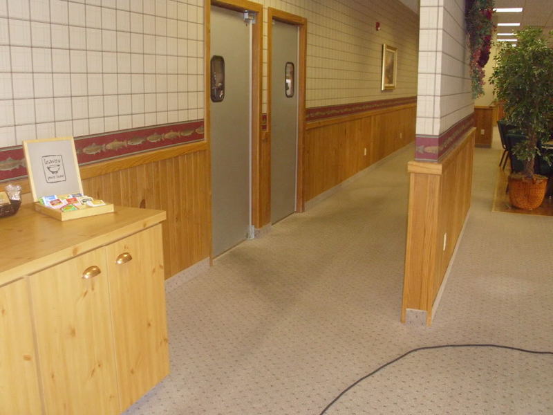

Here are few pics of a job I did a week or 2 ago... Its a conference center with olephin CGD and this is right outside their busy kitchen. This area is alway hammered. See for yourself...
Here's another area in the same 5000 sq ft dining room:
This was all done at 2 oz per gallon. It looked even better once it weas dry...

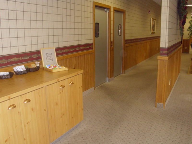

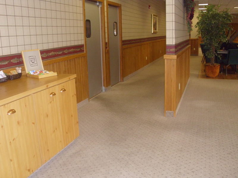

Ok guys here we go...little back ground.
This carpet is roughly 13 yrs old, get done quarterly, but they like to stretch it out if they can...the area i am showing has a warehouse area that comes into it....I usually encap, i use to extract (portys) then post bonnet...always had issues with streaking, wick backs...UNTIL RICKYS ENCAP. Everynow and then i would extract/flush, then go back next day and encap it..always looked great, in fact thats why they try to stretch out cleanings.
So 1st pics are of the wick backs with clean lines of encap (snakeoil at 2 oz a gallon)
Last 2 everything looks ehhh ok huh...this was Sat night....
Wed night this is what it looks like....they have mats, so i flipped them over to show the RESOIL issue
Like i said, 2oz a gallon, on a already "cleaned" floor...never have i had this happen here, after i used rickys juice..
Also as i was cleaning, it seemed it didnt want to break it down as easy as rickys had in the past...almost like it was tellin me to put in more...so i did bump it to a 4 oz mix, with same issues...
So IMHO if i have to use 4oz a gallon of this, then its not that much of a savings....
Jeremy
3,720
Indiana
Jeremy
Try it at 3 oz per gallon instead of 4. That's a 50% increase in the chemistry/polymer. Just curious but, did you vacuum first? Looked like a bit more than "light soil" to me in couple of the pics. Looks like it cleaned "OK" at 2 oz but maybe there wasn't enough polymer for the soil load?
