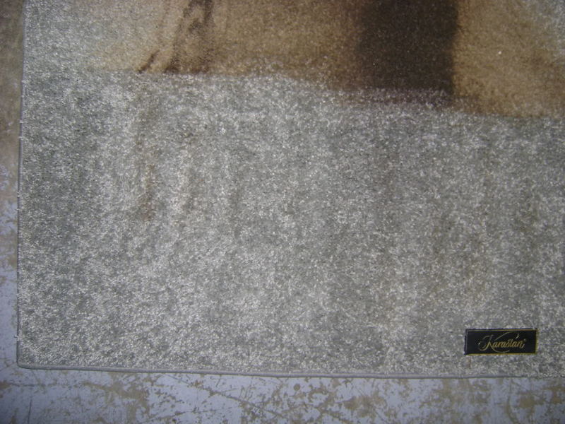

Jim: no chems:
But as you can see there was a little shadowing.. p.s. this sat about three weeks before I tried water only... not bad for water only clean up, but you can also see the oil affinity as it took a good prespray to rid of the oily shadow.

I don't wish to be unfair: David's pics are impressive. But massive spills accumulated over a short period of time is not the typical scenario we deal with.
We get lower (less visually dramatic) accumulations over a longer time span (18-24 month average) that are impregnated deep into the yarn and fiber surface by traffic.
