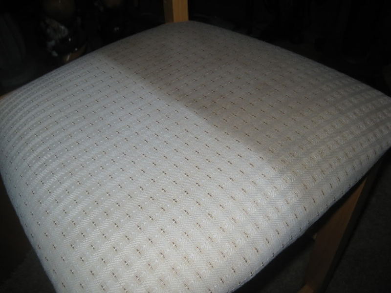

I've been running slurry(1/2 sug.) for carpet and uph. rinse for the last 2 months and haven't had a problem yet.. I went through the iicrc class for uph. I was taught that an acid rinse was the only way to go. Since switching to the slurry I've noticed that everything cleans up way better in less time. :? I have never personally seen color bleeding and have never had anything brown on me, so have I just been lucky? Anyone have any good picks of color bleeding on uph.? I would like to see what they look like..
Here's one(actually 6 chairs) I did today.. At least ten years old never cleaned. :D

I use Dry Slurry as a rinse for wool (not orientals or unstable dyed rugs) and upholstery and have had no problems at all, everything brightens up better as well. I run it about 1/2 to 3/4 recommended dillution depending on soiling. Best rinse I ever used, people talk about resoiling issues with it and I don't think they've really used the stuff cause I use it ALL the time and have no resoiling issues with it. There's a reason it's the best selling product of its kind.

Do a color fastness test on every piece before cleaning. Put a bit of the strongest solution you plan to use on a cotton towel and rub. I would at least carry a small 2 Qt pump up sprayer with some acidic to neutralize on the cotton pieces.

Slurry is a kick ass cleaner, but on weak dyes it can strip color and can cause bleeding as the fabric dries.
On herculon fabrics you'll be ok but I think you're taking too big a risk when fine fabric detergent works just as good on upholstery.

There is nothing wrong with using an alkaline rinse on carpet or upholstery. As long as you have one that works well for you. Just be sure the dyes are colorfast and be sure to get it dry.

I've seen too many problems related to alkaline detergent use on delicate fabrics to give Dry Slurry a wholehearted endorsement for upholstery, but I also have to say I've seen more bleeding and browning from overwetting/slow drying than from specific product use.
So if you are going to use it, do what Jose says: Test it thoroughly and dry it quickly.
And be VERY careful on natural fiber jacquard weaves and raw cotton fabrics. I have sections of bled and browned fabric that I use for demonstration in my upholstery classes that were ruined by the use of Dry Slurry or similar products.
Two that I use were not caused by slow drying. Each bleeds very quickly when exposed to carpet detergent. But the color bleeding also shows up quickly when tested.

I'm glad Jim pointed out that I never really endorsed Dry Slurry. In fact, I used this product in my early Coit "tech" days, but when I became manager, I banned Dry Slurry from the techs.
I think it is a very aggresive detergent. I think the pH might even be slightly over 10. It will clog up your pressure lines like nothing else causing more frequent descaling. My experiences and thoughts anyway.
I will repeat that an alkaline can be safe as long as certain measures (that I know Jim teaches in his courses, even though I've never been to one) are practiced.

Thanks for the posts.. I would think Slurry isn't over 10 ph I'm guessing 8.5. It wont "clog" up a thing with last step chem injection.. I really want to take Jims class since the last one I took had me bucket cleaning everything with a horse hair brush. :shock:

Slurry does indeed clog when not thoroughly dissolved and mixed with hot water. I used it for 3 years straight on a prochem performer 405, and I had to descale every month, ontop of cleaning out the Y-Strainers and other various orifices.
The bucket thing - on natural/finer fabrics a foam will be your safer bet. I've cleaned haitian cotton - synthetic/natural blends with great results and no issues. The pieces dry extremely fast.
