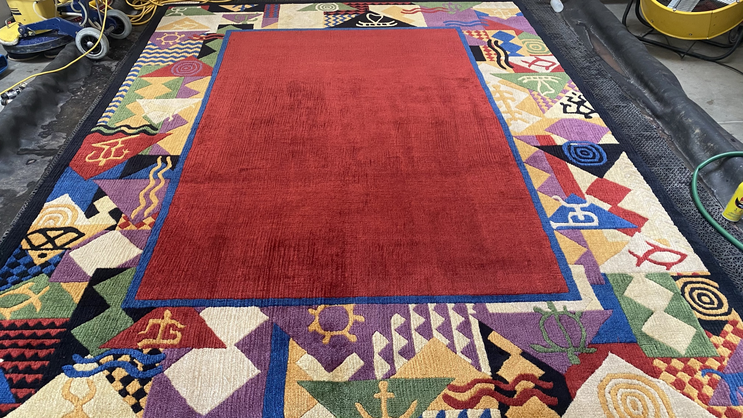

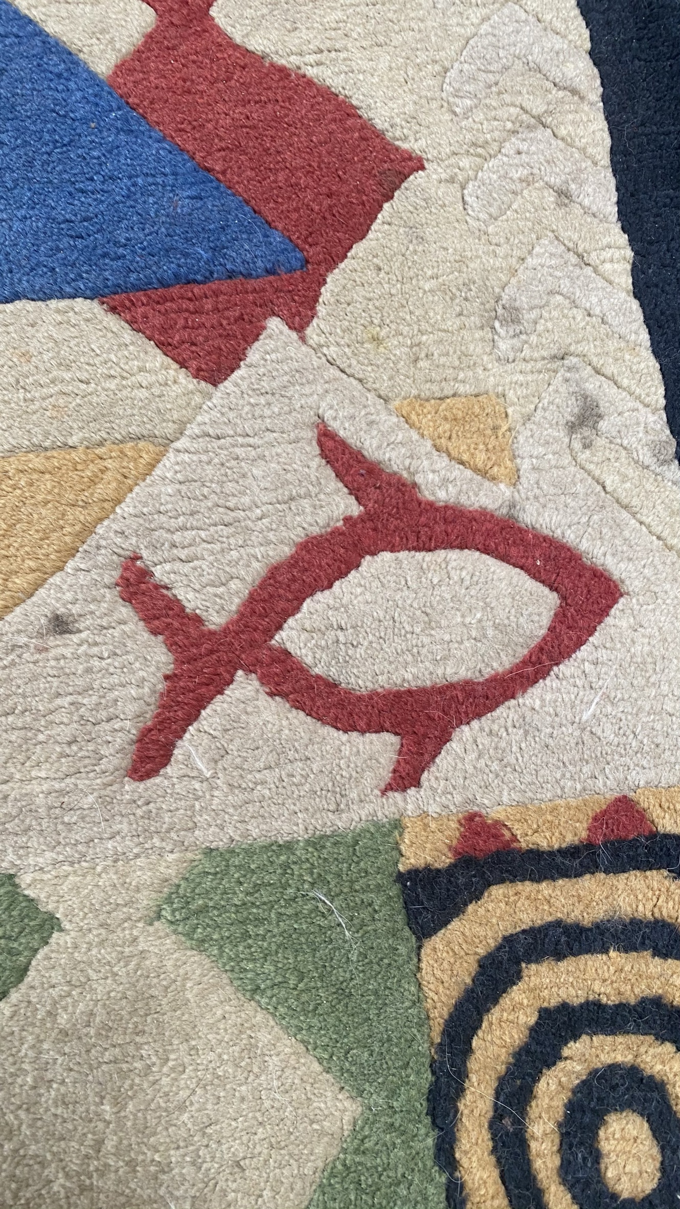

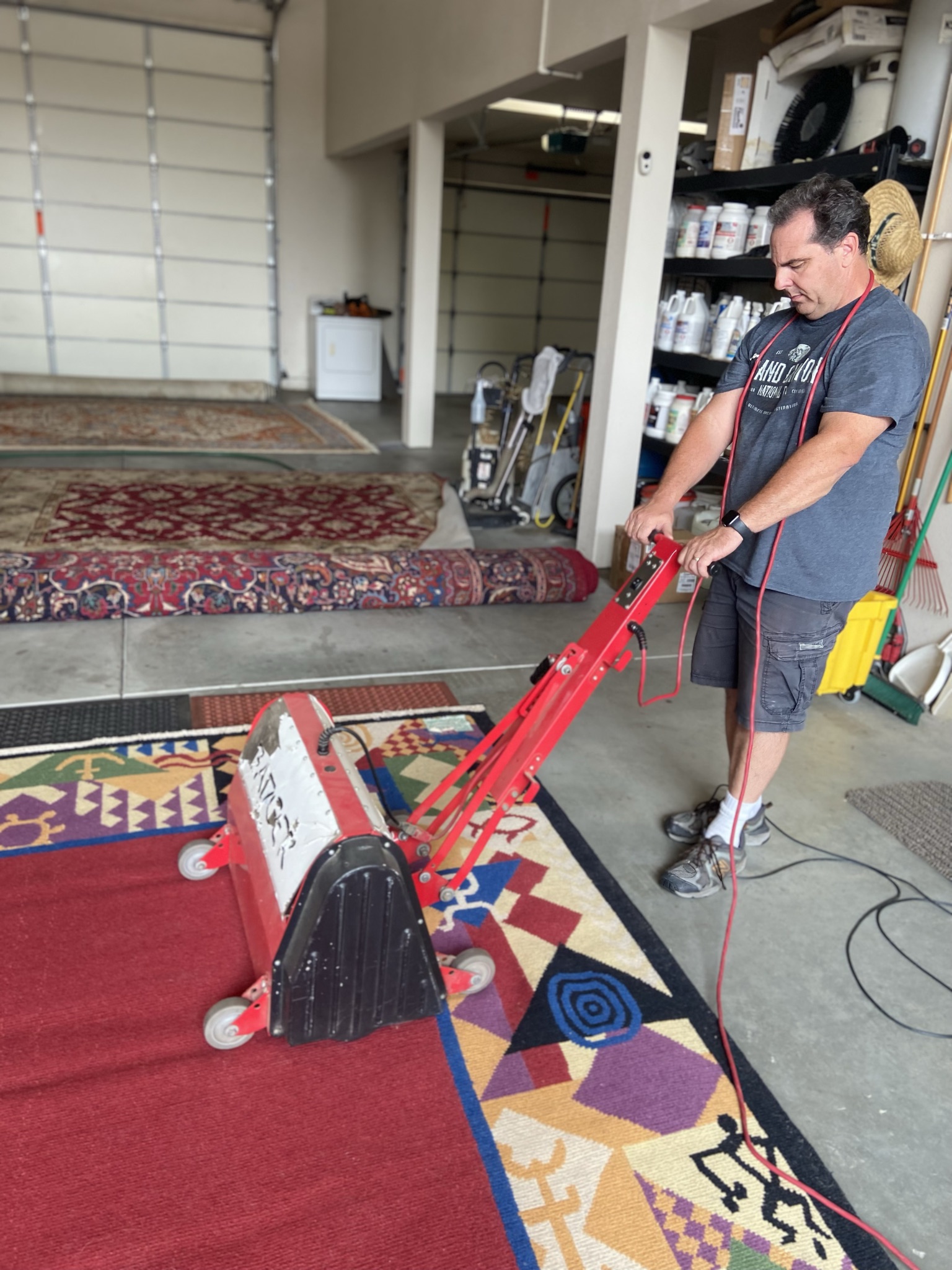

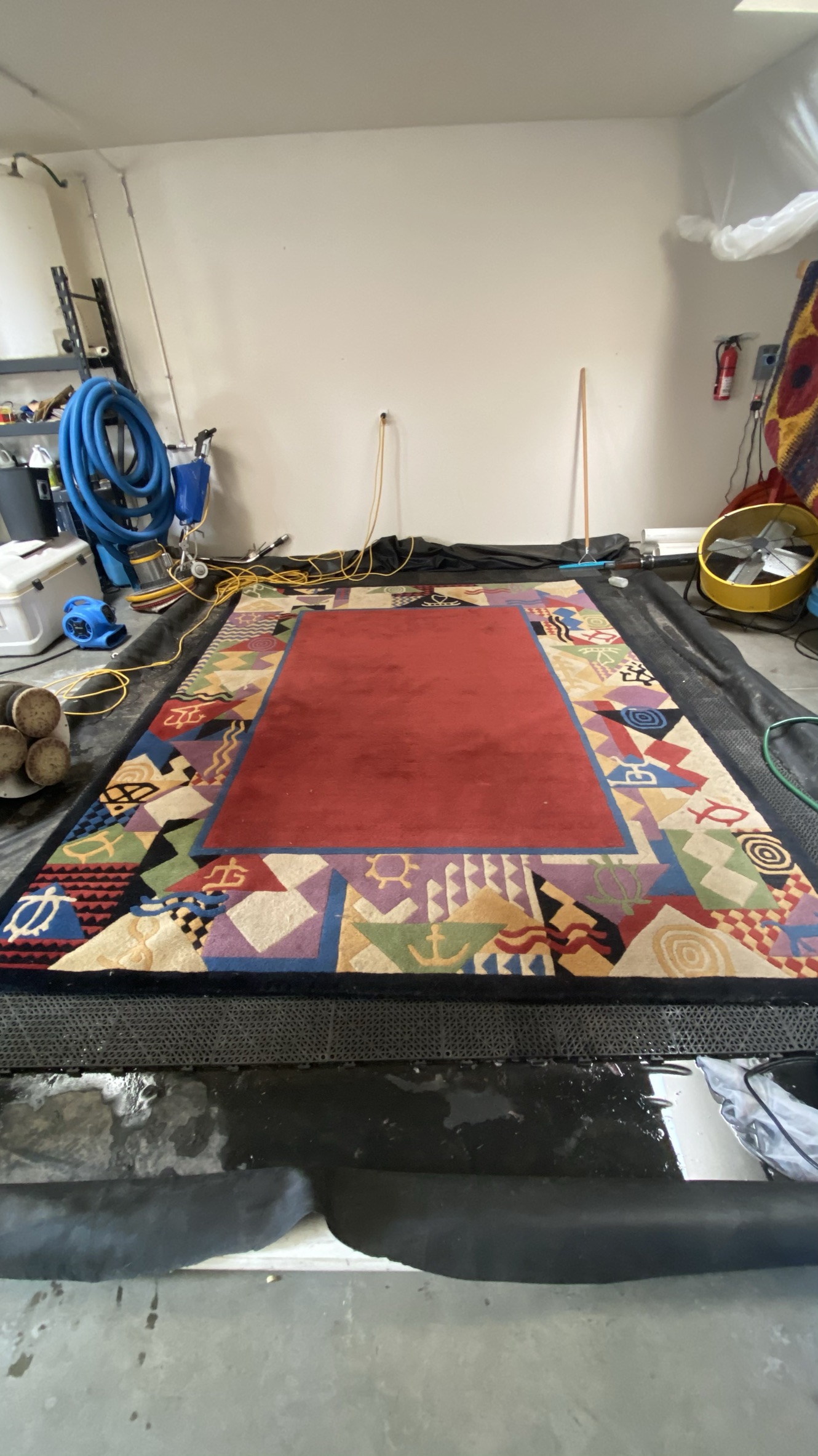

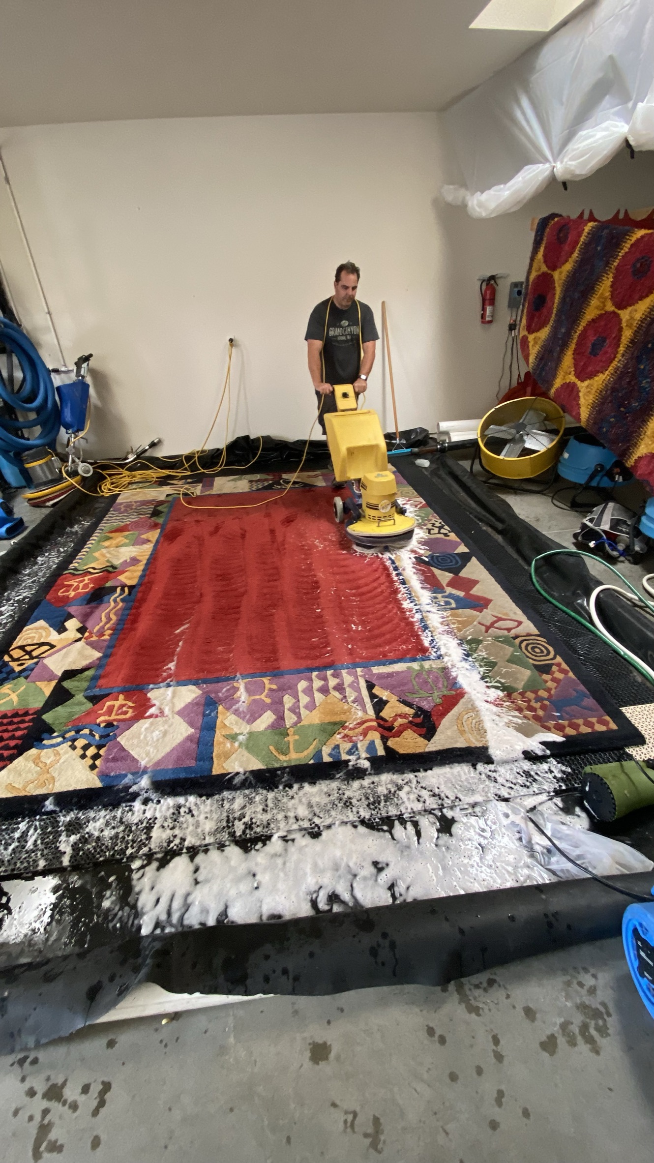

I cleaned a couple of rugs today with the stuff. I'm pretty happy with the results. I mixed it at 5 oz per gallon and applied it with a Cimex. Had some good scrubber bubble action going on. The last rug was too large and heavy to hang on the rack so I had to dry it in place in the pit. Here are some before an afters. It brightened up the rug pretty nice. I rinsed with a Hydramaster acid rinse specific for oriental rugs.
BEFORE:
AFTER:
Soapy suds of fun"
Dust Buster:

Lol..
Huey, the rug is supposed to be upside down when you whack it with that stupid thing
