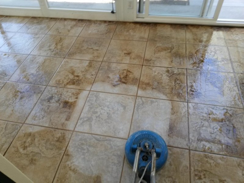

Here's another filthy porous ceramic tile job cleaned with 2790. A sunroom where 3 large dogs slept.
