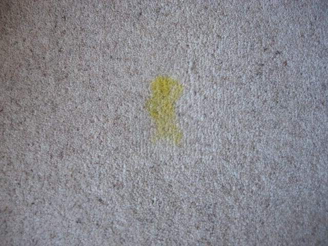

I knew I had a job a few months ago where I had done this but couldn't find the photos. Got them now.
Stain was not treatable at all and he didn't have any off cuts.

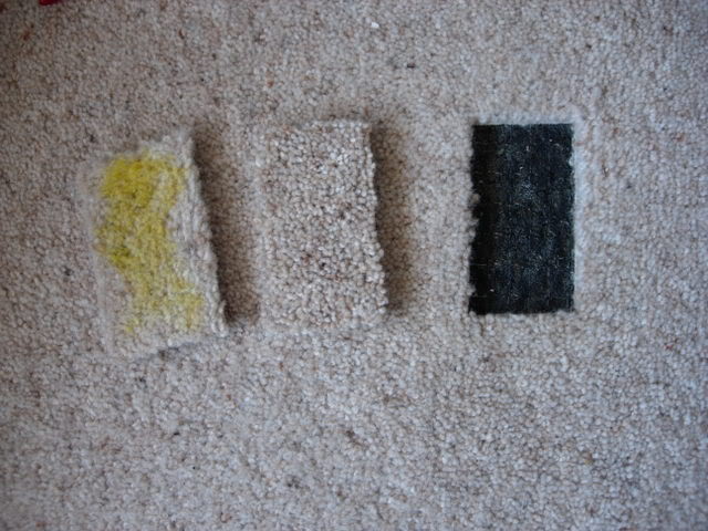

I cut the stain out of the room, cut the exact same size out of the inside corner of the wardrobe and swapped the pieces.

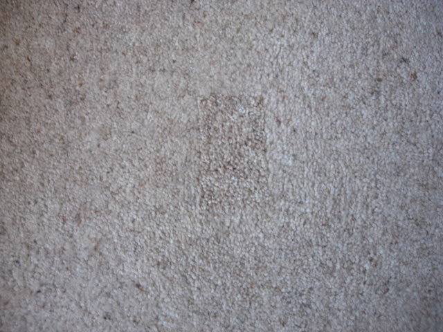

The area was aggressively scrubbed and had a lot of fuzz, I trimmed this when I had finished.
The two pieces.
Finished... yeah I know, should have had some crayon or chalk.

Heath the chalk will not be permanent but then again neither will the color difference on the repaired area. The crayon, if heat set will last a very long time unless it's in direct sunlight, in which case it will, over time, fade just like a mustard stain.
