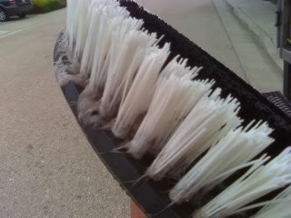

Brushes sure dig it out don't they?
Fiddy may not no squat about customer retention or profit margins but he was right about a brush digging deep.
Is there an easy way to get that hair out with out ruining the bristles?

Get a wire brush with the long handle at any hardware store.

Run some nails through a 1x4 piece of wood. Flip machine on back, have helper or Paula turn machine on. Put board with nail on brush and watch the crap fly off.

We have the red ones referenced above.
But to get down to the lint you pictured...,
the wood device with the nails will do a better job.

That is just a combination paint brush comb and roller scraper. The are available at most paint supply houses or hardware stores. Just google Paintbrush Comb
