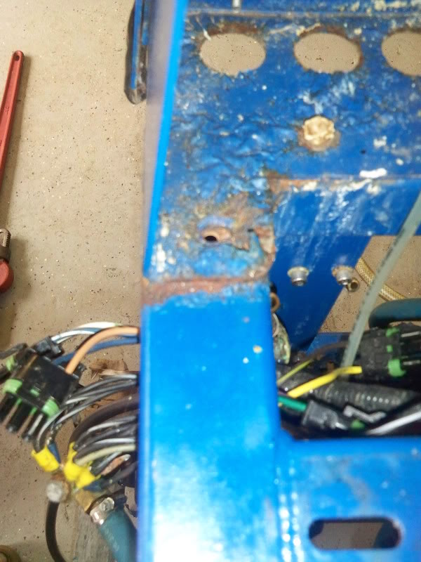

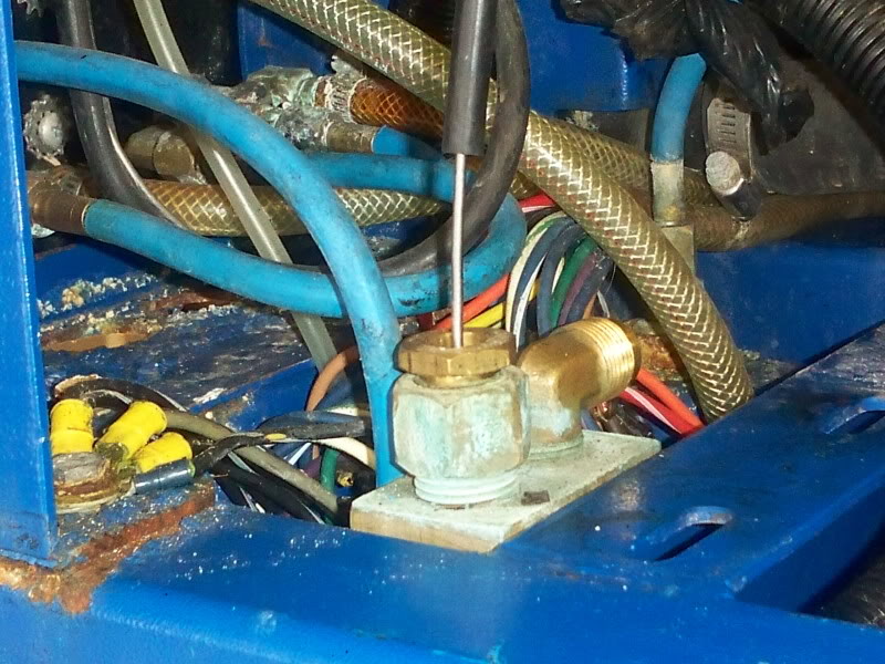

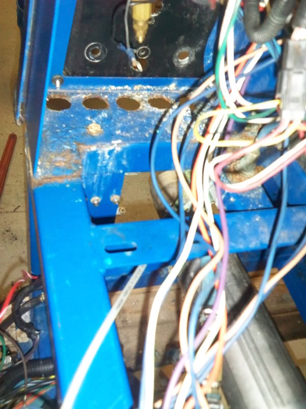

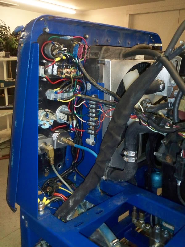

During the recent reengineering of a truckmount, it has come to our attention that there is a possible issue with steel-framed truckmounts. During our redesign process we have discovered that if you have all your ground wires coming to the steel frame at one point, you may very well experience excessive corrosion.

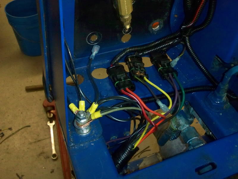

A lot of people don’t know that a ground still has current running through it. As you can see in the photographs, at the point where the ground terminals are bolted to the frame, the frame is corroded considerably. There is also an area around the terminal that is corroded.
To remedy this problem, we are planning on removing the corrosion by grinding, re-priming, and painting, replacing the ends on all the ground wires, and reattaching to the existing location but with a modification. The modification will consist of adding a ground wire from the grounding terminals bolted to the frame to the ground on the battery. This wire needs to be a very heavy gauge; something like 4 gauge. This should reduce the amount of current flowing through the frame.

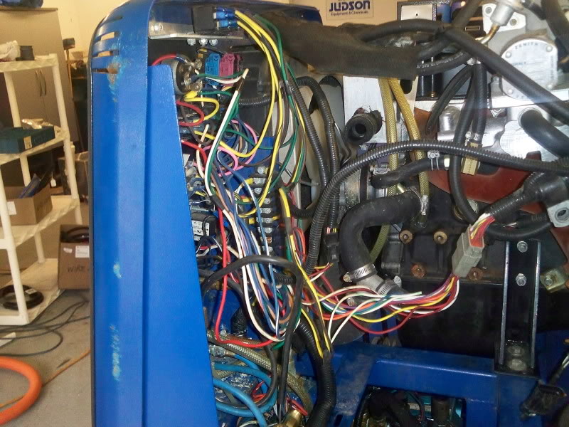

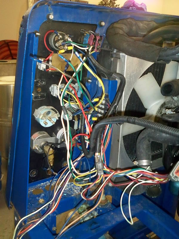

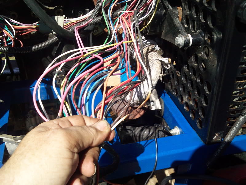

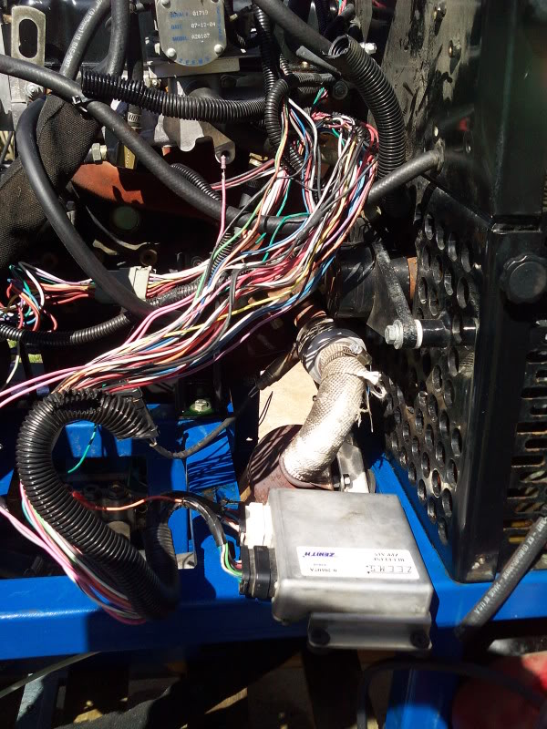

Thanks for asking Mike. Yes, Project Bluebook is coming along quite well. I actually found two issues with the unit today that are high priority issues that must be addressed immediately.

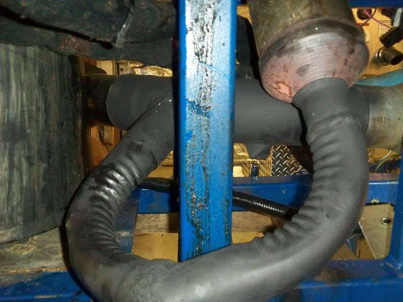

The first emergency high priority thing that must be addressed immediately is behind the black engine coolant heat exchanger is the intake manifold for the engine. Coming out of the bottom of this manifold is a 3/8 hose with engine coolant running to the throttle body. This hose is less than one inch from the exhaust manifold. I accidentally barely bumped the hose today and it snapped like a pretzel due to the intense heat it has been exposed to. This hose must be rerouted away from the exhaust manifold and replaced immediately. This unit has less than 2,000 hours on it.

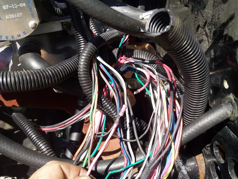

The second high priority issue that must be addressed immediately is that the Zenith wiring harness has failed on this unit with less than 2,000 hours on it. The reason for this premature failure is extreme heat buildup inside the engine covers. When I was test-running the unit today, it developed issues and stopped running. The issue was a wire coming from the oil-shutdown in the harness that had broken where it made a connection with a resistor. While I was removing the harness to find this issue I noticed that the entire wiring harness was melted together from the intense heat. I was able to separate all of the individual 30 wires, but they were heat-fused together when I first looked at them. This wiring harness will have to be replaced due to the heat build-up. It also had several places where it had burned through from the exhaust manifold. I am presently talking to Mike Farmer at Zenith on producing a longer wiring harness to reroute the harness towards the front of the engine and below it away from all heat. I suggest as a quick fix for right now to run the unit without the covers. This will prevent the heat buildup inside the unit. During our reengineering process of this unit, we are replacing the engine covers with perforated, vented metal. You might be able to take your covers to a metal shop and have them cut them out and weld in either expanded or perforated metal.

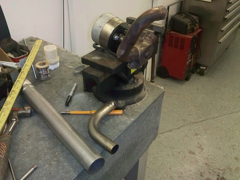

Several other things I would like to mention about our reengineering of this unit is that we have made quite a few improvements on the design. One improvement is that we have taken the exhaust system from a 1 inch pipe to a 2 inch pipe on the engine.
Another improvement we’ve made is that we have eliminated most of the wires behind the control panel and cleaned it up nicely.

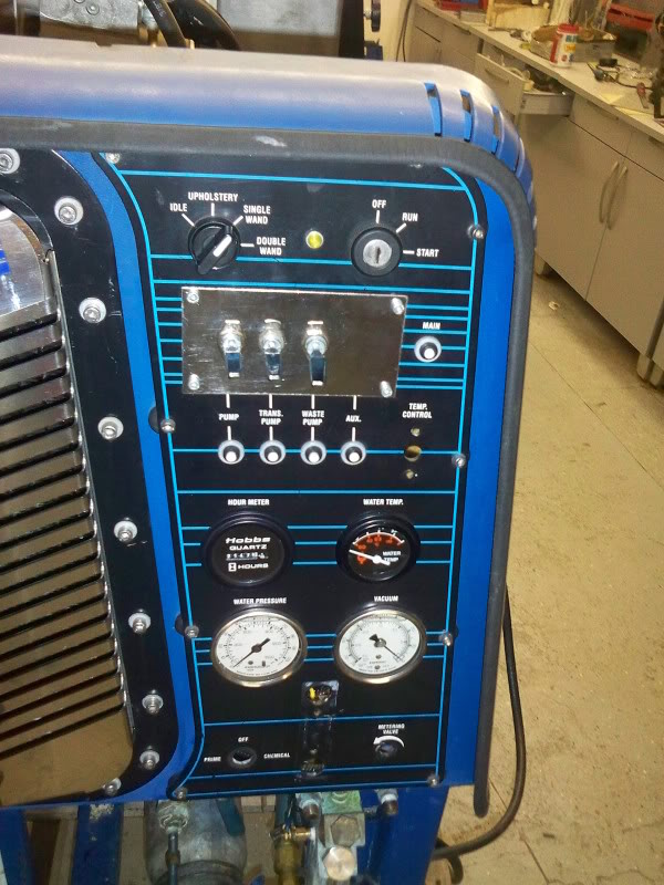

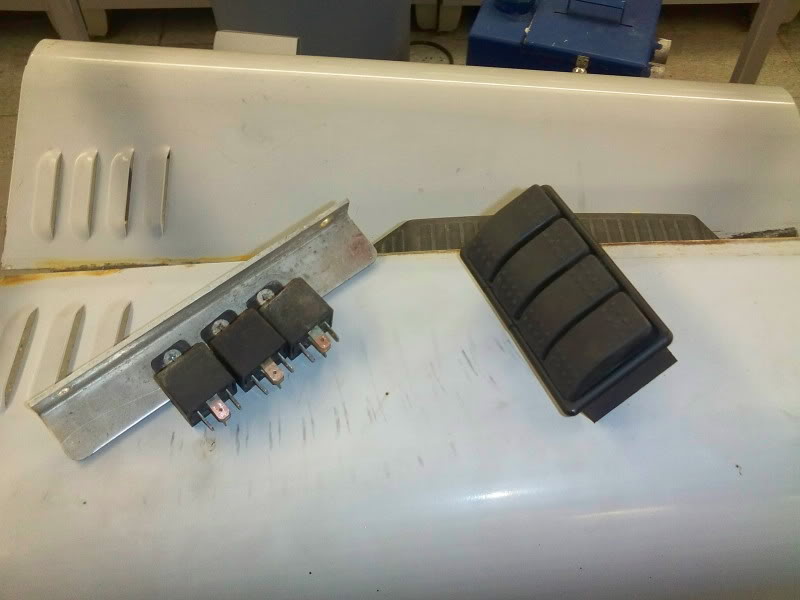

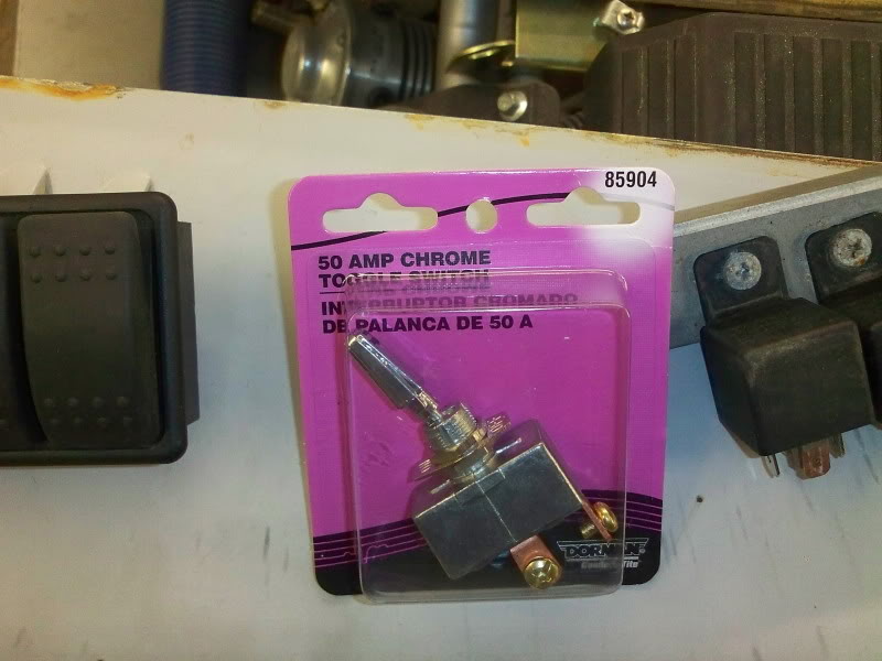

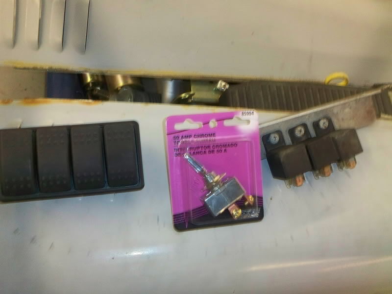

Also, we have eliminated the rocker switches that were not common and fairly expensive to replace. We replaced them with an auto parts 50 amp toggle switch. We were also able to eliminate 3 relays by using these high amp switches. The replacement switches we found cost $5 and can be found at most any auto parts store.
This is a photo of the rocker switches that we replaced. These switches are not high amp switches. That is why they required relays.

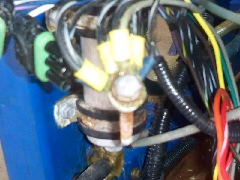

We have repaired the corrosion and installed a ground stud instead of a bolt. This ground location has 8 wires going to it. We are still going to install the 4 gauge grounding wire from this location to the negative on the battery to minimize the amount of current going through the frame.

I have the same machine and i don't have any of the problems you have mentioned. i live in south florida where it is pretty hot. my engine cowls already have vents in the sides and i've done temp testing and the engine runs cooler with the covers on.
i have 4 times the hours and my switches are fine. why replace a working switch. the originals look way better. yours looks jerry rigged. as far as wires maybe the machine was run with low oil or water causing excess temps. i'll have to check my hose to make sure it's ok because i have not, but i did recently recore the radiator and the hoses were all still supple.

That machine sure doesn't look all that good for only having 2000 hours on it. Maybe some of the issues are owner related. Why not just cut out the affected harness and replace and extend it without replacing the whole harness? That machine is a perfect example of why not to build a machine with a steel frame let alone paint it.

I think you made some very good points concerning wiring ...
and hoses too close the exhaust components.
Our service department see many heat related failures on TM with enclosed engines.
