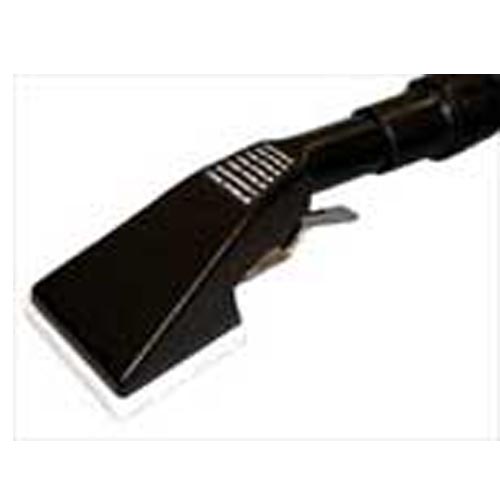

Tried the new Saphire today on microfibre.
Likes:
light weight, nice feel in the hand, nicely balanced, easy triggering
very flexible hose with good length. (I want one for my HK tool)
Dislikes:
left the fabric wetter than the HK
VERY Noisy, twice as noisy as the HK
uneven spray, you can see this in the video. I'm not really convinced the jet pattern is the best for an overall cleaning.
sucks in the fabric too hard, makes it harder to pull along the fabric than the holed teflon glide of the HK
You can see it really grab the material in the vid.
the trigger lock would not lock with pressure in the line. That's what I was trying to do in the video just before I showed the spray of the HK. With the water pressure off, the tool would lock, but with it on, it wouldn't.
If I were to tweak this, I would make the trigger lock easier to work, able to work it with one hand.
I would change the jet system to make it flat like the DM tool and make the vacuum slots into holes with a thin slot after the holes to avoid the lines left by the HK tool's holes.
I'd use teflon as well, slides much easier than the plastic.

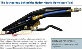

Two biggest flaws with the HK are the line left in the fabric by the holes and the weight of the tool head. It does flush the fabric better, esp for a stubborn spot, and it leaves the fabric dryer.
I'd love to blend the two, take the best of both and put them in one.
Overall, had I bought this tool, I'd be very disappointed. Against the HK, it doesn't keep up.
Had I bought this without a comparison, I'd probably work with it and think it was doing a good job.

A agree with Ron and knew he was not going love the tool in comparison with the HK. The locking trigger badly needs work. The flow valve is a pain. Build quality is suspect but time will tell. If I were using any other tool other than the HK it would have impressed me more. But the even with it's flaws the HK still wins. It is faster and leaves the fabric much drier.
If you clean a a lot of upholstery you can tell in 5 minutes if you like an upholstery tool or not. That said, upholstery tools are a very personal decision. I still would like to try a CFR and compare it to the HK.
116,461
I've tried that tool and was not fond of the hand ergos or the angle of the fabric/ tool interface at all.
The big flat block leaves a lot to be desired IMO.

I agree Mike, those are the flaws of the HK. But why should I clean 20 sofa's with a tool in order to figure out its flaws or whether or not it works better than another tool? How long does it take to form an opinion?
Mikey P said:
First off the spray pattern in not important. the water needs to fill that channel and that's all. Plug up every other hole and it would still work fine.
So you would trust its actually cleaning if only one of those jets were working? I wouldn't. The water is angled to come out and be vacuumed immediately. There is no slot to fill. Its not like the DM tool where the water comes out evenly across the vacuum port. That tool is DESIGNED to have full flow ACROSS the whole width. Each water hole will flush its area. With the center two not functioning, there will come a time when it will leave a streak in the middle of the wand pass that would have to be compensated for by an extra pass, just like having the middle jet in a greenhorn plug. You wouldn't notice it on this fabric because of how the preconditioning wetted it down. I tried doing just a dry pass without water and it left almost the same clear swath. If I'm going to buy a $500 tool it darned well better be working the way it was supposed to work, not plugged up.
And the trigger lock was too hard to work. I couldn't even get it to lock with the water pressure on. Had I bought this tool and it arrived like this, if i couldn't exchange it I would have to sit down and modify/fix it. For $500 I shouldn't have to fart around with a tool just to get it to work the way its supposed to.
Sorry Keith, but as I said, compared to the tool I am already using with its own design flaws, it doesn't hit the bar. With some tweaks, it would probably kick butt and I gave you some suggestions.

Sadly, three tools for me as well. The HK is not perfect, but for speed and dryness it rocks. I like to make as much per hour as possible when I do upholstery because it is a lot of work.
Lisa, if you read this, can you design another optional glide for the HK as per Ron's suggestion above?

Hydrokinetic is good at all three of the above.

On rare occasion I will use my old style Hydrokinetic tool if I don't like the appearance of hole streaks on some fabrics while they are wet. It is even more gentile and I wouldn't doubt leave fabric even a little dryer. It has a metal face plate though, so around wood and metal must be more careful.
