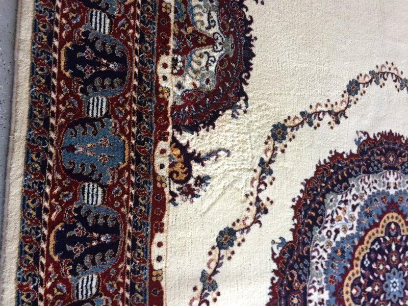

I got this rug in the customer tried to remove a spot and messed the pile up.
How do you fix this?
She said she just use a hose to try to flush the spot out and the pile got weird on her.

Looks to be olefin from my phone..
Same here. Those type rugs are not worth putting any real money into them because they are bird rugs. You know, cheap cheap...
I'd just clean over it with a truck mount and the heat turned up and use a standard grooming brush to set the nap back down.
