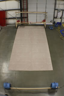

RSA's air movement test setup. Note mist gantry (top), used to apply moisture at precise rates.

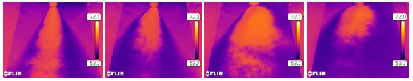

The first round of tests utilized an infrared imaging system to record air movement patterns and evaporation. Each test was performed for an exact amount of time, across the same carpet sample, and with the same amount of moisture applied. Tests were repeated a total of 10 times to ensure consistency.
The series of photos shown here shows the airflow patterns produced by a Sahara Pro X3 centrifugal airmover, the Jet CXV and Ace axial airmovers, and a new "Thrust Fan" unit. The images were taken exactly 4 minutes into each test.
Test Results
From left to right: Evaporative airflow patterns produced by the Sahara, Thrust Fan, Jet CXV, and the Ace airmovers. Brighter areas show where carpet is driest.
Note the long "reach" produced by the Sahara compared to the Thrust Fan. Evaporation occurred much more rapidly with the Sahara, and over a much longer path. Note also the right-angle biased airflow of the Thrust Fan. As expected, the Jet and the Ace axial fans produced the broadest airflow coverage and the most rapid evaporation rates while drawing fewer amps that most other airmover types.

Thanks Richard, air flow pattern and air speed are important factors in purchasing an air mover.
Too bad RSA did not give us a distance in liner feet from the snout of the air mover to the end of the test carpet. The Sahara has a long and narrow pattern. Placing air movers every 12-16 feet could make the Sahara's long "reach" a moot issue.

The Sahara has multiple setings...wonder which one they had it on, 3amp, 3.5amp or 4amp. The Triad is only 1.48 amps. If they put the Sahara on the lowest setting that would help to make it a fair test.
Lora or John it says a full report will be out on their website soon.
Not sure about fair?
It is what it is, a low amp draw unit with low CFM :|
