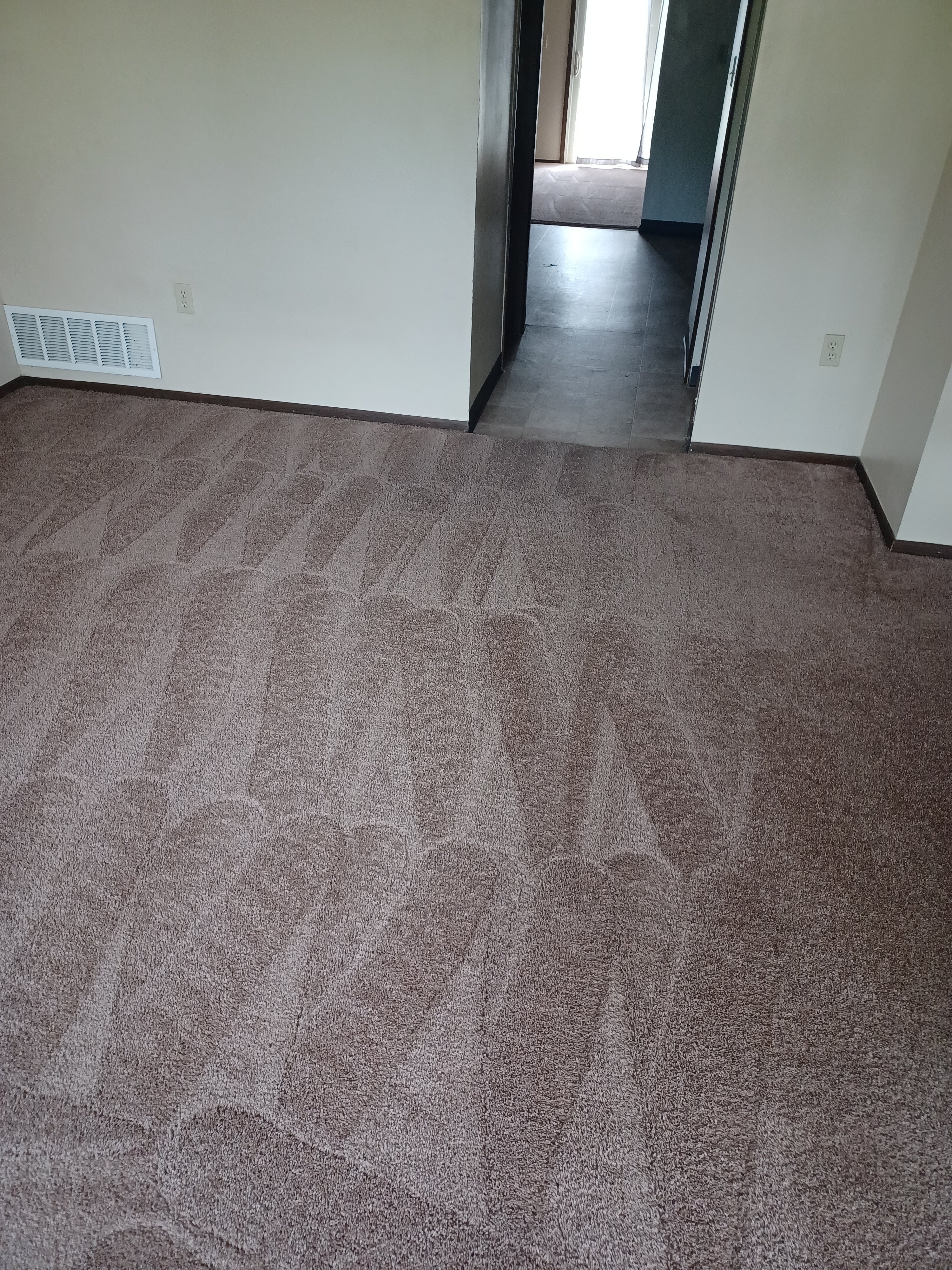

Years ago when it first came out I bought it direct from rotovac and the knock-on it was it used Too Much H2O. But you do not need to hold the valve open you can control how much water you put down and let the tool and agitation do the work.
And I experimented both ways and leaving the marks disguises a little bit the wear pattern
When we ran the RV and 360i I installed a needle valve close to the disconnects so I could control the amount of water I put down. Put a fan on right after cleaning and area and if was touch dry FAST.
