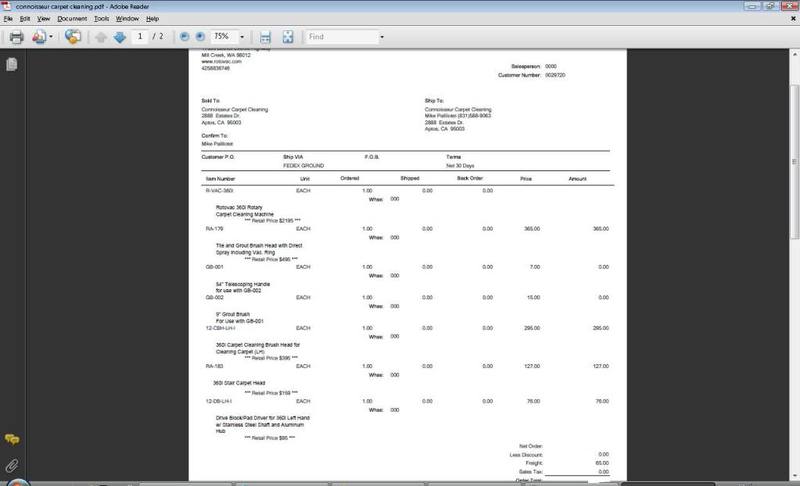

Rotovac 360i and a Zipper Jr are on the way.
116,456
Seeing all the interest here I took the necessary steps to get one of each sent out. Both should be here in a week or less.
I have 30 days to run them through the wringer before I decide if I want pay for them.

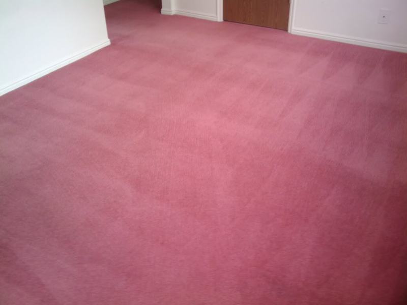

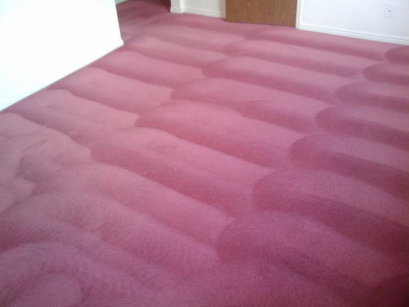

I mainly use the 360 on nasty apartments. I run 300psi. We just spray the whole thing, then start at the top and work our way out without stopping. You definitely need a hose puller for this. Oh yeah, don't plan on fast dry times, and dry passes take way to long with the 360.
lots of swirls, but its an apartment so no biggy. We only raked out swirls for the pic.
