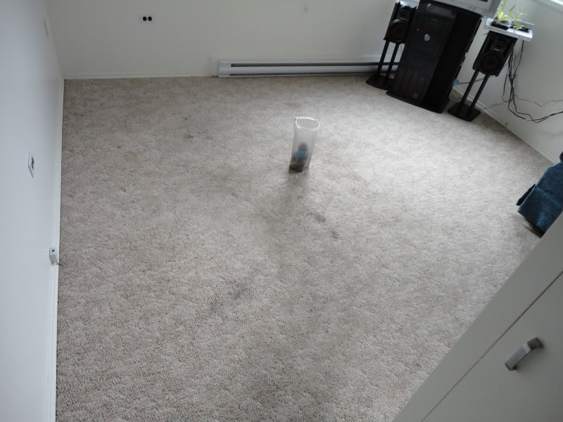

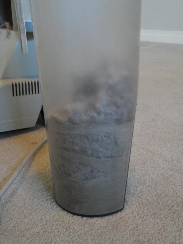

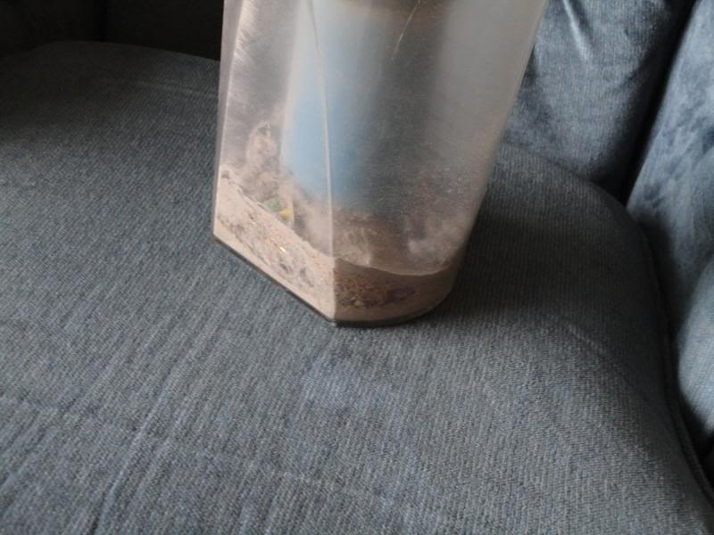

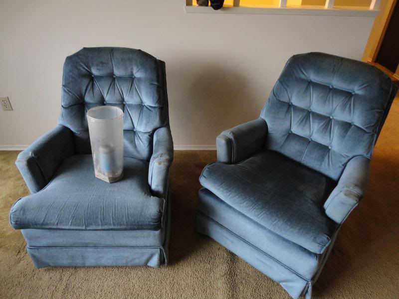

I know exactly what you're trying to tell me. WHat I have a challenge with is how do you know when you are having diminishing returns? By your analogy, its more like a 25cent cleaner will get 2lbs, if that. The 50cent cleaner would get 7, they only "think" they got 17 because they're using some superdooper TM or some skookum mechanized tool. The majority of the soil is removed before it even gets wet. The whole point about using glides was to reduce the wear on carpet as well. Using a bare slot always pulled a lot of carpet fibre.
I prep till I see there is a diminished return. Biggest diff between us is that you'd give up before me. Took some effort to get that soil out of the left chair. I suppose you would have cleaned it with that soil still in the fabric. SInce it only weighs an oz or so I suppose you wouldn't have bothered with it.
Most of the soil that gives cleaners problems doesn't weigh much.
