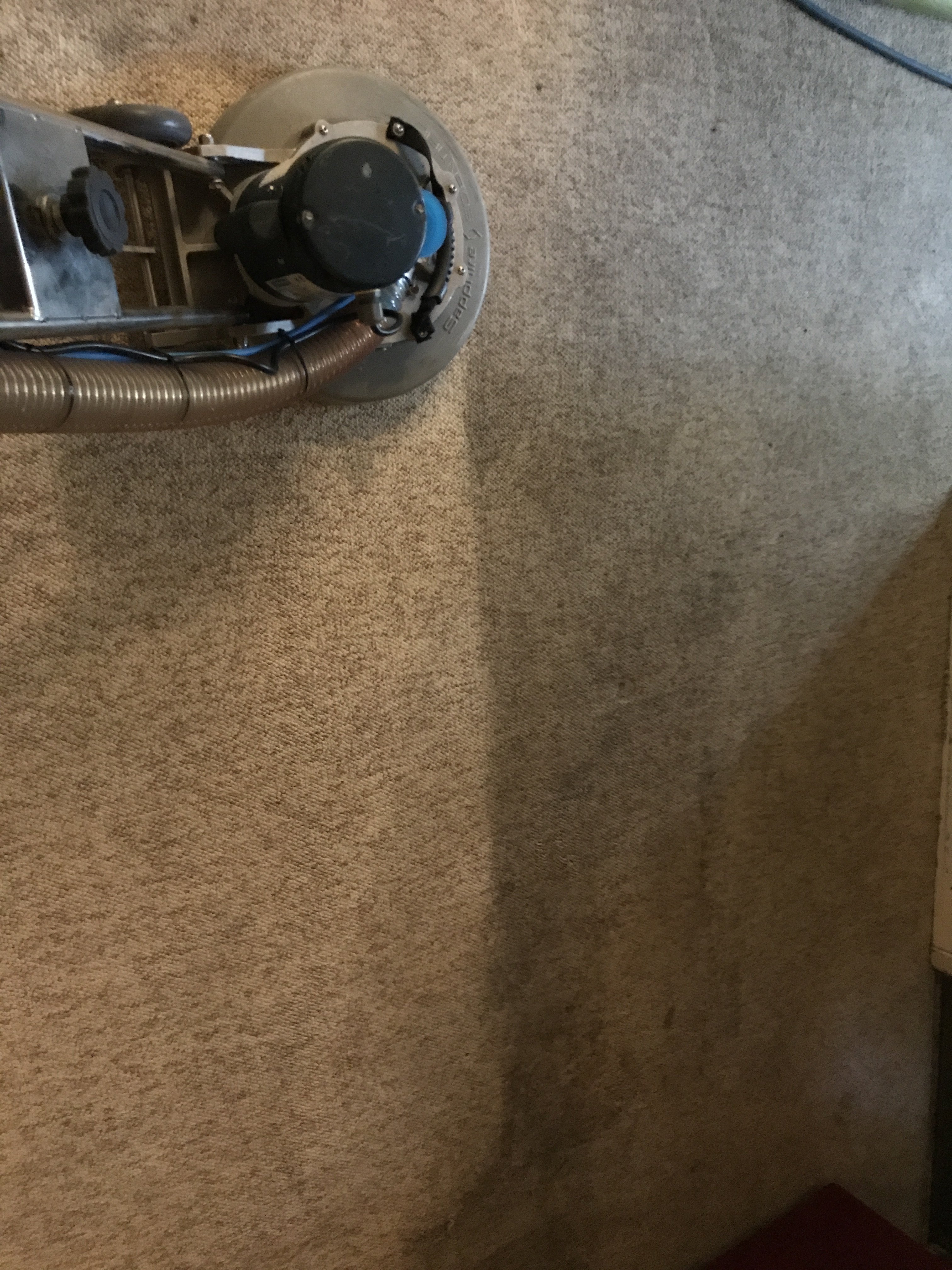

Used my new T-Rex Jr for the first time. My waste tank contained water that I didn't know existed... the RE really does do a great job.
It was poly cut-pile in a home. Seemed like the RE pulled more water on at a slower rpm... does that sound right or am I stupid? 180 rpm was fast but maybe at the expense of longer dry times?
Thanks
Reactions: Matt Middleton
Old Coastie
Jun 29, 2015
7,504
Heart of Dixie
Stephen
Not crazy. You clean at a higher speed, dry suck it at low speed. Alternatively, clean in at high rpm, dry stroke out with a glided wand.
