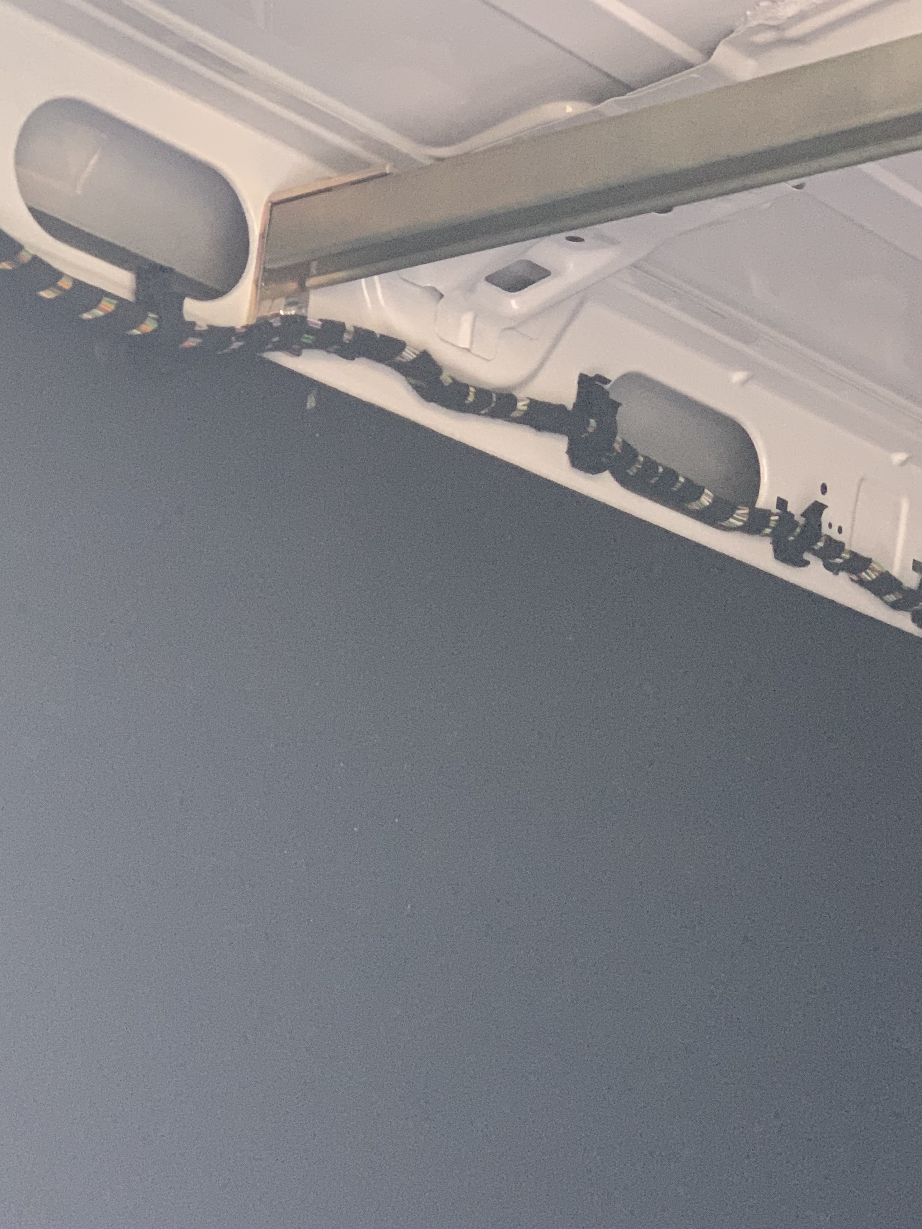

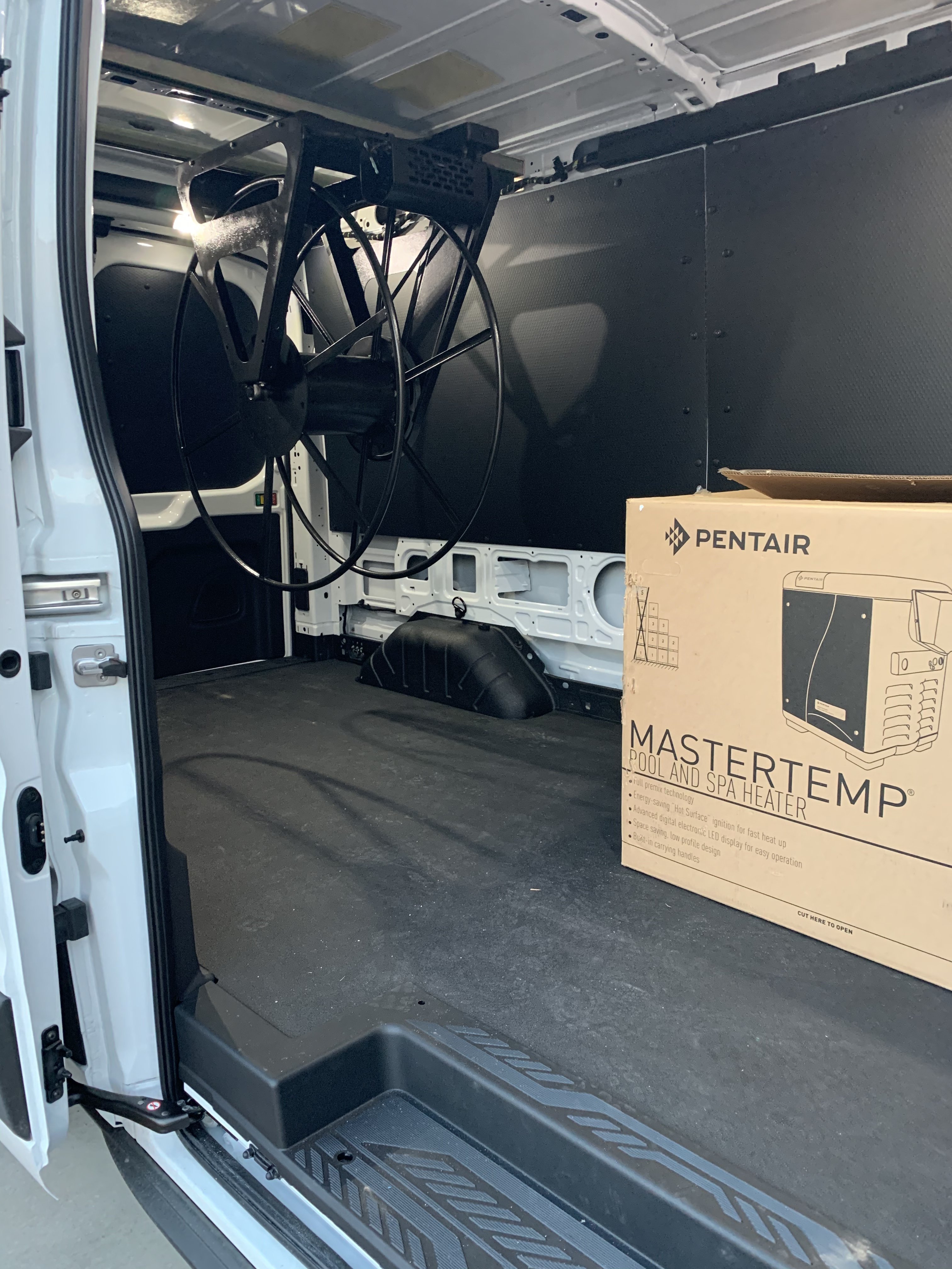

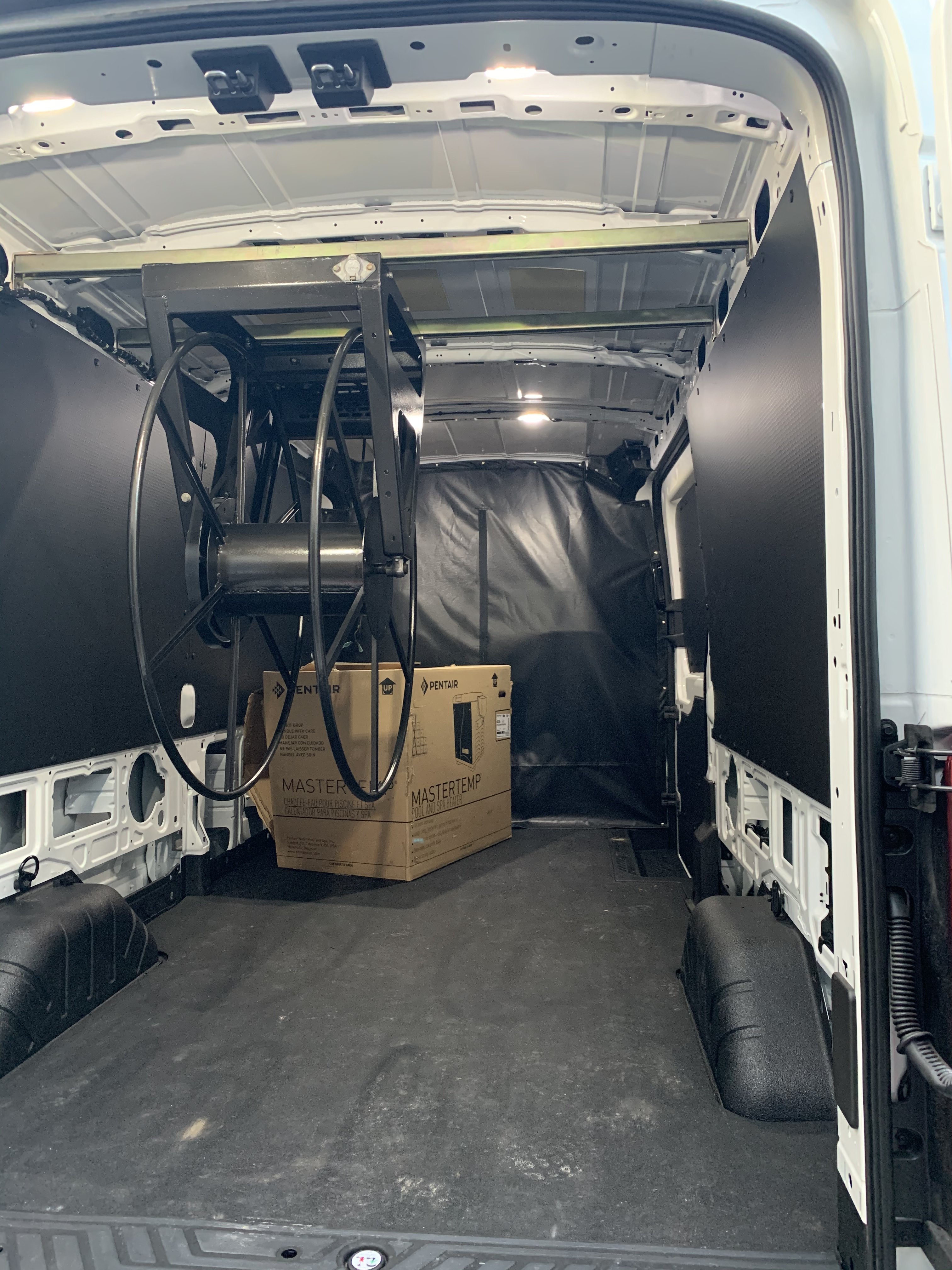

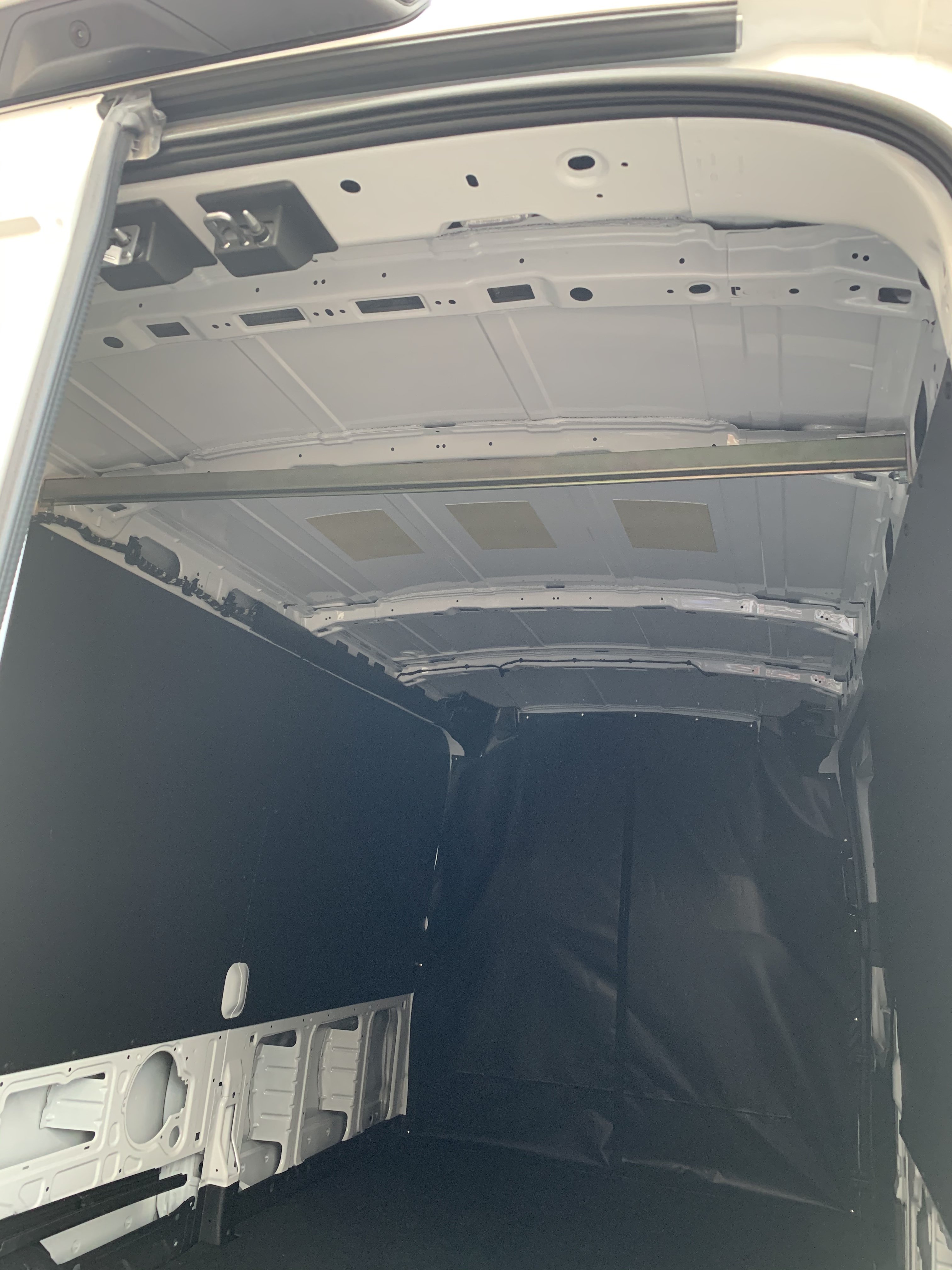

What I think I will go with.

I like that! Is that a medium roof transit? My concern would be that the metal will fatigue over time where the reel braces mount. I was considering the same thing with my set up and decided without additional supports to the floor it will fail.

Yes it’s a medium roof. I might put a brace mount to the floor but not sure yet. Seems sturdy now but we will see once we actually get hose on and start using it.
