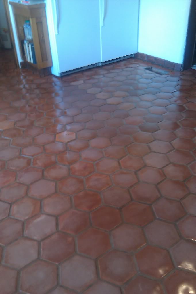

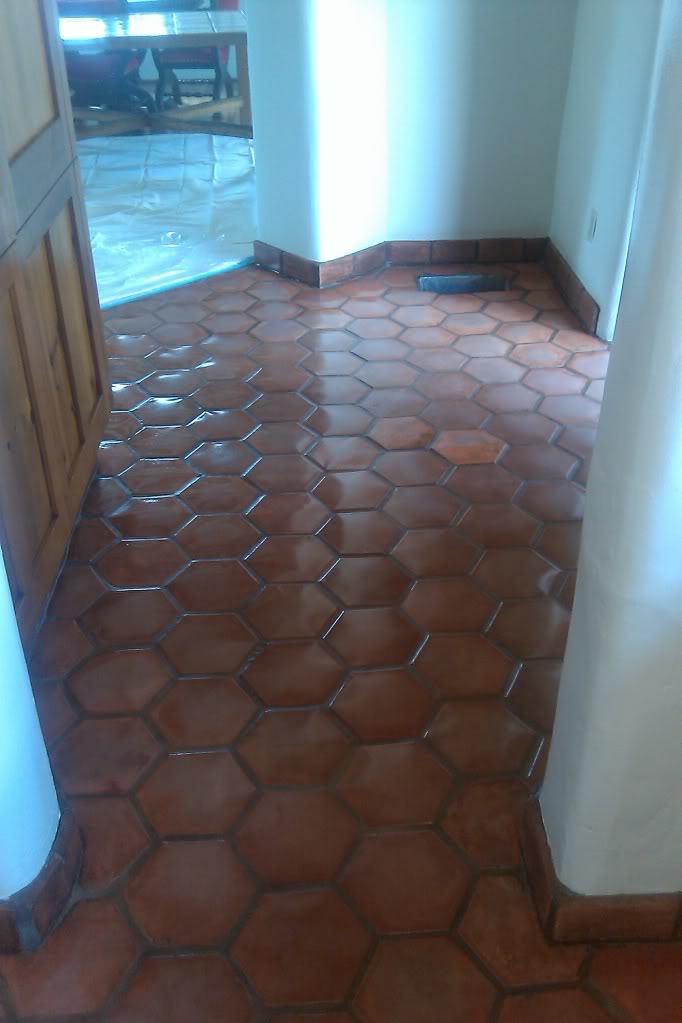

the high gloss is the way its supose to look. If that kinda floors is not finished it will look like crap in fast.
I use ultra chem labs concrete finish. Any stripper will work but i use 707 from well i cant remember the name , i have to wake up.
I have lots of pictures on a facebook page look up You're the boss carpet and tile cleaning. If you need more let me know.
this floor was over 35 yrs old
