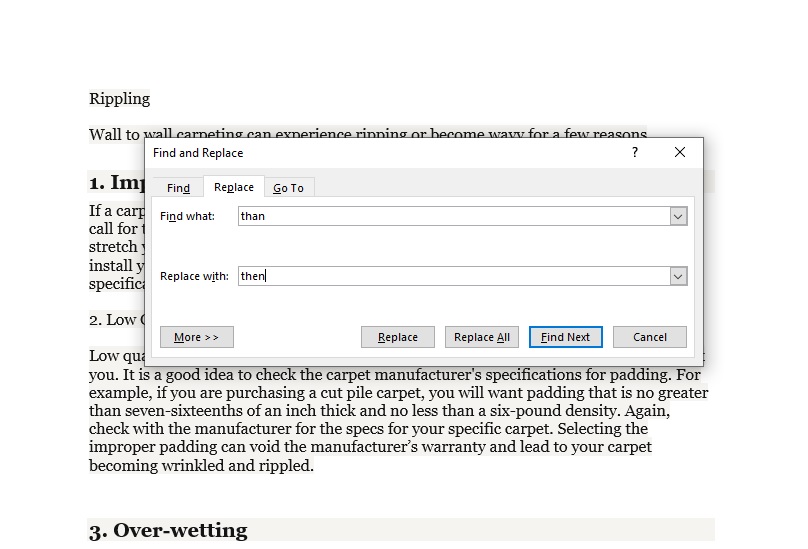

I didn't check this particular document but this should be the first step in reviewing anything @Mikey P writes:

Don't know whether you dictate these and never proof read but this ain't one of your better attempts.
IMHO Avoid the run-on sentences. That last one is a classic bit of gobbledygook,
plus the ones that don't actually go anywhere like the first one in the Improper Installation.
