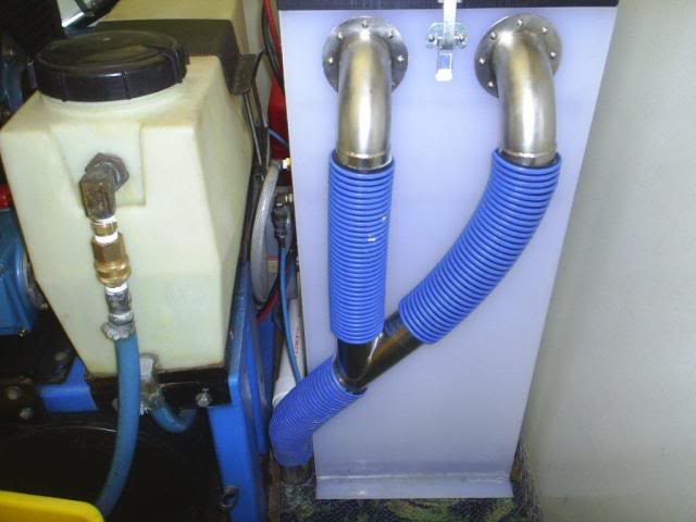

Help me out Harp.
I have had this 2.5 inch hose sitting for two years. I need to get it on the truck.
I need a dual 2.5 inch to 2 inch y and the dual 2.5 inch port for my tank.
Any ideas?

What about the choke point?
Isn't it the same as running 2" with a 1.5 whip hose?
NO.. If your running a 1.5 whip hose, I'll put my Peak against your Everest on dry times... !gotcha!
Sep 7, 2008
3,797
2 inch all the way here. Still isn't it the same concept as having two inch with a 1.5 whip? Even a 3 foot section of 1.5 kills the vac. Wouldn't the 2 inch kill the vac of the 2.5?

Dan,
Look @ the pic above...!!!
You need a 2.5 ss "Y"..
KEEP your Filter Box... :idea:
Then just get some "cool cuff"...reducers for the filter box...2.5..to 2.0...DONE.. 8)
ps You DO REALIZE ....that a standard 2 in. "cuff"...fits right inside of a 2.5 hose... :roll:
if you want to go cHeaP...!!!!! :oops:
Sep 7, 2008
3,797
What I want is two small sections of 2.5 inch hose (enough to lay on the ground from the tank) with 2.5 male cool cuffs.
The picture is hard to get a reference of size.
I just need a way of reducing the two 2.5 inch hoses with male cool cuffs down to one 2 inch hose. I guess I will need two custom y's.
One will be dual 2.5 inch to 2 inch and the other dual 2.5 inch to single 2.5 inch.
I gues I could go to a muffler shop, get the pipe, and have somone weld it together.
