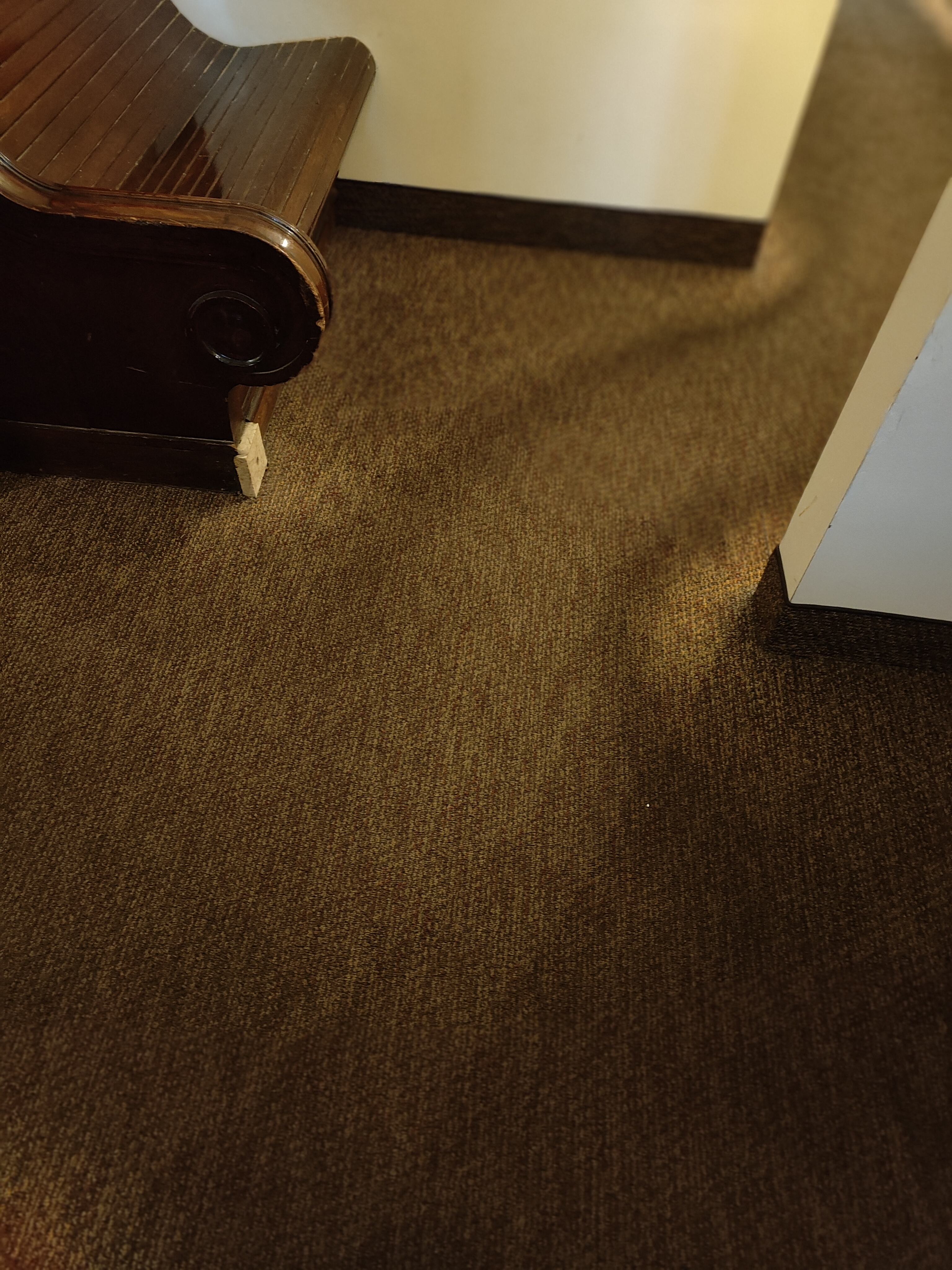

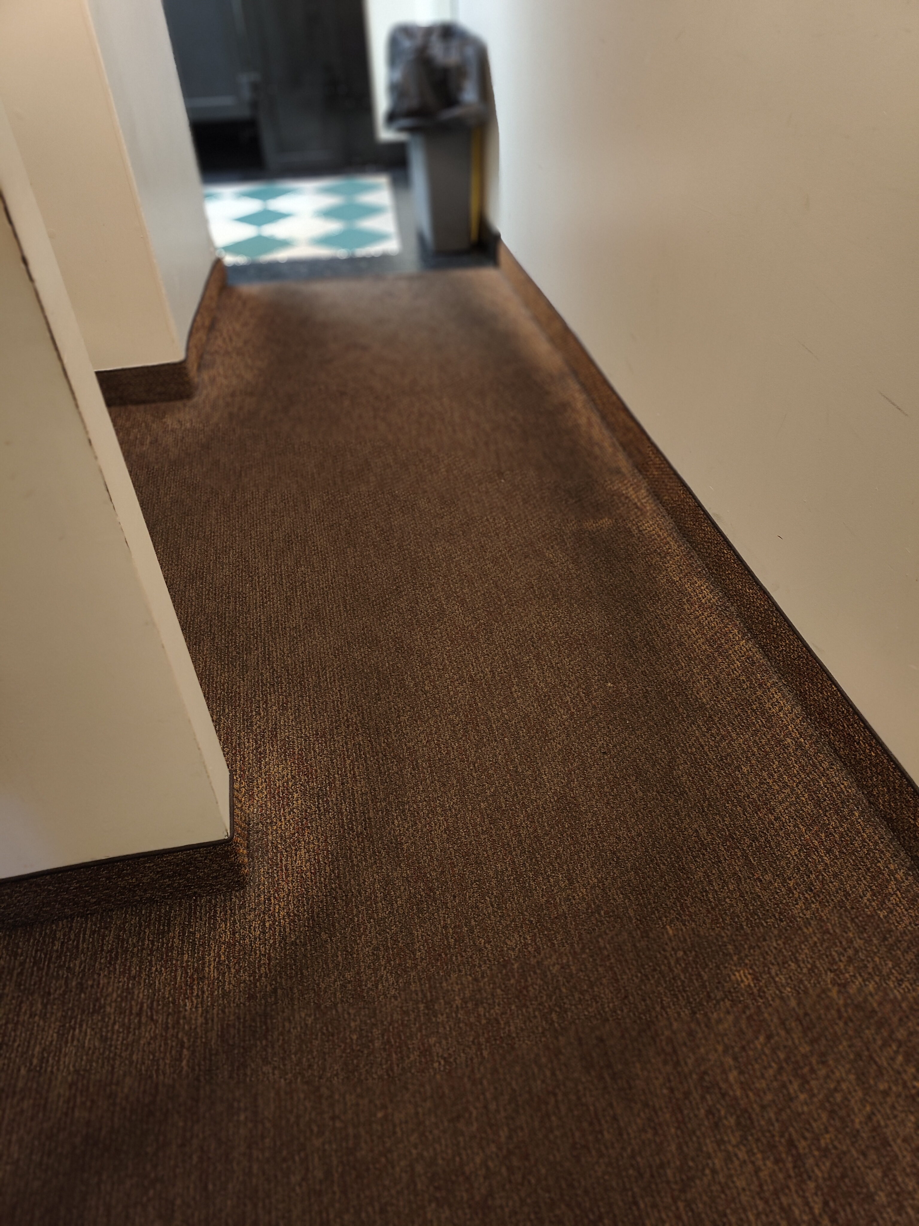

I've been doing this carpet for year's, sad part is that they always wait way to long between cleanings.
This carpet was installed during the height of COVID. It's in a brewery/restaurant. The last time I did the restaurant part of this place I posted questions, I thought Cimexing would work, didn't really budge it. I tried cranking up the prespray and pressure. I had a little movement or luck, but it would have taken tons of time and water.
What worked was a 175 machine scrubbing at the same time we were applying prespray (enzyme, not regular prespray). We were using a lot, had to soak the area while scrubbing. Then extracted with the zipper wand.
I need to go at it again and I don't want to bust my ass.
Here is a pic of a walkway into the restroom. The pics don't truly show the extent of it.
I was thinking maybe using the Cimex with more aggressive pads and put the prespray in the tank. I have to find the pads.
Suggestions please,
Suggestions please,
View attachment 125382 View attachment 125383
