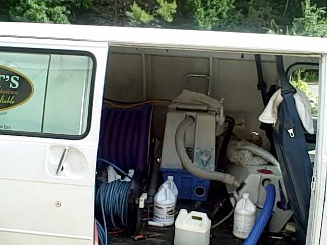

As a black man I'd like you to clue me in on how this ***** rigged up POS could have any lift at all after those three lamb vacs get spent filling not one, but two waste tanks AND running 100+ feet of two in hose to the back bed room.
Good lord.

The machine is comprised of flaw after flaw and is in no way in a position to support the horseshit claims that its cult members continue to boast about.
That setup pictured above is comical and I am certain that the machine is regurgitating more than it is extracting.

I have a modified Ice cream Cart LOL Recoil. I have 2 118 cfm 153" cobb motors in the main stacks and a M-5 motor in the rear. This has about 40 % power than stock and can run 150 no problem at all. after 3 rooms I have dump tank . I also have another m-5 motor that hooks up to my exhaust .
I have tried every set up 2 par and 1 series this is good for 75 feet
I have tried 2 par 2 series this was the strongest and my tank was not strong enough
I just purchased a used mytee that will have 2 lmb2a in a week and I will run a y on this w/ recoil , just for joking measures of a projected 581 cfm more like 520 cfm
