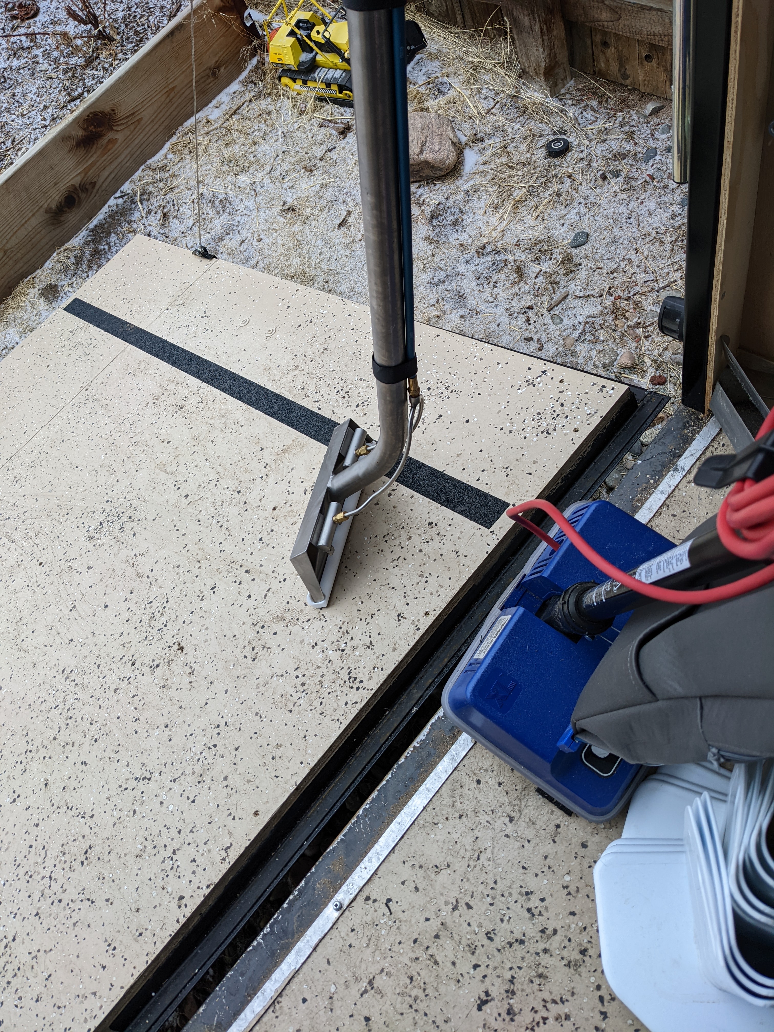

He should post a picture
but didn't we do this before and you said it was some other that they sold
Looks like a PMF 802 with both on glide.

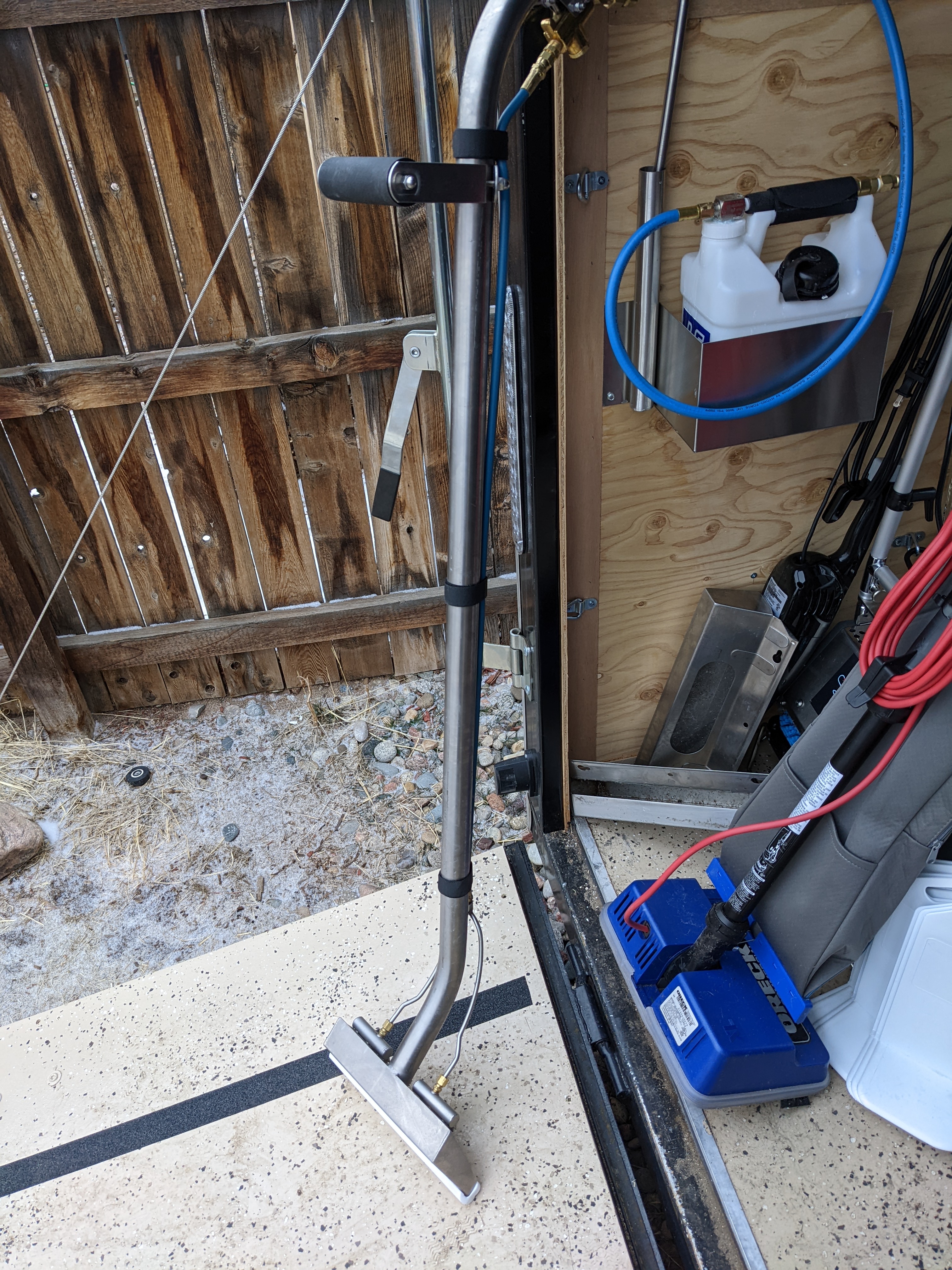

Post a picture
Reactions: FB19087
116,004
In reference to the two jet glide that Fred posted, a picture of that is no longer made , you'll need to get new metal lips (ac33-802) and the GG carpet glide
