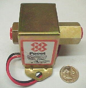

Maybe they never put a fuel pump on your machine. I had that happen with my 1st TM..
The pump will be about the 1.5"x3 inches. hose going in, hose coming out. 2 wires.
It will be on the outside of the tank.
B
Becker
This is what you are looking for.

Jerry , I am guessing you have an acs machine . If you do the fuel pump is most likely square . Located on the blue rail by the fuel filter . when purchasing a new one get a fuel pump universal psi 1 to 4 pounds. Do not get the one 5 to 9 pounds. Aslo check your wiring , or see if the feul hose got caught under something. if it is not an acs , still use the same advice.

arghhhh!!! they sold you the wrong pump!!
The valve cover mounted Kohler pump is fine for power equipment, but wimpy for pulling gas up from the van's fuel tank instead of pushing from below like most TM's need. It will perform poorly with long fuel lines and vapor-lock prone hot weather conditions.
I promise just about every AutoZone, Advance Auto, Oreilly's, NAPA, Pep Boys, or local parts supplier has the pump pictured earlier in this thread....for about $40.

Get a pump Like I showed you in the pic..
As I recall if the van is fuel injected you need an electric fuel pump.
I had a Kohler 25hp.. The goofy guys installed it without a fuel pump. That lasted about a week.
