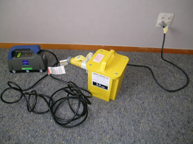

Shorty, my first unit which happened to be one of the first in the region, came with this baby!!
And no, you couldn't ask Delia to carry it for you :oops:
This was bought about 12-18 months ago. I can't really remember sorry. The Transformer here, is a UK one and has the UK heavy sockets with two outlets. 3.3kva (?) is what's on the side.
The new unit I bought a week or two back, came with a much smaller transformer. about 6"x6"x4" and easily carried by anyone. SMall enough to fit inside a toolbox with the Kool Glide and a roll of tape and a few other tools. But it can only power the one unit.

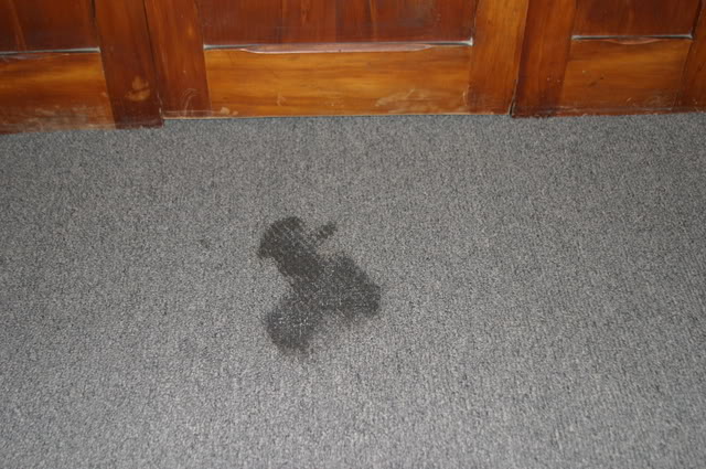

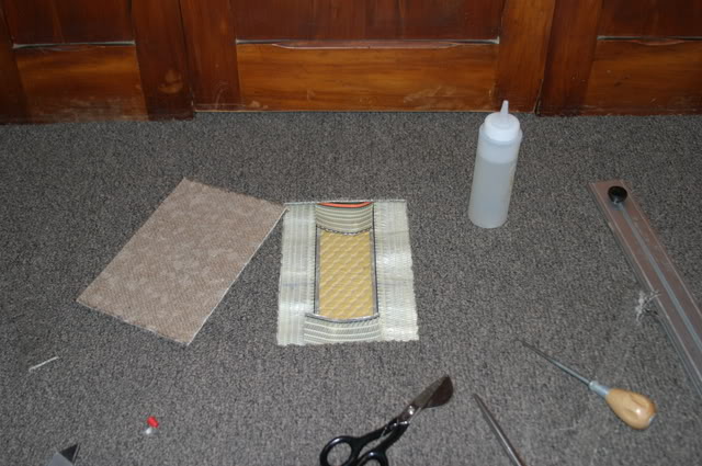

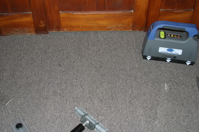

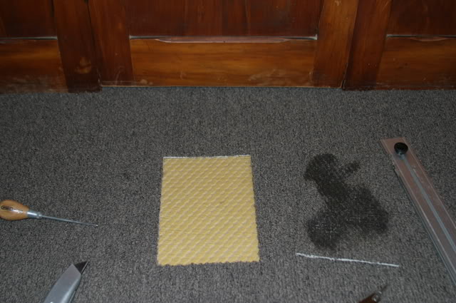

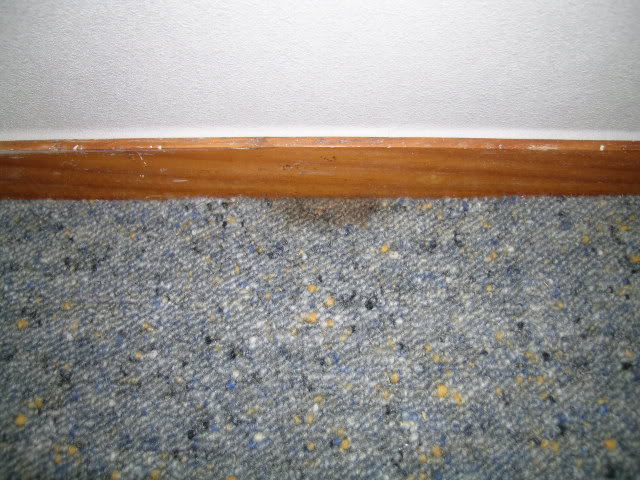

Here's another one I did for a rental last year.
An orange was left to rot under a bed. They shifted out and the stain wouldn't budge.
Client thought her replacement cover policy would have given her brand new carpet. It was only 1-2 years old anyway, but she was wanting to sell her rental and wanted it as new as possible.
The adjuster called me and and up till I did the work, she thought she was getting new carpet until she couldn't find the spot 8)
