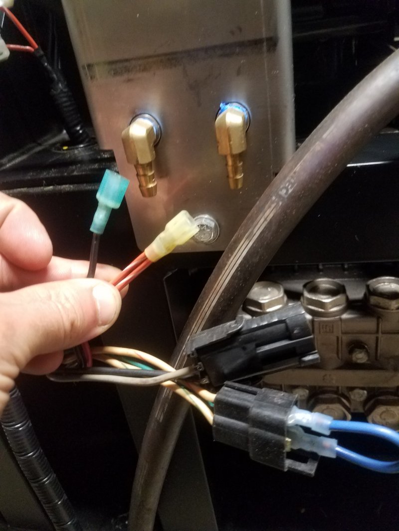

There is probably a hole drilled in the floor where the fuel line comes through. From there it should go to a fuel pump. I would take the clamps loose at the fuel pump. You may have to cut the line to get it off then put a plug in the line until you're done.

Remember to take the two little hoses off your waste tank also.. And disconnect your waste tank float sensor.
