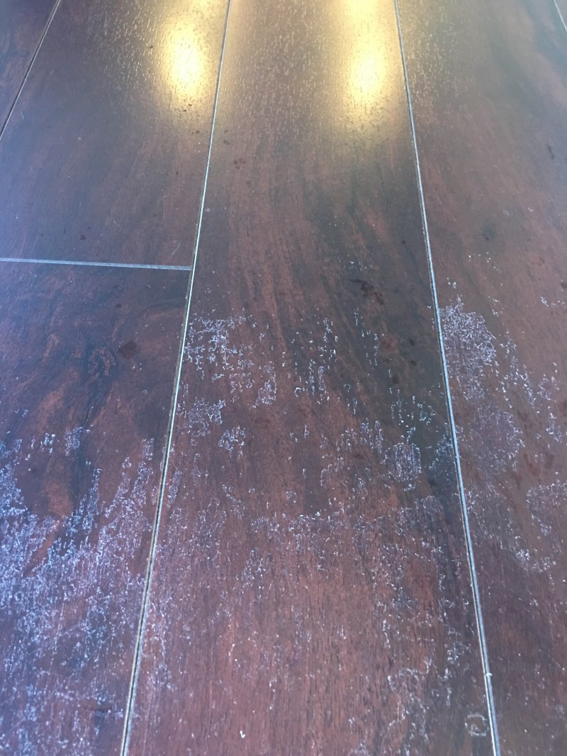

I've got a scheduled project with 5k' of engineered distressed hickory fused hardwood, with UV cured metal linked urethane coating. Exotic, beautiful floor!
However, someone used Mop-n-glo or such on it.

Job was a 2hr drive from me so I found a box with spare planks and asked to take one for research, as well as contacting Armstrong.
This lodge sits in the middle of 5500 wooded acres, unique for KY.
It's not a job to screw up.
