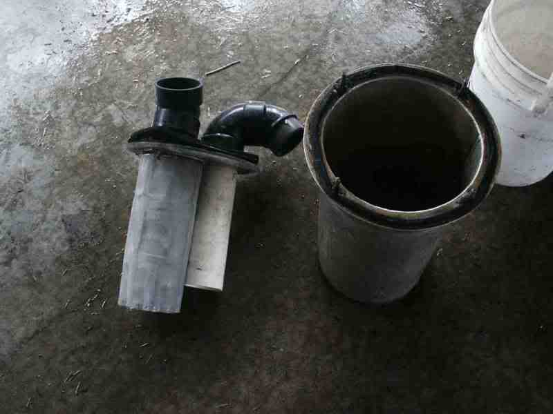

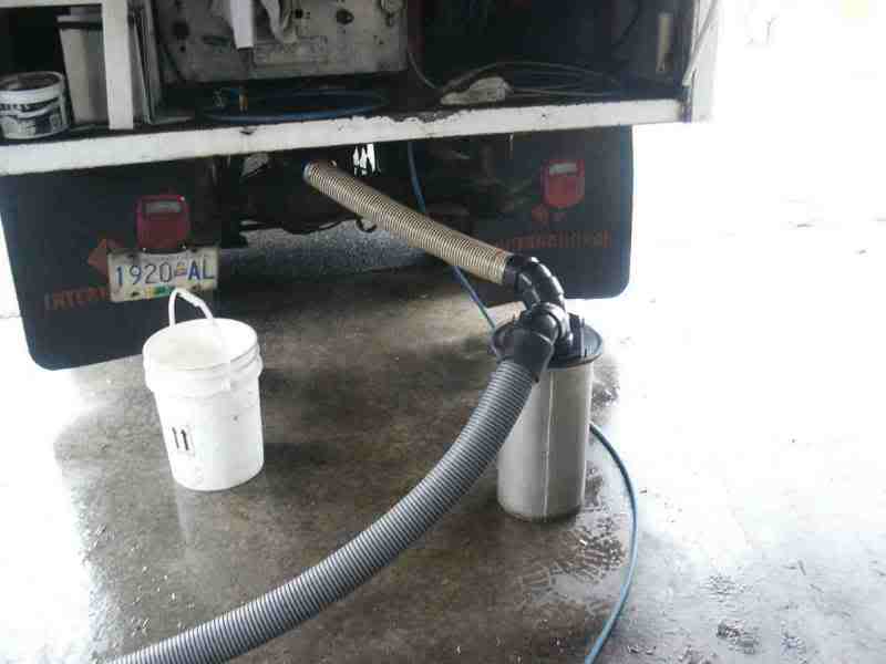

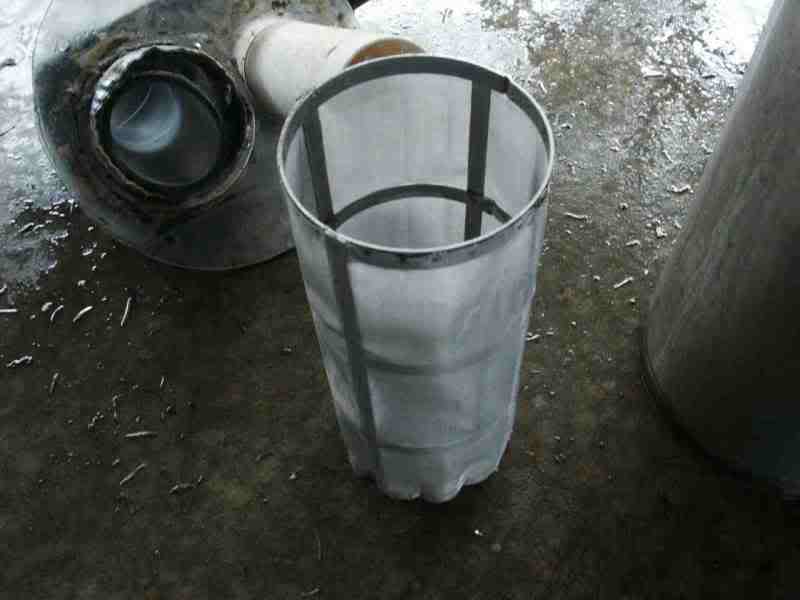

Here's my solution, cost about 250CDN, the pail is aluminum, the screen is 1/4mm holed stainless. Nothin gets through. Its plumbed with 3" abs and one piece of 3" pvc. The truck is plumbed 3" right to the tank. There is no restriction in airflow until the stuff starts collecting on it, quickly rinsed off and go at it again.
In Victoria we are "required" by the local gov't to filter our recovered water by this size screen before dumping into the septic sewer system, which then goes straight to deep ocean. Gov'ts, go figure!
