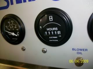

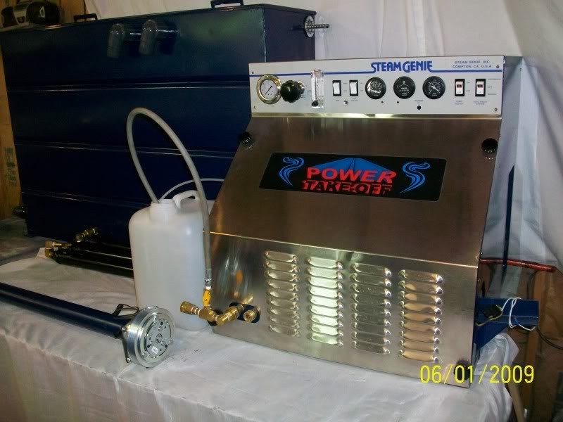

I thought I'd post pictures here to show the degree we go to when doing a reconditioned system. Note:
  • * New gauges
    * New plumbing
    * New belts
    * New Idler and Idler adjuster
    * Refinished face plates
    * New wiring
    * New exhaust and muffler
...In addition to new paint.
The pictures speak for themselves, I think. (And, "Yes", this is typical of the extent we go to on a refurb.)
This "Hammer" system (designed by me, originally built in 1998) was delivered yesterday. Originally they were built with Briggs Vanguard 18's. This one had a Kohler 18 from a Prochem (I know, the breather cover says it's a 25...) we tore down and parted out.
In the demonstration for the customer, it delivered 250 degrees of constant heat, with the trigger held open continuously, at 600 PSI, through a wand with (2) #3 jets, at the end of 150 feet of hose... measured at the wand.... for a 15 minute period. (Of course, that temperature is fully- adjustable from ambient to maximum.)
It sold for $4,500, plus installation and included a 90- day warranty, as all refurbs do.

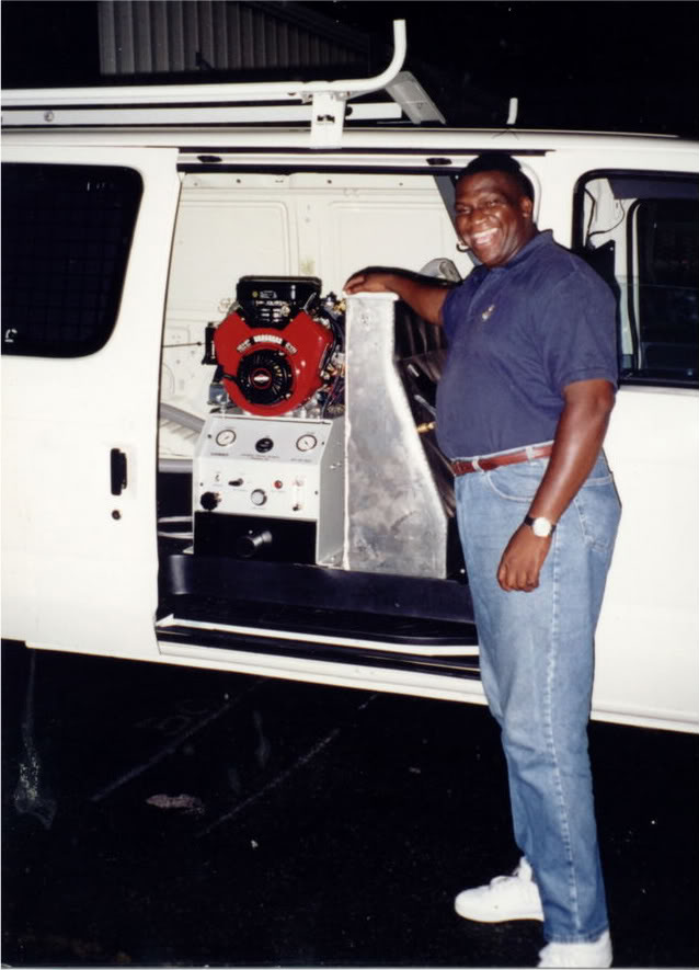

Oh...

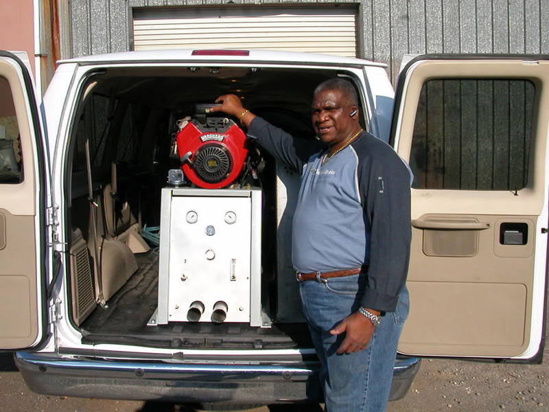

And here's the proud original owner of that 1998 Hammer then...
And now, with the new version of it...
What a difference 11 years makes... 8)

Duane:
I could swear I've met that dude before. Is that possible?
Nice looking machine you rebuilt there. Great heat, too. I just hate seeing so many 36 blowers.

Thanks, Mardy.
You may have met Billy before. And you likely will at the Gathering here Aug. 28-30
Hammers with a 36 on them routinely cleaned at 400 feet from the truck Admiral-ably 8) One owner cleaned at 550 feet routinely. That says a lot for the vacuum ability of a 36.

Actually Billy has gotten a lil' bigger over the years. But I think he's about to lose some. He just retired from his "day job" and is going full- time as a cleaner now. (Full time for him means doing jobs he wants to, for fun. He doesn't need to work for the income.)
The system is a bit more spread out, or rather, "up". That makes it super- easy to work on. I revised that frame design on the next ones to be 2" shorter in height, though. It was a bit taller than it needed to be.
The original Hammer systems were 16.5" wide. These new frames are 21", which allows two mufflers to be in parallel and sit inside the frame nicely, as well as allow the Cat to be located where it is and have room to move back and forth to adjust the belt tension AND be easy to work on.
These frames can handle 33, 36, 45 and 47 blowers. The 47 version has 2 "B" belts as the drive system between blower and engine.

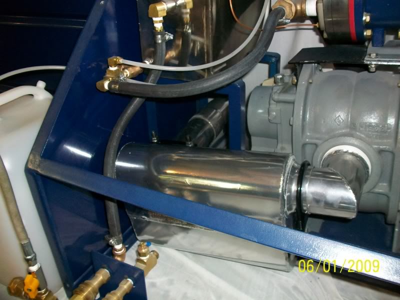

The blower exhaust. Does it do a U turn? Why not straight down and then T into the mufflers?
Ron:
Yes, it does. It does so, to allow more length for longer mufflers. The system in the picture used two "Thrush" mufflers. I did that in order to see how well they would do, compared to the ones I normally use. The Thrush ones are considerably shorter, but I had the system ready to change over to the longer ones, "just in case". In truth, that particular system was louder than I wanted. But it wasn't outrageous. But setting it up the way I did, I had the option of swapping them out easily, if desired.
The blower exhaust tube, by the way, is 3" square tube. Except for the inlet itself (which uses a 45- degree deflector plate internally) it has no hard 90- degree turns, but uses (2) 45's instead, making it more like a "sweep", where it turns, except where it spits into the "Tee" and both sides of the Tee are also 3" square, with 2.5" tubes for the mufflers (which are ported at 2.5" each, in and out) to attach to.

"Bob, your blower elbow looks a little restrictive. Nice weld, but too sharp."
you'll havta blame Steam Genie R & D....that's EXACTLY how they built them....and no it poses NO restriction at all......it's Stainless and required a TIG weld!

If I put one together from scratch, I'd be using all the latest tweaks we've learned, copying the good things I've seen on the Big Red and the CanAm, and other machines.
No 90's unless 3" min and sweeping, keep the air moving with minimum restrictions.
Every machine will have something that could have been tweaked, in hindsight.

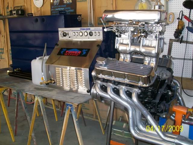

More stuff...
We bought several systems from a local multi- truck company recently. They're all of the same basic design- direct- coupled ("DC"), Sutorbilt 3M's, with the pump on top of the blower- very simple systems. There are some design ideas I don't particularly care for in them, for instance the fact that the exhaust from the blower is hard- plumbed to the mufflers via muffler pipe, so that to get the blowers off, you have to saw through the blower exhaust. (It also makes lining up the systems a pain to do.) But we'll be changing that in them as we go through them.
(I see doing projects like this as worthwhile, because it forces me to look at things differently than normal and remain open to new ideas. For instance, we recently re-did a Timbuktu system. There were some interesting design philosophies present in their systems, but I learned about a kind of flex- pipe I wasn't previously familiar with, that remains flexible even after hundreds of hours of service at engine exhaust temperatures. It's basically, "permanent" and can be welded easily. So I tracked it down and we now use it on our systems.)
One of the things I did on these systems was install a way to level the blower in relation to the motor more easily... something that is a carry- over from the DC systems we build new.
At any rate, here are some "before" and "during" pictures for you. These systems start out pretty rough, all in all. And we strip them of all rust, then seal and prime them, then paint them, before continuing onward. They'll have new Kohler 18's when we're done with them and will sell for $4,500, plus installation, with a Little Giant #3 and accessories (reels, wand, hoses, etc.), when completed.
