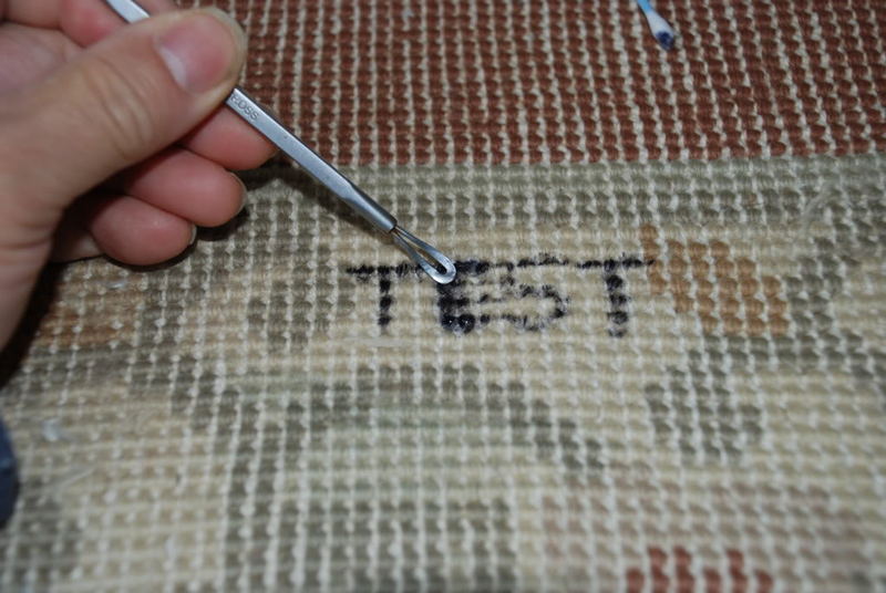

#1. A “Sharpie Permanent Marker Stain Test” on a Chinese Wool Rug.

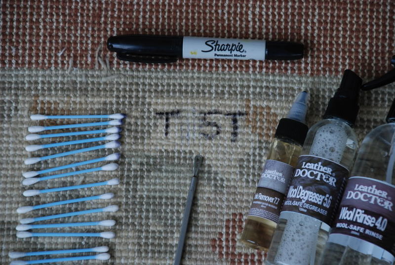

#2. Application of an odorless, water-based pH 7.7 Ink Stain Removal.

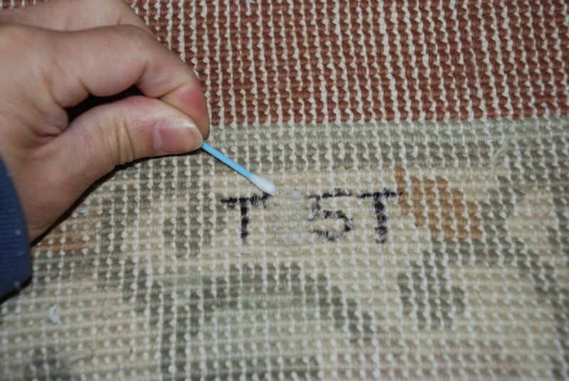

#3. Agitating the stain with a spatula.

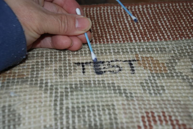

#4. Extracting the suspended stain with cotton swab.

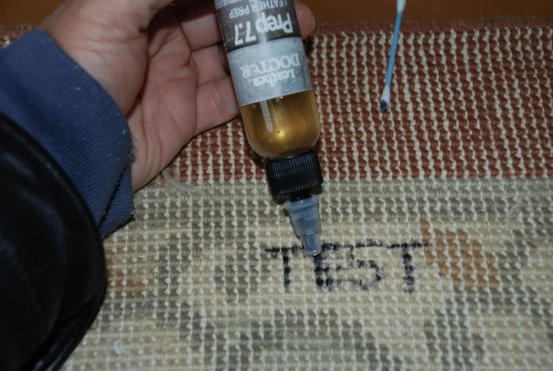

#5. Remove sticky residue with a pH 5.6 Wool Degreaser follows by a pH 4.0 Wool Rinse.

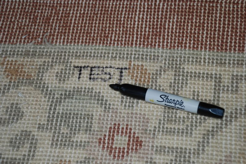

#6. The tools of the trade!
