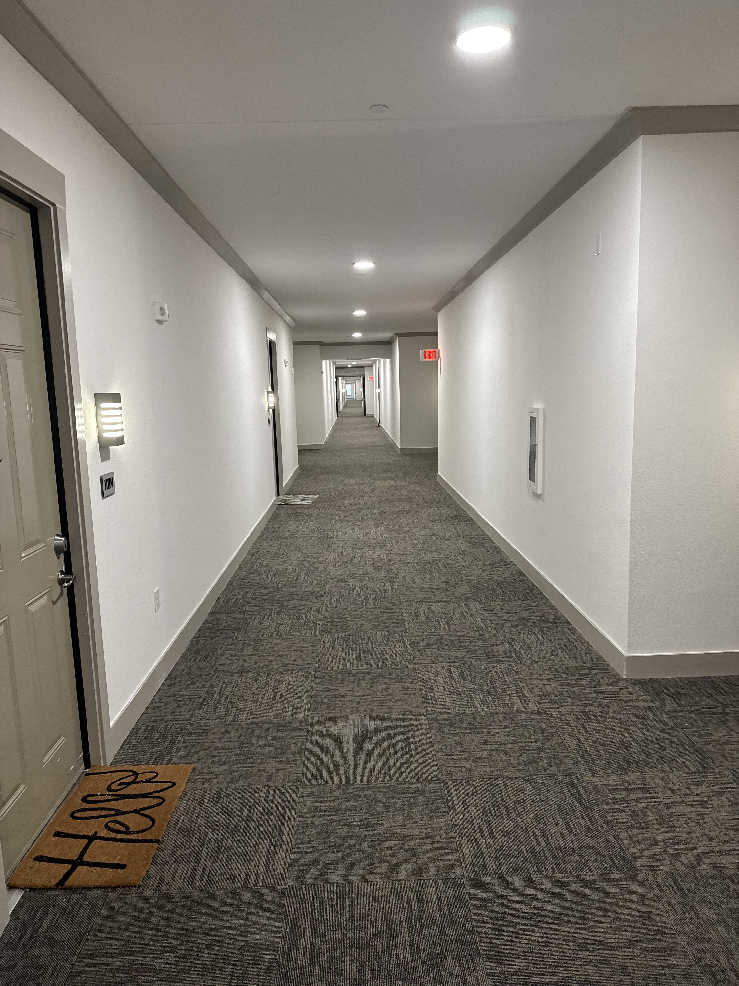

I have a chance to get a few large VLM jobs. Having done HWE on medium sized commercial jobs has worked so far but will not work for this property. Walked one of them today and its not possible to use my truck mount. Ive read pretty good reviews here about the Orbot Vibe and I may be able to pick up a used one locally for decent price. A few questions. Still a good enough machine? How many sq ft per hour should I expect to be able to clean? No offices or stuff to move. Mainly hallways and open rooms. Light to medium soil level. How many pads should I expect to use per 8 hr day? What pad should I be looking at getting? I never expected to go to the dark side, yet here I am. The money would be very hard to pass up on this.

You should easily be able to do 2000 sqft per hour. I would use microfiber pads. I prefer an oxy encap for most of my work but bring a solvent based spotter for greasy spots. Conversely, you could use a high pH encap and bring an oxy spotter for coffee or beverage stains.

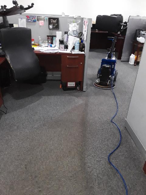

If it's all in that condition...
You can buy these from me or Rick but Direct Mop Sales is the imposter..
500 sf per side on that floor.
19"
If there are worse areas you'll want to pre scrub it when a brown 3M Fiber Pad, use the microfiber than follow up with a Glad Pad, which is a cotton blend that absorbs that gunk that the MF won't...

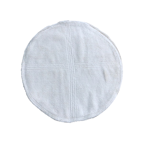

I would start with the 19 inch microfiber pads. On light to medium soil, you can get 400-700 sqft. You can use both sides of the pads when new or newish. Once they get too floppy from repeated use and washing, I usually only use 1 side.
