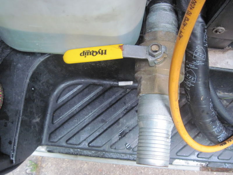

Keith
I haven't had a problem with mine... WAY easier to open then the pos pvc ones. I think I payed around 100 for it..
MerCrewser
Jan 23, 2007
304
got one, $31 at Lowes for 1.5 inch which is the size of the pvc on it now. No room to put pvc or buffer between, not even enough for a hose barb unless using a gate valve. My 12 yr old tank is in great condition, always has a few inches of waste water in it because pvc vavle is such a pain to use. I always run the pump out.
